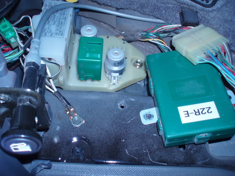

Pictures of relays under kick panel:
Originally Posted by speedracer365
check the relay in the cab by the fuse box. mine went out when coming back from college.
Originally Posted by Johannes
If the relay is what I'm thinking it is, they're sold in many autoparts stores, and vehicles of all makes and models use these standard relays for lights, etc. etc.
I had to replace a 5 prong one for my Jeep CJ5 to make the offroad lights work, as well as the horn.
They're a square black box looking thing usually, maybe 2 inches in width, 2.5 in height, but that's working from memory.
OK i found the three prong relay... it looks good but i ordered one from napa anyway.
I will update the thread if it works.
Which one?
