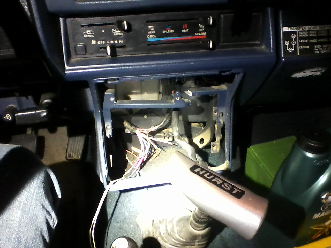

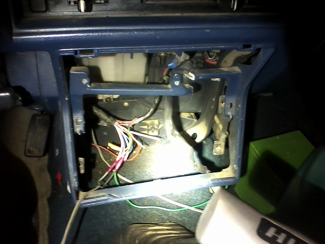

Hey guys, I've done some research in order to replace the radio bezel and the panel under that on my "86 pu, since I'm getting tired of the Bluetooth speaker sitting on my dash. As you can see in the picture, the big plastic piece under it is broken, and the bezel is missing and the wiring is a mess but that's a bridge I'll cross when I come to it. I don't want to spend 40 bucks on a new bezel on ebay or parts sites and there aren't any in my area. any alternative radio mounting ideas? Thanks guys

I say just stick a radio in there and wire it up. If you want some new trim, hit up a local junk yard. There are a dozen similar models with the same trim as yours. I went to a good local yard when I needed radio bracts for mine and the girl up front told me there were none to be had. I knew the owner and when he got there, we rode around for five minutes and found over 20 trucks with that same setup. I got the radio, brackets, trim and all for $20.

The broke section is the ashtray divider, not really needed. Radio dimensions are standardized any one or two din will mount up in there, worst case you can use hardware store "ground strap" and bridge the gap between the screw holes while you're waiting for something to become available..
