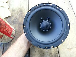

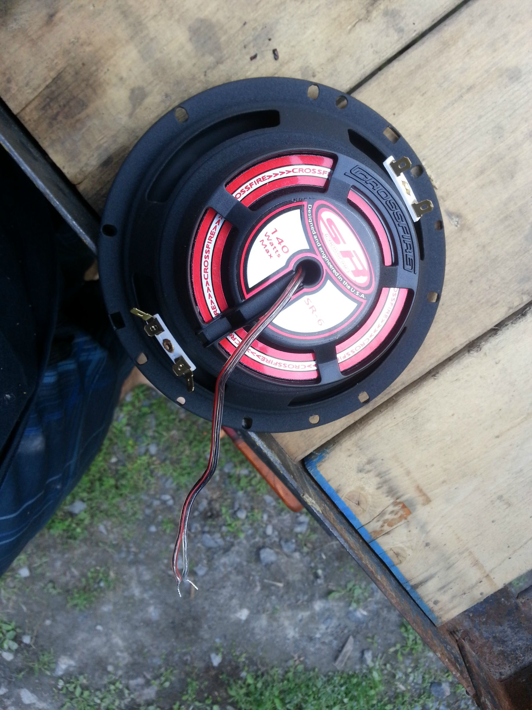

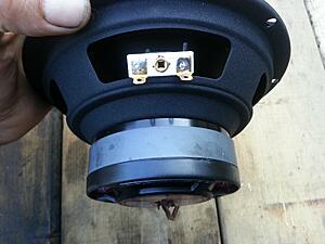

So a long time ago I was given a good sound system with crossovers, equalizer ect. and I decided to install it in my truck, the problem is I don't have the manual.
I decided to install only the front speakers. I have everything figured out as far as the head unit plug and which wire goes to the speakers, ignition, battery and ground. The problem is I have 6 spade connectors and two wires on my speakers, where do they all go or plug to?
And how do you wire the crossover, is it necessary?
It has 6 ''ports''
IN +-
MID +-
HIGH +-
I don't have an amplifier or a subwoofer, maybe it is intergrated in the speakers like the tweeters?
Right now the head unit works and the speakers are connected to it by the two wires coming out of them but nothing works.
Thanks fo the help!

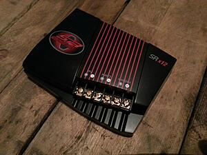

This is one of my cross over, I have 2.
Also this might be really newb question, but since my head unit is 50wx4 and my speakers 140 watts, and I only plan to use 2 speakers, can I connect my front AND rear speaker wires together to the front speakers for any improvement?

For starters, don't connect the front and rear channels from the head unit together. Use only the front channels if you're only installing the two speakers. You use one passive crossover per speaker. They can be placed wherever you want. The channel from the head unit connects to the "in" on the crossover. "High" connects to the tweeter(the wire coming out from the center). "Mid" connects to the spade terminals. Use the spade terminals that are connected to the tinsel leads( the one with only 2 connectors). From the pics I don't think the connector with 4 spade terminals is connected to anything. I assume they intend you to wire the tweeter to two of the terminals and then use spade connectors to connect to the crossover. Basically reducing any accidental tension on the tweeter wire.
If any of this doesnt make sense then let me know. It's been a long day.

Wow that's great it answers all my questions! Thanks a lot!
