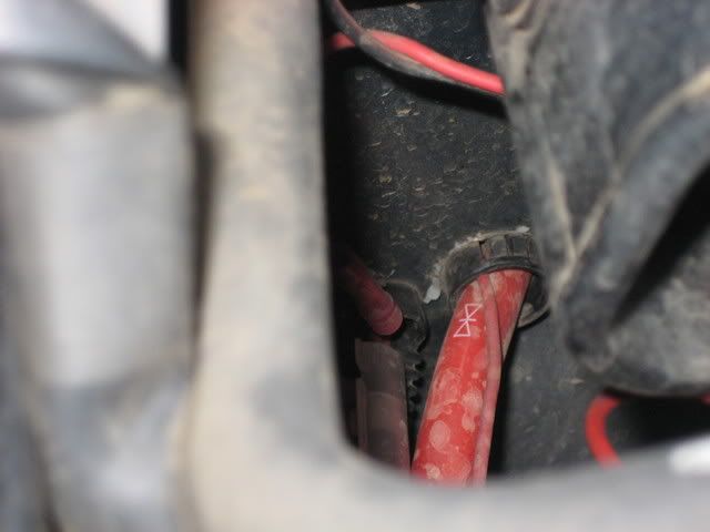

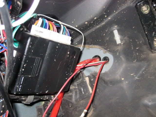

Hey ya'll I got a 3rd gen 4Runner and I'm gonna run some 4 ga. power wire for my amps. What is the best place to drill into the firewall for this?

look around you should find one thats not used heres what my freind did he had a 99
http://i140.photobucket.com/albums/r...0/DSC01345.jpg
You shouldn't have to drill into the firewall..here's what I did and I'm runnin the same size wire!!
And this is inside under the right side of the dash
