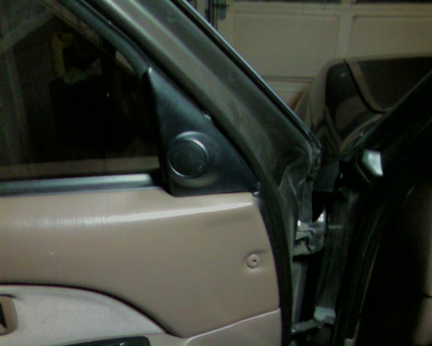

99.9% of the time crutchfiled is right, this time they might not be, i am going off a third gen 4runner but in the front doors it took 6.5" and in the rears it took 5.25" with an adaptor. the difference between the reference and the kappa is the power handling, and i believe the surround material as well as the crossover and tweeter. the 3rd gen runners came with a factory tweeter in the forwardmost corners of the door frames. if you can find one they look much nicer. i will try and get some pics of mine to give you an idea. im pretty sure that any 96-99? 4runner tweeter pods should fit the same in your truck.

here is a picture of the factory tweeter pod on my 97 runner. sorry about the quality, its from my phone
