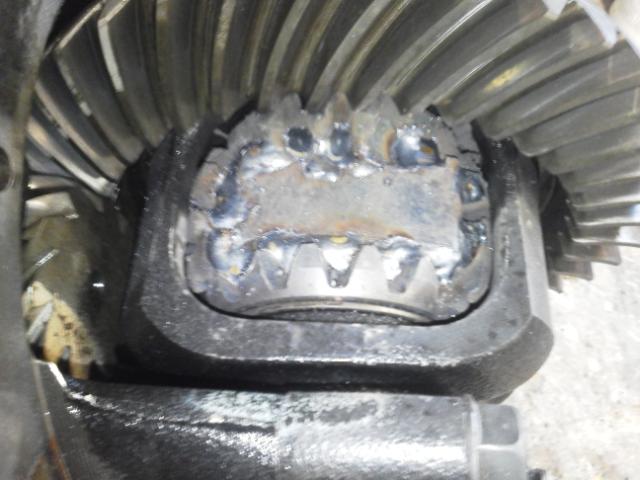

Do it!!! make a small plate and melt it on one side of the gears. Then let it cool and do the other side.
its a rat rod highlux...not a crawler or even a daily driver i bet. No need to spent money on a locker or even a spool...

Old May 7, 2014 | 06:28 PM

Originally Posted by Robert m
How would that go back in the carrier? LOL

That's no joke man...take that pic down. It's yotatech were one here! He might do it!
