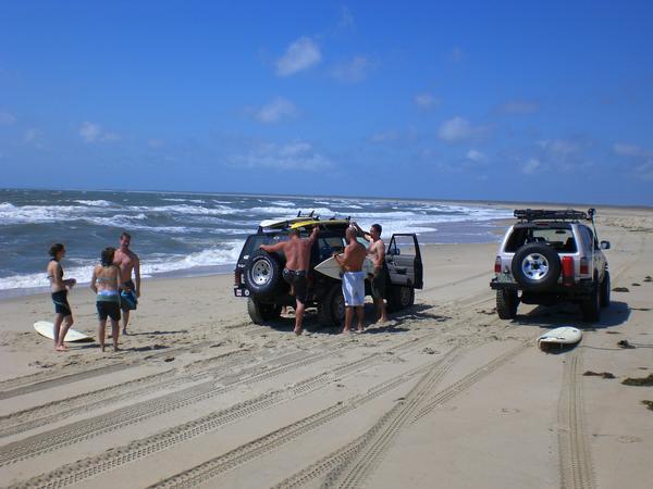

....not the best, here is mine, I made it so it is fixed, cannot open hatch with it on, but looks cool, also holds a gas can, license plate mount and light. I only use it on long trips and it has worked out well for me. It slides into the hitch slot in my fabbed bumper, then has a brace on either end that ties into the fabbed bumper to prevent bounce, shaking etc.
