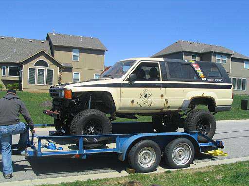

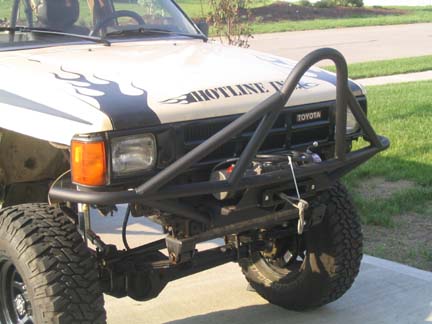

Nothing like selling your house and buying a new one to speed up a build. I had to kick it in gear in order to get it on a trailer and over to the new house.
Since then I have been mainly working on interior stuff and wiring up the stereo.
I had a local fab shop put in my exhaust, plate the frame and build my bumper.

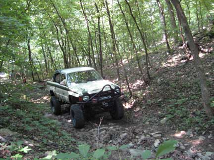

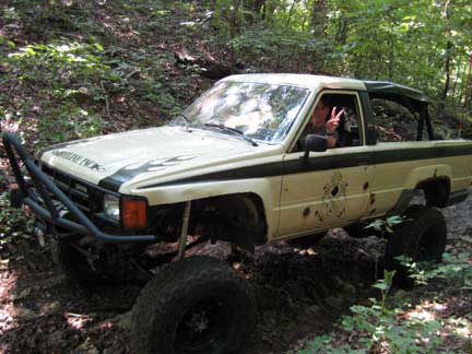

We had a little club gathering at a members farm - which gave me an excellent opportunity to see how everything works.
So far so good...
Need to chase down a belt squeel and a vaccum issue that is only affected when the break pedal is depressed.
Here are a few pics - more to come later.
I let my wife drive it most of the morning since she had to leave early.
