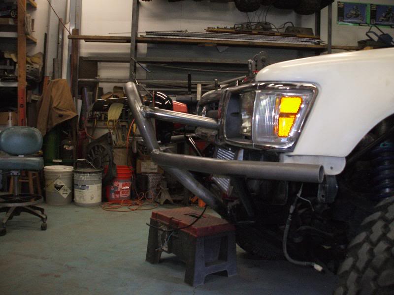

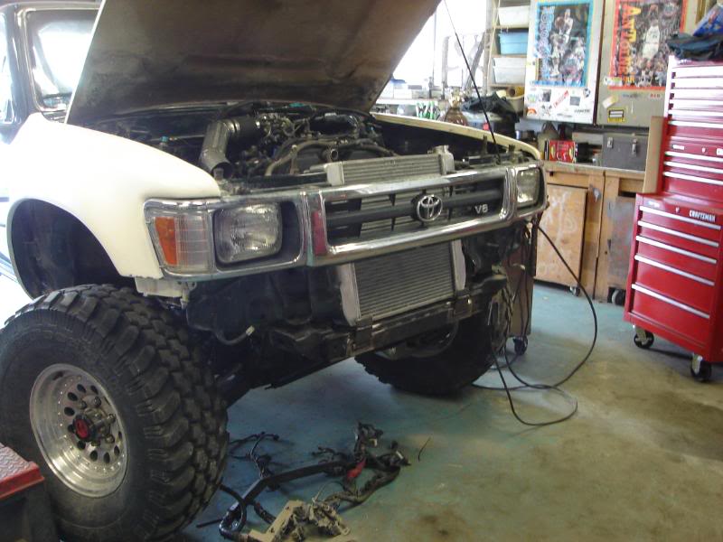

So while waiting for some parts for my 3.4 swap I thought I would try out my new benders and make some protection for the front.
Before.
after

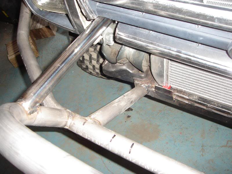

I am using 1.75x.120 wall dom and 1.5x.120 wall hrew. I tied it into my shock hoops so it will have a couple load paths and hopefully not fold if I come down on it hard.

No worries there. I considered load path in this build.

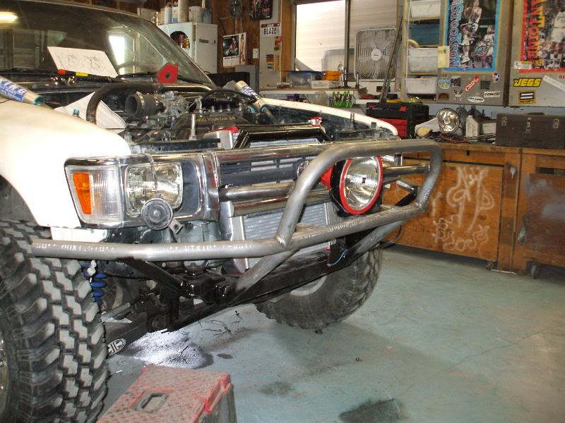

Well here are some update pics.
