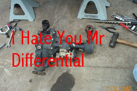

I got a new front diff from Randy Rack and Pinion. I drained the diff after 300 miles to find alot of metal flakes. Did I mention that it pulls hard to the left in 4wd. It makes a clicking sound (like a broken CV) but it comes from the differential. It feels like I have a locker and a broken passenger axle shaft. Drive axles are in good shape. The 4wd takes awile to disengage and my right front tire barks when engaged, followed by a loud CLUNK when it disengages. Could this be a problem with the intermediate shaft or the ADD? I am stumped.........
I want a SAS, but have no job. Oh well looks like I'll be using 2wd more now
Any tips or ideas about this damn diff.
Attached Thumbnails IFS differential sucks....300 miles and it's broke again-i-hate-you-diff.jpg

Are you missing teeth?
Was it broken in properly?
I had some shavings when I drained at 500 miles after breaking in the diffs, but nothing to be alarmed about.

here is what i would do:
take a can of carb cleaner and get all of the metal shavings out of everything including the intermediate shaft and the ADD. then refill it with some good mobil 1 synthetic
i had a problem with my 4wd pulling after i changed a cv axle. be sure the spindle is clear of any dirt and grime, and be sure to grease up the stub shaft when you insert it into the spindle.
check your cv joints for proper range of motion and make sure they dont bind, i would also remove the boot clamps and check to see if they are properly greased if i felt any resistance

Did the new diff from Randy's include the ADD mechanics? Sounds to me like this is where all your problems are, not the differential itself.
