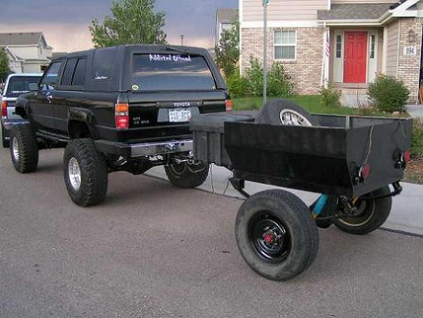

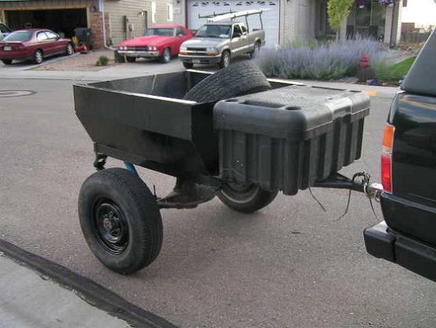

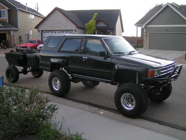

Okay, I decided that the axle was too far forward, so I went ahead and re-drilled the leafs to move the axle back and center it on the tub itself. I also pulled the overload leaf because there is no way it will need it. Then, I added some breakaway cables, the shocks, and will add the tool box seen on the front. However, I have also decided that I need to extend the front tongue section for more room for the tool box. I also finalized the fender design and just need to build them next week.
It has an extremely thin coat of paint just in case it rained. I will be rolling on the hammered tone and then repainting gloss black tomorrow as well.

got any pics or details on how you are running double bearings and hubs on that axle housing? I'm really curious how that works.
nice work, btw! but IMO, the SR5 rims look better than the black steelies.

Yes, but the SR5 wheels and tires are BALD. Besides the currents are only temporary until I can get the 35s mounted on decent wheels.

I went camping this weekend with it and towed the trailer up a couple good sections on Pole Hill Road just to see if it would bind or give me issues. I think it did around 12mi of 4wd trail use. I checked the coupler and ball when I got home and saw no issues with fatigue on either.
For the purpose of this trailer, I should be just fine with what is on there. This trailer will never see anything significantly hard (like the Rubicon). The main plan is to have something light weight that I can tow to camping spots around Colorado. For any hardcore wheeling it will stay in camp.
There are a couple things that I need to address on the trailer though.
1st being the shackles. They invert from time to time, so I will be adding some longer shackles to it to keep that from happening.
2nd being the length of the front tongue. I need to extend the tongue at least 12". I will eventually run a rear tire carrier, so I will definitely need to extend the tongue. I will just cut and sleeve it with some more square tubing.
All in all, it tows great behind the 4runner. I can still set the cruise at 75mph and while I know its there, I am still able to hold speed on flat ground no problem.

Awesome! I love the extra hubs and diff...can never have enough spare parts!
Just FYI you can pick up Pintles for cheap at the farm supply store. nice work!
