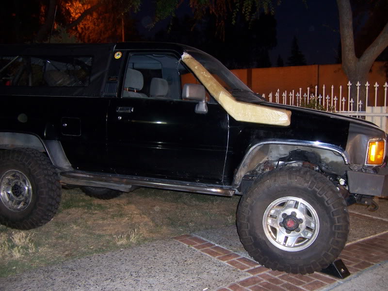

whaaaaaaaaaaat man?
Thats actually a really good size. Ive got a 3" pipe so that would be perfect
dude i was gonna say .. he has one with the 3" opening .. but i see you found a different one with the 3" opening.
Dude if you get that one off of ebay he wants $26 for shipping...direct from Malaysia!!
This would be the one I might get, has a 3" neck:
http://cgi.ebay.com/ebaymotors/SNORK...item23076f1238
im not sure if im gonna buy it or make it . well see .
well i think it needs more square edges instead of the more rounded ones , and it looks a little Big .. bloated or something. im gonna try and make it less fat.

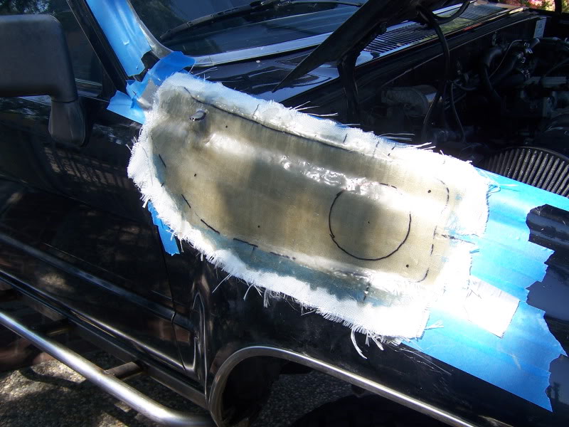

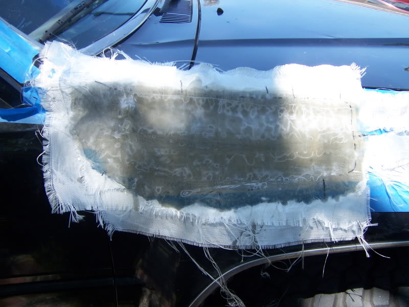

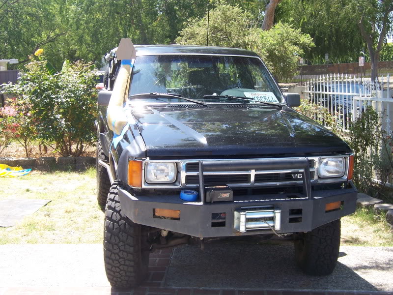

...U can call it: "The Cobra"...
Congrats... Very creative work...!
I'm learning a lot...

Freakin NICE man!
Well, I'm not a 100% happy with my inlet hood. I'd rather have a prefilter or an actual snorkel head.
Oh and yeah looks a little tooo big. Thats why I went internal...

off center air intake?
Just an Idea...

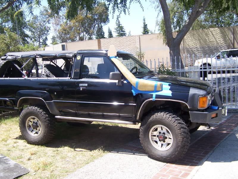

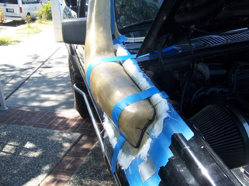

well i got to work on this a bit today .. and after staring at it for a while .. i too got to feeling it was to big .. i think its probably better that its bigger so as not to restrict any air .. My throttle body is 3.5" at its opening, so i was trying not to make anything smaller than that.
but I did end up cutting it up a little .. heres what i have so far ..
now i need to wait for the nutserts and filter i ordered so i can finish this up .
