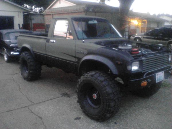

i have an 81 pick up with a 351 windsor in it. not efi tho
Attached Thumbnails Ford 302/351 swap info-5n85ec5h43ec3mc3ldc6mece7c3eb5e0a11e2.jpg   Ford 302/351 swap info-5g65e15h53e73ka3l8c6ma0381ce1793d1351.jpg
