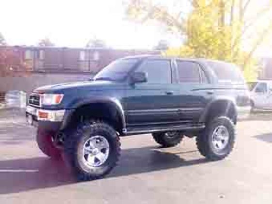

Attached Thumbnails Flex shots of 3rd Gen 4Runner SPRING OVER SAS-slc_toyota.jpg
Old Jul 19, 2005 | 08:52 PM
  #53
slc_toyota's Avatar
Joined: Jul 2005
Posts: 35
ya that is my runner in the pic i would really like to do a SAS any suggestions? kit? or what axle, i have heard a lot about either the waggy 44 or a ford 44
