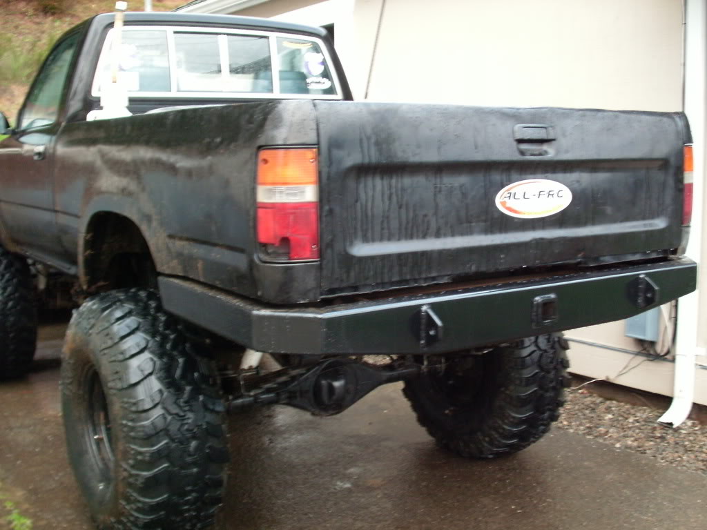

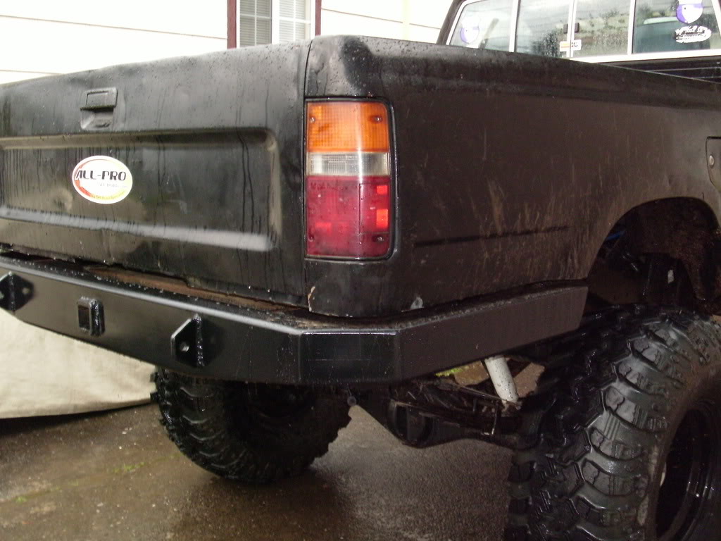

its done
now i just need to find a jeep to pull out. shouldnt be hard

Did you box up the fenders? Looks beefy!!!

Looks great. That is some serious thick steel you used. It should hold up. I feel sorry for the SOB that rearends you. Mine held up great in a rearend and it is only 2x4x 3/16.
no, it doesnt flop around in the wind or anything. the main issue with cuting the bed like that is, mud and stuff can get in behind the tail light(small hole in bottom of cavity). but i plan on making a few pieces of sheet metal to weld in there.

Nice bumper. Looks great. Pretty damn close to how I'd like to do my rear, what with the trimming of the bedsides etc.
What'd you use to trim them and what did you put on 'em afterwards (primer etc.)?
thanks!
i used a grinder with a cutoff wheel. and i just used some tractor enamel (really tough paint).

looks alot like a bumper i designed and posted up here. too bad i just dont have the time or money to actually makemine yet.

no, i didn't see that thread. but they are similar in design.
i actually designed it off of my front bumper, and off of 4runner style bumpers.
i like the way 4runner bumpers come around the side and into the wheel well. plus i had some body damage that needed cut off there anyhow.
search custom front bumper and check it out, if you haven't already.

do you have a guess what the cost of materials was for the front and rear bumpers?
Old Feb 27, 2009 | 02:34 PM
  #40
TOYOTA 1's Avatar
Joined: Feb 2008
Posts: 2,799
From: oregon
yea,
the metal alone for the front was around $250 give or take.
the rear metal was around $225.
thats just for metal! no bolts, no paint, no grinding discs, etc.
a rough guestimate on what i spent total for a complete bumper front and rear would be about $650
