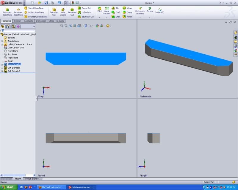

so my old tube bumper decided to fall off when i hti a desk this morning. lol.
so me and a buddy started to build. this is what i have so far. i have an idea in my head and am in the process of making a 3d model. so lemme have your ideas guys!!..
yes, that is a piece of semi truck frame.
yes, it will house a winch when completed.

Looks unnecessarily heavy....
But its good to experiment! Don't those frames say not to weld or cut on them? Is that just while on the truck so it doesn't mess up the truck or ??

yea, i want it to be pretty sturdy, i think i have acomplished that.
yes, it is just while its actually being used as a truck (structual issues)

here is a 3d model of what it will somewhat look like.

i think it would function a whole lot better and offer more protection if you mounted it vertical instead of horizontal...mounting it horizontal like that means you will have to add even more metal to protect the rest of the grill and such..

and i think that semi-frames are hardened steel, so welding on them weakens them significantly, but i cant be sure.

why would they be hardened steel? those frames are meant to twist like crazy.

Originally Posted by peow130
epic bumper.
they are highly ductile and have a "spring" to them so subjecting them to the intense heat of welding makes the steel hard and brittle. Not a good choice for front end protection....

the approach angle is not so good!
not sure about the metal type.
cant comment on the rest because its not finished.

im pretty sure its going to be plenty strong enough. as i am going to be adding braces and such.
i do have to cut a hole or remove the skid plate section i have. (kinda keeps the truck a little on the warm side.)
not an issue of strength through "braces and such", its the strength of the steel itself after welding on it. Your changing the grain structure of a highly ductile steel completely when welding, thus creating a very brittle steel where it has been welding making the joints very weak as opposed to the surround metal.
