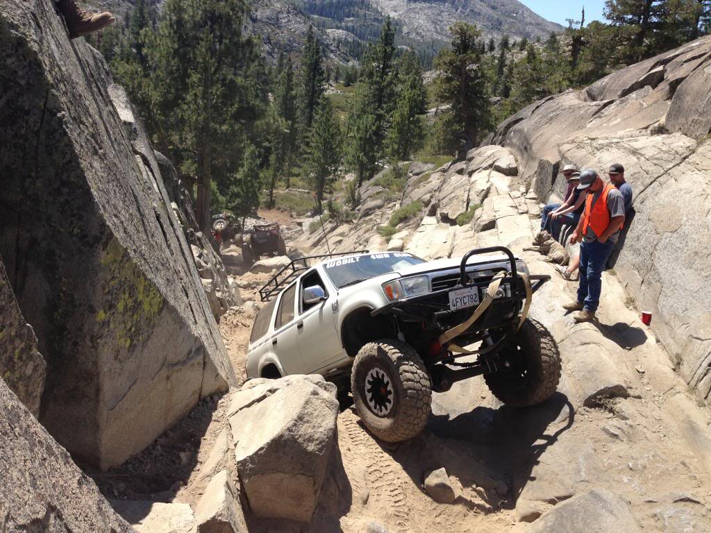

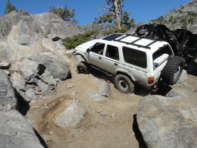

Heres a rack i made for mine . 1.0" dia 1/16 wall steel tubing. Light and strong.
I made a small frame that bolts onto the roof then the rack bolts to the frame. I took my headliner out and seen that there are roof braces that run across . I drilled through the roof braces and bolted to the frame.

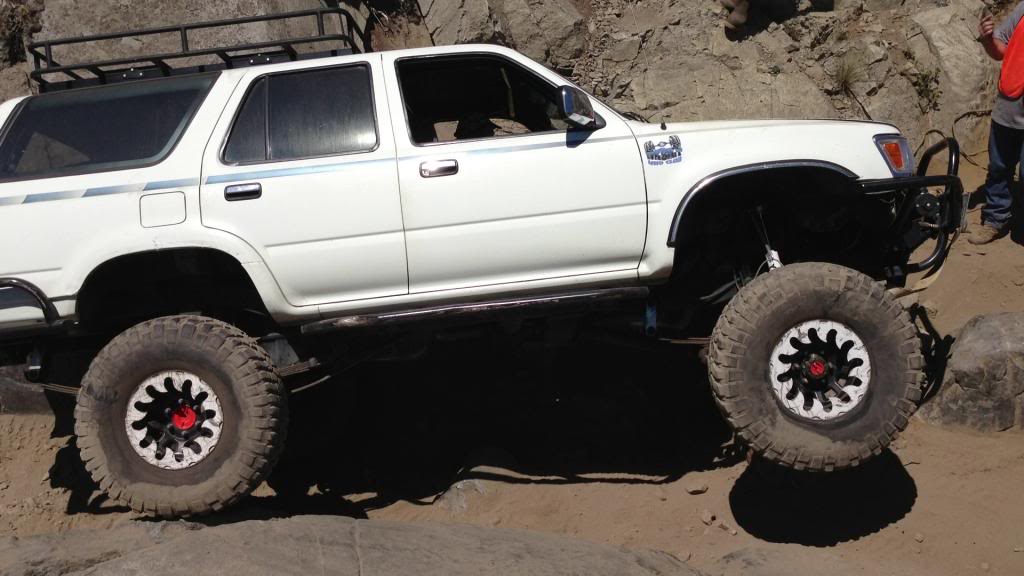

Heres a few more pic's. Not very good.
The base frame is 1x2. That stays bolted to the truck. My plan was to make a couple of different style racks . One for camping and another for holding a canoe .
