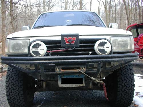

Here's a piture of mine. I had the same problems with fitment. I made the side markers turn and markers so I could get rid of the turn signals under the bumper.

The lights are really kinda easy to do. It was sort of a really cheezy way to do it but, I just took my dremel and cut the light socket bucket of the back of the old rectangular turn sigs and then cut a hole in the back of the marker and jb weld the buckets to the marker and you got it. Very visible from the front and side and work great. Hope this helps !

Well I used a larger drill bit and drilled right through the mounting plate and internal welded nuts and then used new bolts and snaked the nuts in through the frame holes and zipped it down.
