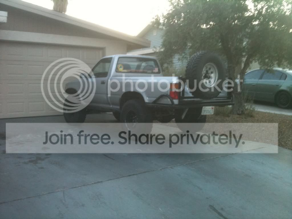

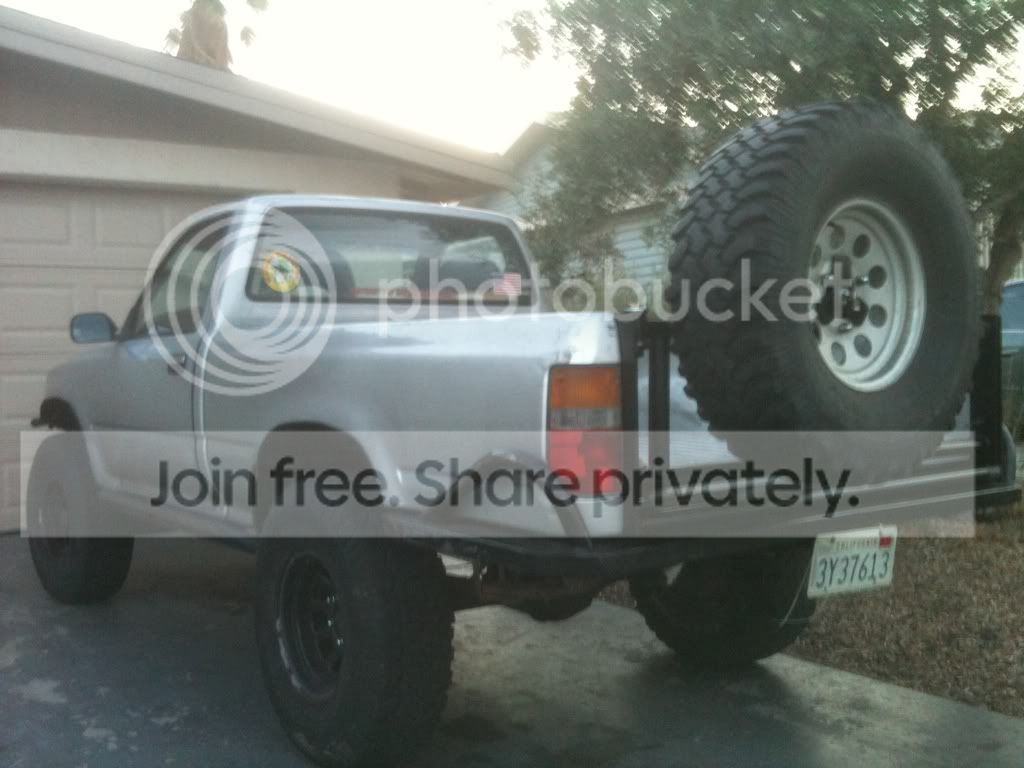

Got it painted and put back on, I still have to skin it, I spent today redoing some wiring and putting a new CD player in the truck so I didn't get any work done on this, but here are some pictures from my phone so they are kinda crappy

What's it like backing out? I have a swing out tire carrier, but as of now the spare is small. Larger one going on in the future.
No problems at all. I offset the tire so that I can see behind me at all angles looking over my shoulder either way or using my mirrors. It's obviously not as easy as not having a tire there, but nothing bad

So here are the pictures of it skinned with the handle grafted in. I still need to do another round of bondo work, but I ran out of bondo so I just painted it up and called it good for now. I had to make a little extension bracket for the latch to work properly, but it works perfect now. I think I am going to add a cover on the back section where the latch is just to cover it up...or I may just mount my jerry can in front of it, we'll see. The metal was a little too thin for the set up I had to weld it very well, so I just did little tacks the whole way around, looks pretty bad on the back side but oh well. I took some better pictures on my camera, but I didn't have time to upload them before I left so here are some from my phone to give you an idea.

I'm sure there will be a few, there's already a list of things that I learned and would do differently if I built it again, but they are minor so far, hopefully there isn't a catasrophic failure and it doesn't fly off on the freeway haha
Next up is how to mount the license plate light and my hi-lift...debating on whether or not to mount it on the top rail, or cut it to mount on the backside (hidden)
