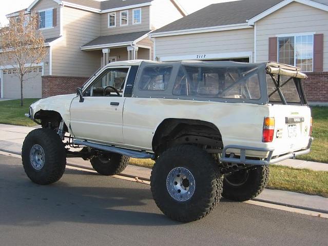

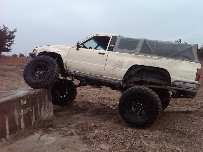

Just picked this up this weekend to wheel while I build my buggy.
Specs:
22RE out of a '94 with 60k miles
Marlin-built 5 speed
Marlin dual cases - 2.28 & 4.7
5" Marlin springs
18" ProComp Explorer shocks
Hydraulic bump stops in front
Full interior roll cage
'94 4Runner bucket seats
Front Axle
- High-pinion with 4.88's
- Detroit
- 30 spline Longfields
- Chromoly drive flanges
- FJ80 brakes
- Hy-steer with IFS box
- Hydro ram assist
- Long spline driveshaft
Rear Axle
- IFS axle
- V6 third
- 4.88's
- Spool
Attached Thumbnails Mudinyeri's '85 4Runner-pic1.jpg   Mudinyeri's '85 4Runner-img00109-20091115-1017.jpg
