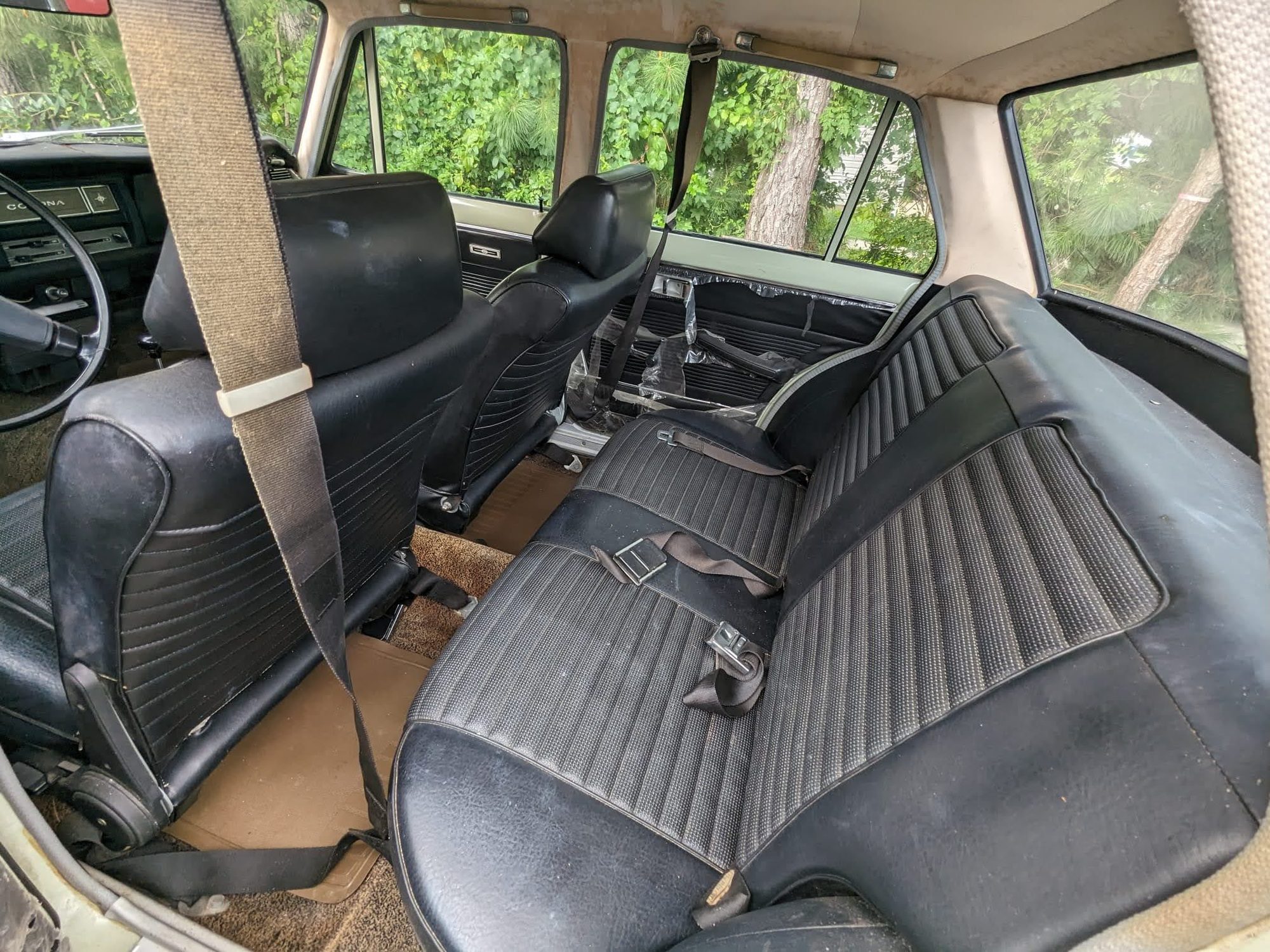

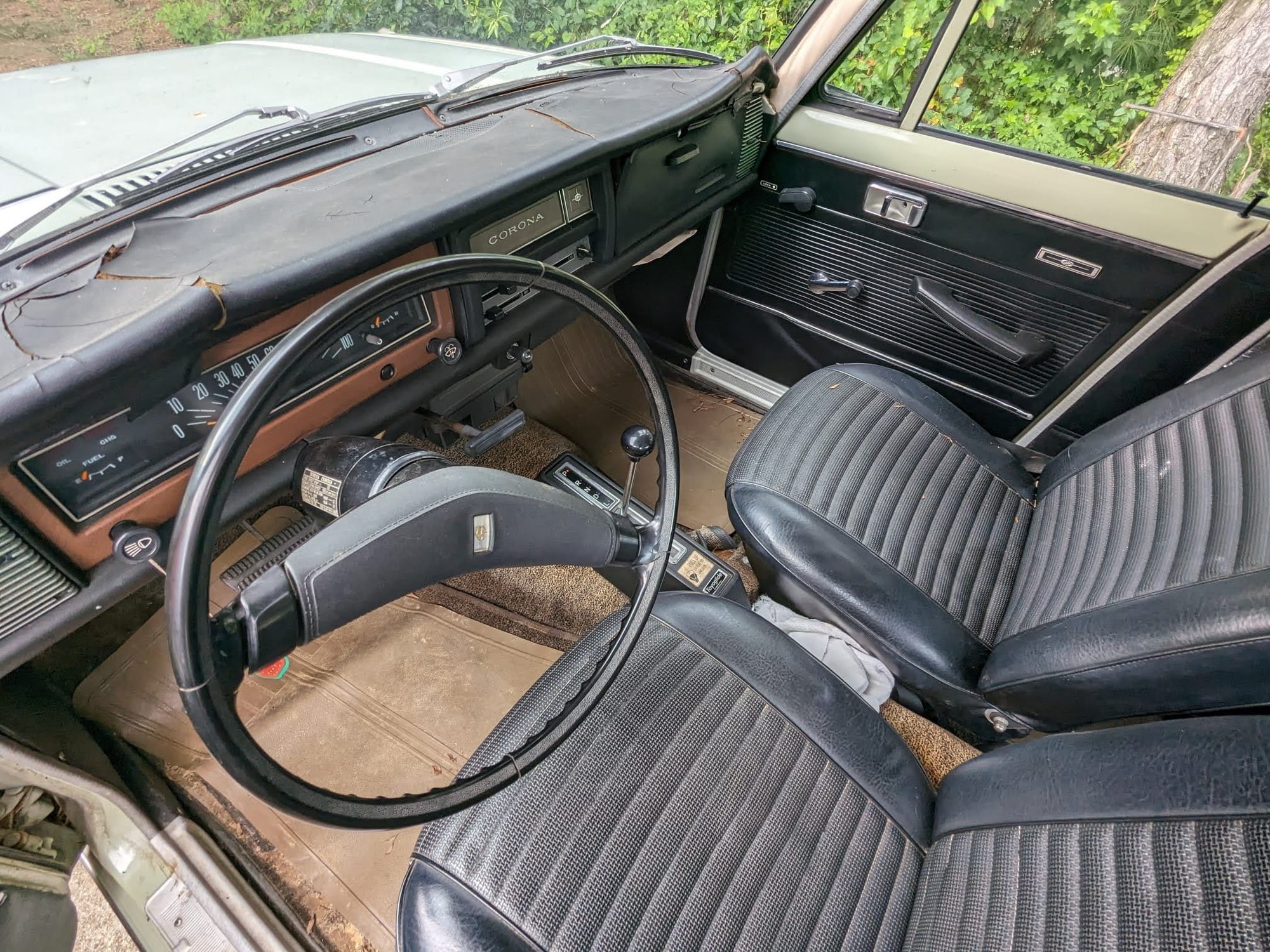

interior is in great shape
need a new dash, if anyone car share ideas

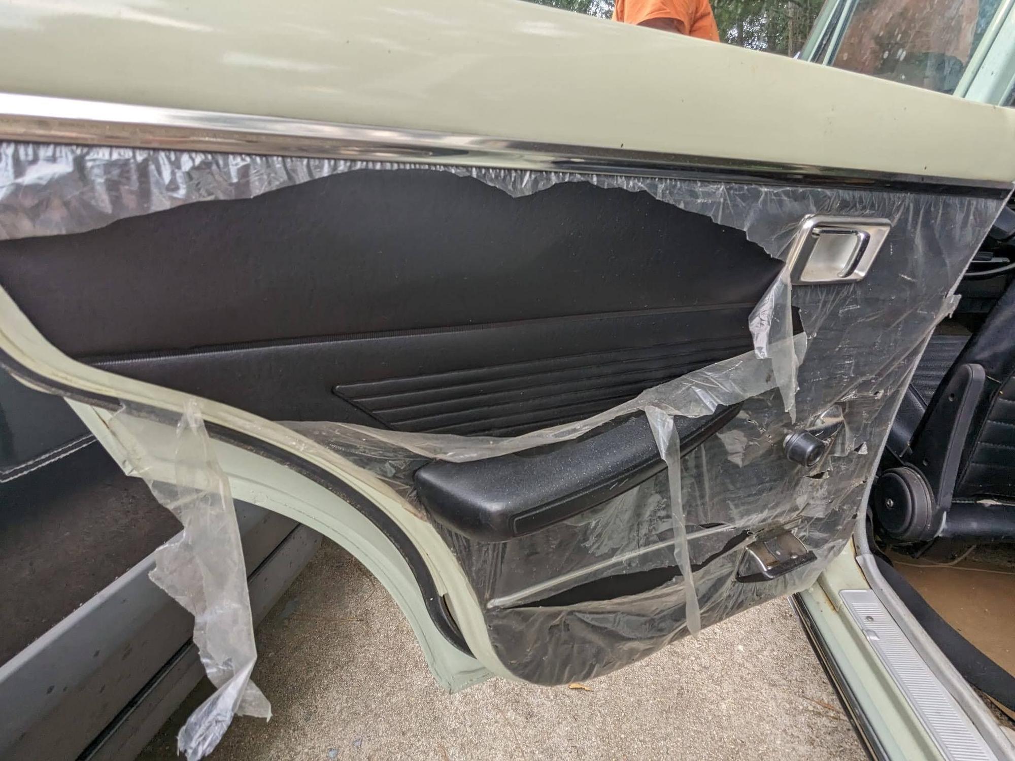

yes thats the factory plastic covering the interior door panel, I couldnt believe it
