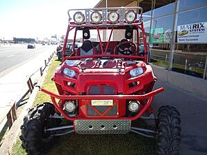

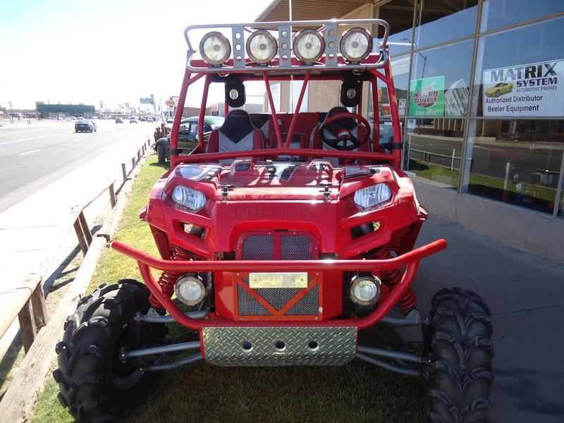

FYI- You don't have to go to customs CV's, You can mill new flanges for the front diff and switch to u-joints. It is rarely done tho, but it's another option. I had a customer who built a Polaris Ranger with a 3.4 and a 4runner front diff and thats what he ran on it.

I have a set of Downey Slip Yoke CVs that use the new flanges and a Spicer U-joint. I bought these back in 2001 and paid over $600. They were horrible. Downey said it was for low speed applications only. Boy they weren't kidding, the vibration was terrible at 10 MPH. Do you have any photos of your customers Polaris drive axles?

Well your kit uses stock UCA. Yes it has a Ball joint extender on it, but it is stock. I looked through all my photos and I only have a couple pics of the beast. Basic pictures for posting it on race-dezert. None of the drive line. Although I can say I drove it on pavement in 4x4 up to atleast 70mph and I didn't notice any vibrations, the shafts were made by a guy in so-cal somewhere.
