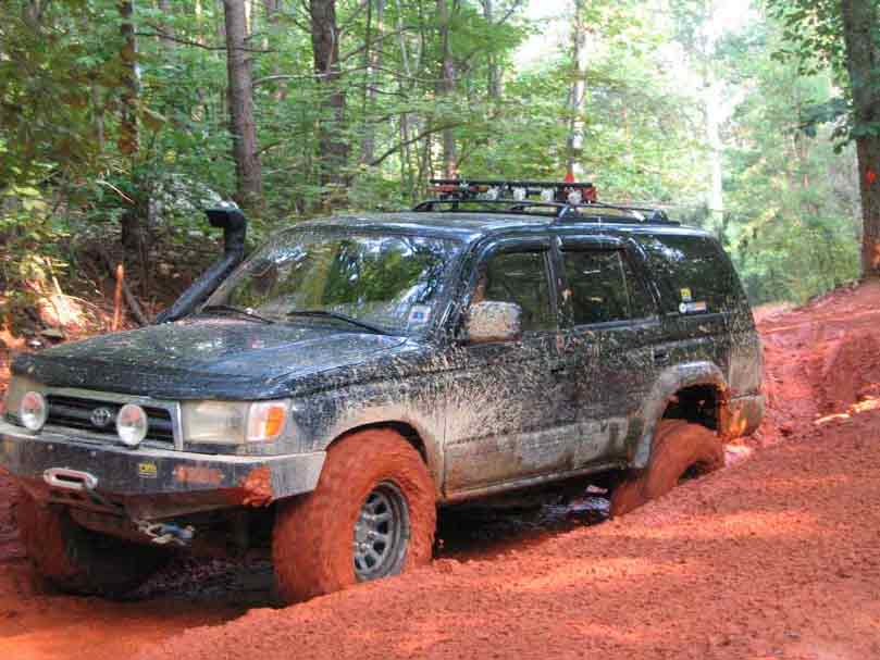

I mounted my Hella 500s on my factory bumper between the headlights the lights are plenty bright to sit that close together. My TJM bumper did not have a plac to put lights either so I mounted them the same way. I made a light bar by using a light bar with six Hellas from a 2001 mastercraft x-star and welded aluminum legs to it, attached it to the fatory cross bar(the flat ones, not the raised one. It is attached via 2 thumb screws and suppoted by extra strenght cords (support and can take small impacts. I used a 2 prong trailer wire connector for the power and 12 gauge wire to wire them all to one switch. It is tall enough that I can still mount my hilift to the cross bars. It can be easily removed by detaching the cords, removing the tumb screws and disconecting the wire, i takes under 1 minute.
Attached Thumbnails where to mount off-road lights, opinions and ideas??-mud1.jpg
