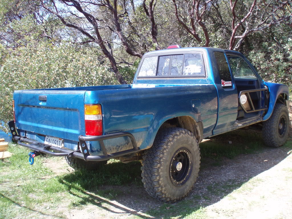

get some bj spacers /ome torsions and some mudders and go wheeling till you can save up for gears and lockers with bigger tires-

i run bj spacers w/ fenders and stock rear springs (no lift) and 33x10.50's but you'll need gears if you go up to 33's
