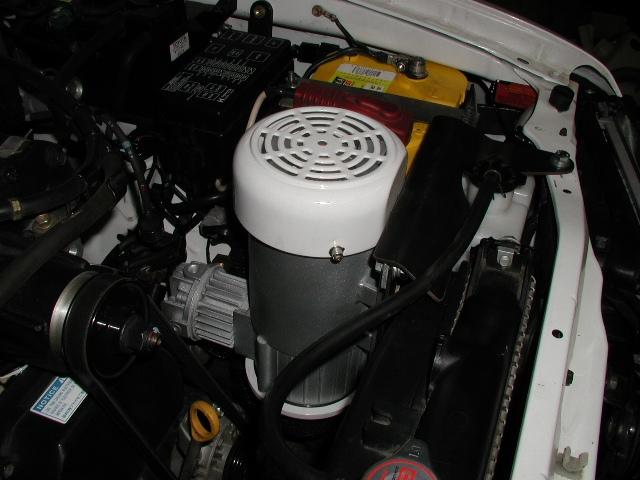

george16's Avatar
Joined: Sep 2002
Posts: 513
From: Florida
Originally Posted by mtxride
What's a good compressor to get? and by the way, where does everybody usually install them in a 4runner??
You can buy Extremeair or Viair and have it installed in the engine bay. Some of the guys here have it done that way. Check this thread out. here's a pic of an Extremeair mounted in the engine bay.

mtxride's Avatar
Joined: Jul 2004
Posts: 121
From: san antonio, tx
If only using the compressor for lockers, do you need an airtank?
I guess my question is a little off topic, but hey, it's helping me decide between arb and toyota e-locker

ErikB's Avatar
Joined: Mar 2003
Posts: 79
From: Auburn, CA
The ARB compressor comes with its own small built-in tank, no need for anything more if you're only running the lockers.
No need for a tank with any other compressor either really. The lockers use a very small amount of air. I have a York, and no tank.
