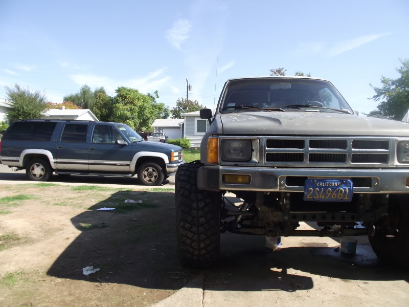

This is the stance of my 86 with 35x12.50's on 10 inch rims with 3.75 backspacing. over all, the tire stuckout 6" beyond the fender. Another note to keep in mine, I had a 3" body lift, which at full compression and steering locked, there was about an inch to spare before the tire would contact the fender.
