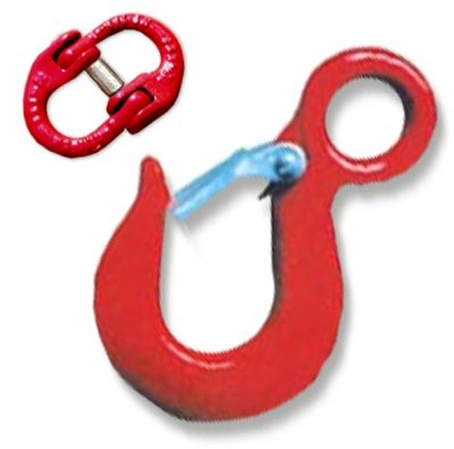

I ordered a synthetic line, aluminum hawse fairlead and a hook today for it. The line is Amsteel Blue. I ordered from OKoffroad.com through Mark. Nice guy and answered all my questions thoroughly.

Amsteel Blue Synthetic 3/8x100'
Slimline Aluminum Hawse Fairlead
"Big Red" Winch Hook
