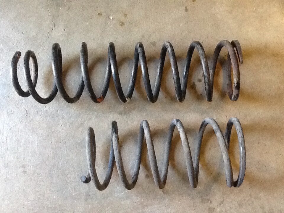

I know this topic has been beaten to death a few time over, but after some searches I can't find the answer. I have a 94 4runner 3.0 and decided on the bj spacers/cruiser coil lift. Ordered the coils from an online dealer for used cruiser parts. They are 21" tall, 5 3/4" OD. The ones I just took off were 14 1/2" tall and 6 1/2" OD. It does not seem like these will fit. Called the parts dealer up and was assured they were the correct part as this is a very common order for them. He stated they should be the front FJ80 coils, is this correct? Any help appreciated.

For the rear of the 2nd gen Runners(90-95) you need the rear fj80 springs. The front fj80 springs are used to lift the rear of 3rd gen Runners(96-02), I'm pretty sure.

this is correct.
