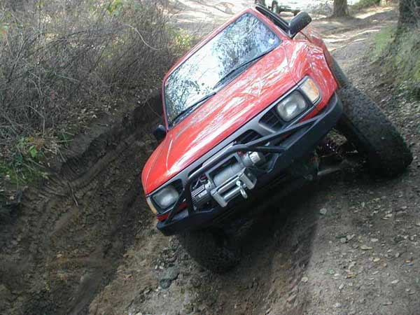

For the record, TC will be releasing a coil-over compatible 1st gen IFS long travel setup soon if not already. There is nothing wrong with a cheap straight axle truck that is slapped together and wheeled hard, but that is a different creature than a nicely built IFS retained versatile 4x4 truck. I can speak from experience on both ends. We have a TC LT equipped Tacoma and it rails corners like a sports car, can jump high and believe me it wheels just fine, in fact it has so much droop that it almost doesn't need lockers because it almost never lifts a wheel. We have tested it hard and this past weekend we took it out with our V8 CJ-7 on D60's with 39" swampers etc and the Tacoma wasn't far behind. Of course the 33" tires limited the Tacoma in the rocks but if you were to compare a mildly modified Rubicon with our Tacoma (with lockers) I promise the Rubicon wouldn't go anywhere the Tacoma couldn't. He asked about mounting coil-overs to a 1st gen. truck, lets please post what we know about that. Not just say "hey you should SAS that thing and ditch that crappy IFS" that is only one way to look at it. I plan to put a 4-link SAS under my 4Runner with 14" coil-overs but if we didn't already have an IFS Tacoma, I'd most likely keep my IFS. We will also be building a coil-over 1st gen. IFS 4Runner, in fact we are picking it up tonight. Both are viable options with pros and cons...some say tomayto, some say Tomahto. I say do what you want to your truck based on your criteria, not someone elses. JD fab does good work so does TC, you can't go wrong either way, one nice thing about IFS LT kits is tha added width makes the truck a lot more stable on a side hill. To see how we got almost 14" up front and almost 18" in the back link here...
http://www.trailslesstraveled.com

We were not pushing the CJ very hard because this weekend was it's first time out in a few years since the frame up re-build and we needed to fine tune the fuel injection etc. None the less the Tacoma is nowhere near done and much more capable than you might think. Right now the Tacoma is pushing stock gears (3.50's!) and open diffs. We will be adding a marlin, 4.88's a rear ARB and 35's. We are waiting on a rear Tundra/T100 width housing from FROR until we install the gears and locker. And as far as having a less than stout 7.5" ring gear up front that is true, but only for now...We are building this truck to be bullet proof and 100% versatile...and most of all IFS. It will most likely use Porsche 934 CV's and I'll let you guess the rest for now...
RedRunner,
I really like Sway-A-Way's we use all 2.5" shocks. They are less expensive than King or Fox and work very well. They are also easy to tune and re-valve. Now that we have them setup really well the truck is amazing! Here's a link to articles on offroad.com about our truck and Sway-A-Way shocks as well as TC kits etc.
http://www.off-road.com/toyota/proje...oma/intro.html
We have tons of info on the Jeep and the Taco on our website here:
