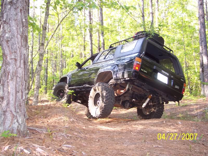

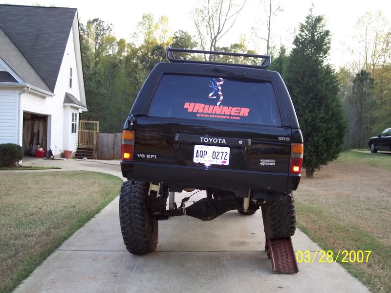

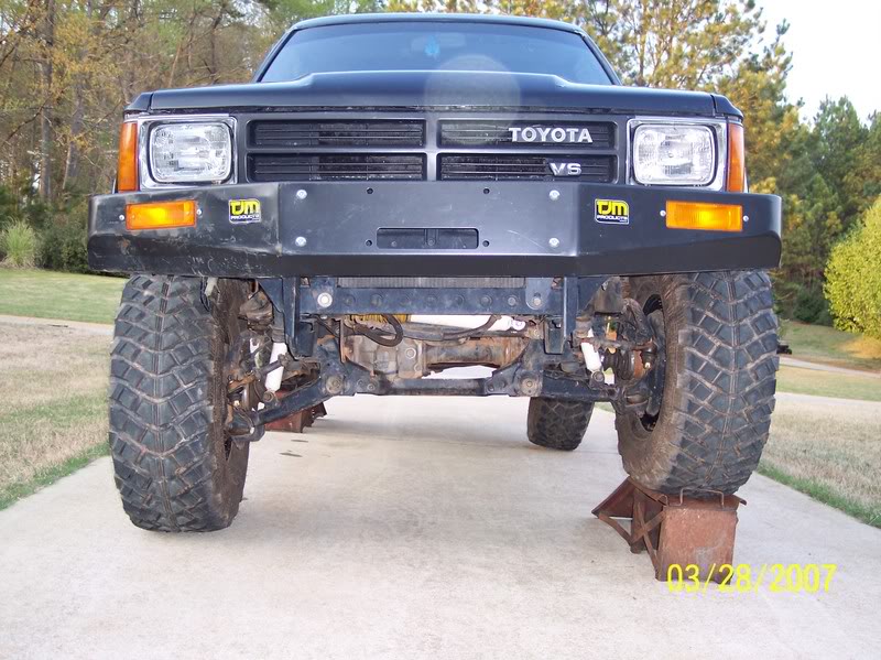

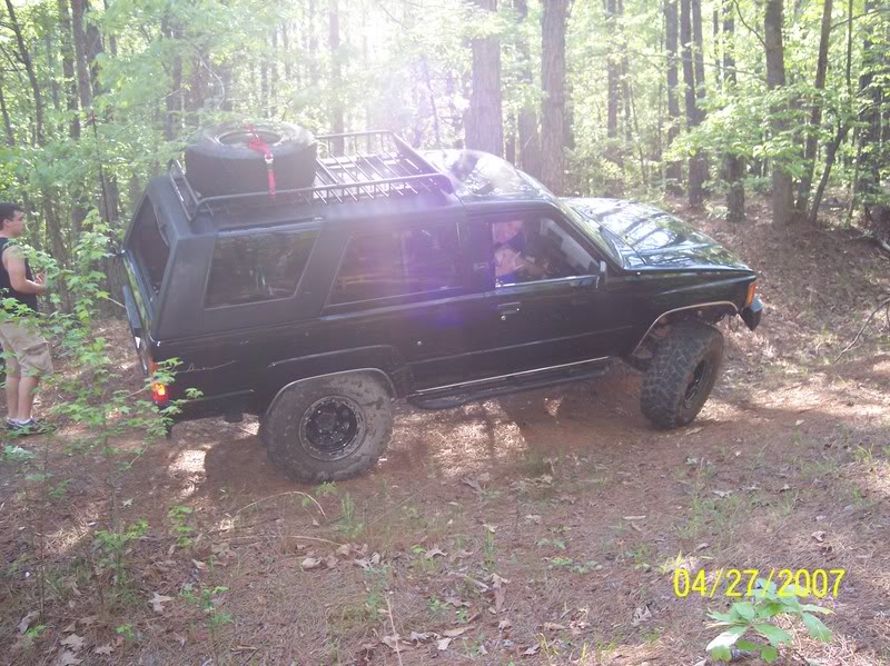

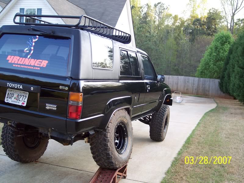

Why dont you like the 33x12.5s?
Old 09-13-2007, 06:33 PM
  #38
881stGenRunner's Avatar
Join Date: Mar 2006
Location: Atlanta, GA
Posts: 2,584
Received 7 Likes on 4 Posts
clearance issues and during full stuff the get into the inner lip of the fender in the rear. Then up front the just eat up the very back of the plastic part.
Makes sense, thats part of the reason I am doing at least a 1" bodylift or so. You get clearance and you can stuff them, plus the 3.75 backspaced wheels should help..
One day, gotta buy a truck/runner to do it with. My T100 is just to danged big to take on most trails b/c it requires ultra careful wheeling.
Does your runner flex pretty good though overall?

ive thought about doing a small body lift and a tummy tuck to get the guts up. the wheels are 15x8 w/3.75" BS.
see pics
