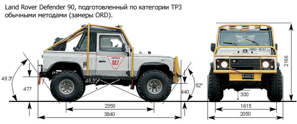

Old Aug 31, 2007 | 09:33 PM
4Mogger's Avatar
Banned
Joined: Feb 2005
Posts: 636
From: Montrose, CO
Standard axles 2250 wide
Attached Thumbnails Anyone ever see an axle like this before?-big-defenders_report_09.jpg

Did you look at the other measurement you posted? I don't know if that is the WMS to WMS measurement but it is wider on the portals. Regular axle - 1615 vs portal axle - 1688. I mean look at the darn pictures. The trucks are totally different and you want to call this a scientific test producing FACTS??? The regular axled truck has a full exo cage and completely different suspension. Different tires, hell are they even running the same air pressure? The portal truck also has a stripped interior and other looks like it added 200 pounds of interior crap. This is crazy talk. I said all things being equal a portal will raise your COG, that my friend is a fact and as near as I can tell its the only one that has been produced in this thread. Is it a large increase in COG? NO. Is it worth it, yes, I think so. If I had some blingin portals I would rock them. I would have to build a new chassis so I could use them and still stay low and keep the travel I have now. But most of us build on a budget and I already had a pair of 8"s so that's what's in the buggy. With my 8"s with a 55" WMS-WMS and 39.5s I doubt there will be many times were I wish I had portals but time will tell...

I doubt two more similar vehicles could be found to test. They are the same basic vehicles, one with portal axles and one with traditional axles.
The wheel measurement that counts is not the WMS but the overall width. And that figure for both is 2050. The wheelbase is different and so is the overall height. In fact most of the other measurements ARE different. Of course, they would be considering that portal axles and the mods needed to fit them will subtantially change all of those measurements.
Point being...if you would post those pics--particularly the first of both rigs side by side and ask yourself which rig has a lower COG--it would appear to be the yellow rover on stock axles. But that would be false. The white rover on Volvo portals has the lower COG and to me that is an amazing FACT.
