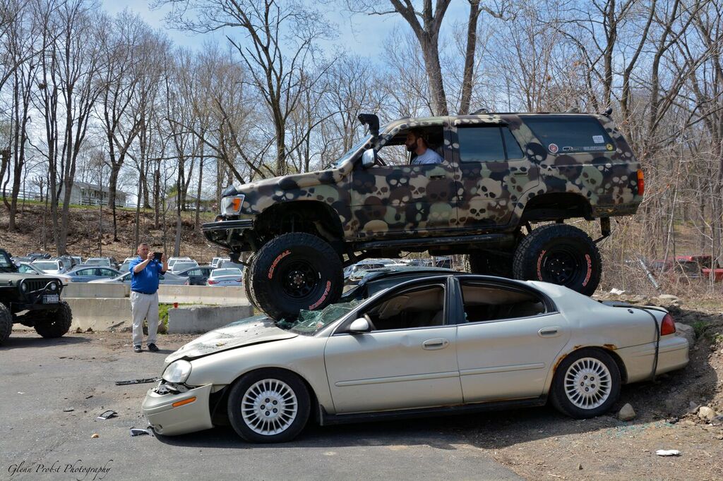

750 mile drive on 35s,dual r1fa cases and 5.71s ,reliability? precautionary measures?
Hi I've been away from the forums but I'm back with a general question on reliability of aftermarket parts and precautionary measures I should take before embarking on my journey.
For a quick summary my truck is a 1995 4runner with a 3.4 swapped motor and trans (newer r150f) adapter to dual r1fa trans cases(leaky and make a ching ching noise in 4wd above 15mph) leaky rear diff with an Arb air locker and 5.71 ring gear. Solid axle swapped with hydraulic assist.
I've never driven here farther than 75 miles let alone 750.
I've also got a good 2wd v6 auto 1995 4runner rear diff laying around
I live at my workshop in ny and I'm moving to nc within the next month so I'd like to get her 110% for the journey
I'm going to put new wheel spacers and front and rear wheel bearings.
Comp check the motor, possible timing belt &water pump
I'd like to swap the 2wd 3rd member in but I don't know if they are compatible? ??
I'm very tempted to overhaul the trans cases to get rid of the leak however I've never done this before, which has never stopped me before but some wizdom from you yotatechers would be much appreciated.
