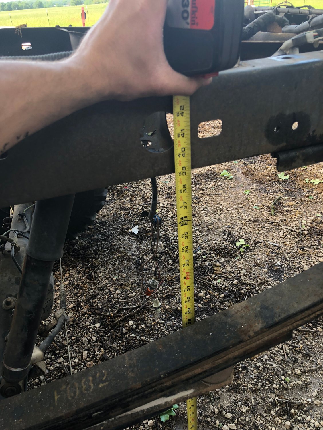

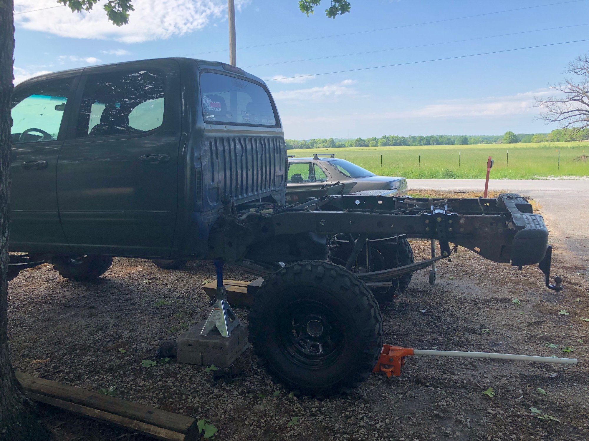

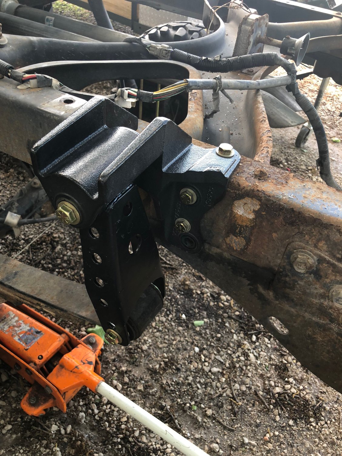

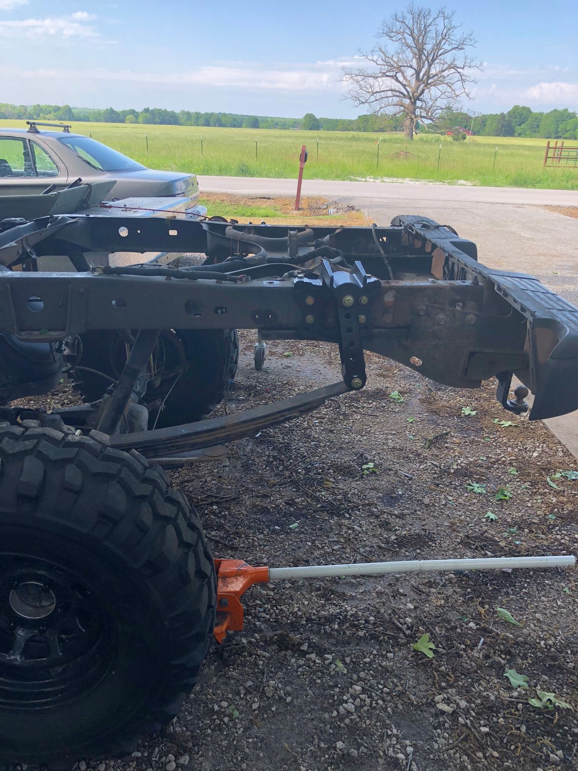

I decided I needed more lift and spring travel in the rear of my truck so I did a shackle flip. As it turns out shackle hangers from a 2017 f550 and universal parts store shackles work great for this.
Truck is setting on the tires. The jack stand isn’t on the frame anymore.
Added 2” of ride height now I have 39” from the ground to frame.
