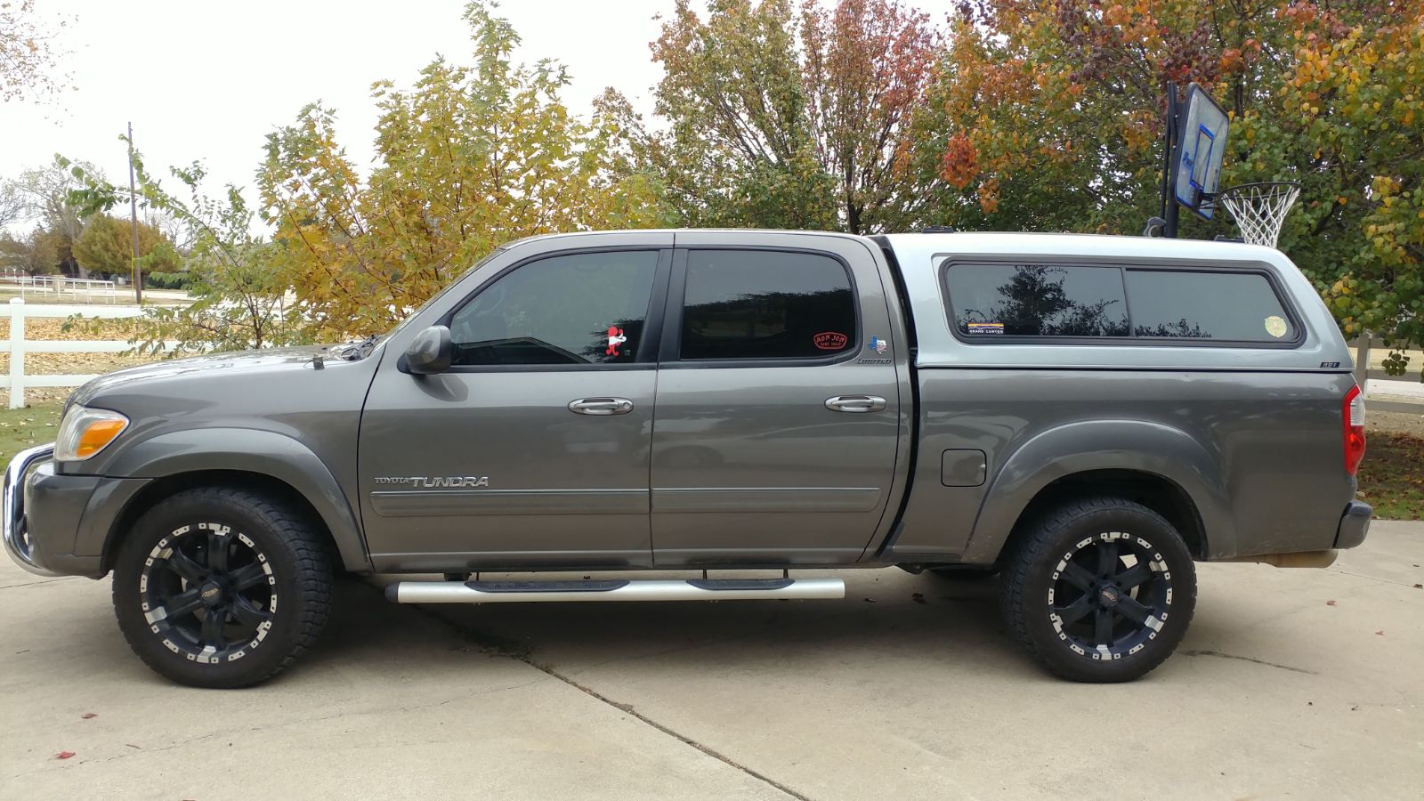

Hello All - Long-time stalker, first-time poster here...
Just inherited a 2005 Tundra Crew 2WD with the 4.7, but need to swap motor. The rub is, it has a blown head gasket and I'm already down a grand shipping it here from Dallas. I am hyped to get this truck, will be the coolest truck I have ever owned - my brother put a lot of cool stuff on it.. Pa-In-Law is a mechanic who owned a shop for 30 years and will be helping me get it going. We are pretty experienced with this kind of stuff, but not so familiar with Tundra's.
