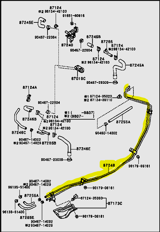

Tried the dealer with no luck. Does anyone here know where i can find this part in the picture #87248 Its for a 1991 Toyota 4Runner Thank you

Hi, yeah hard finding parts, eh. Suggest fabricating these lines from nickle copper (or tubing material of your choice)..

Is that the rear heater hard line going to the center console or under passenger seat area? You can run a long rubber line or build a hard line from 3/8" ish copper tubing. If you don't have the flare tool, you can rent from most autoparts stores or have a a/c line shop flare it for you.
Also, 89748 or whatever is not the actual part number, just a reference to the actual part number somewhere else in that diagram, usually listed under the pictures since the pics are generic. Post the vin and we can look up the actual part number.
