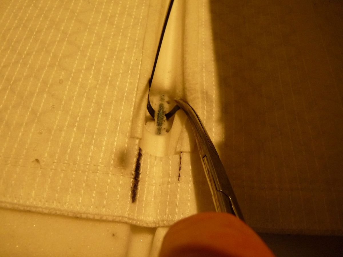

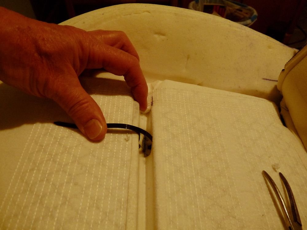

1st thing, seat heaters!
I found perfect seat heaters for it (~$100) on ebay. They work great. Installation is brutal, but it was worth every minute.

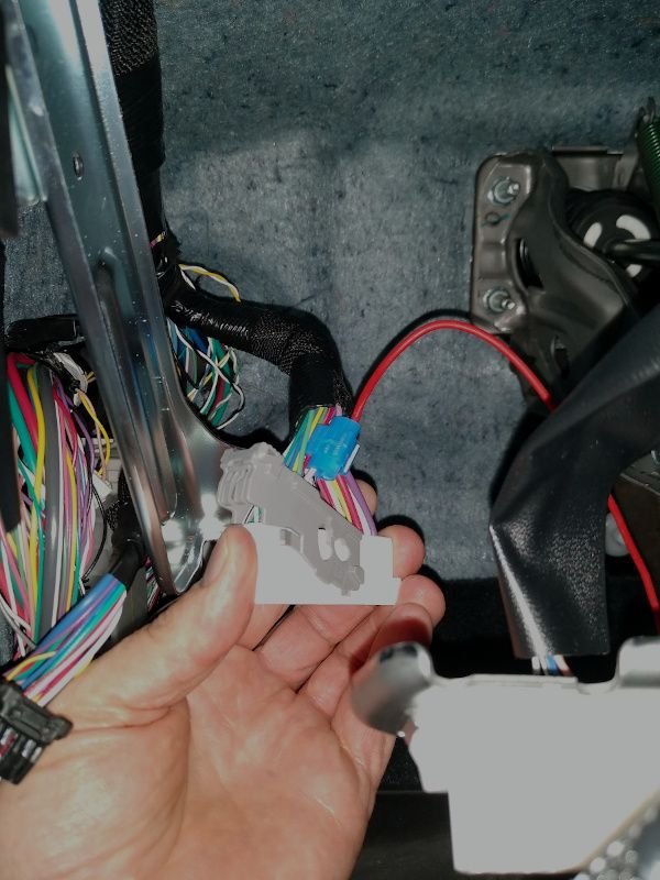

Wiring took some time but I found a good power supply line for the main circuit (sunroof circuit-I have no sunroof!). I found a separate switched circuit (accessories) for the power relay so it turns of when I turn off the key even if I leave the dash switch on.
