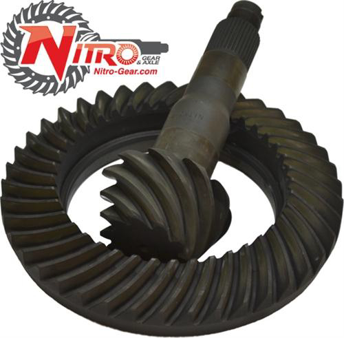

Re-Gearing:
The Ring & Pinion is the main set of Gears inside the Axle. Four wheel drives have 2 (1 front, 1 back). Vehicle manufacturers choose particular gear ratios based on a number of factors, that all revolve around a bone stock vehicle’s weight, tire size, horsepower, torque range, etc. They choose ratios to offer a mix of good performance and economy. This day and age economy is generally favored. Even small alterations in tire size and added weight can drastically affect a vehicles drivability, performance, and economy.
This is especially important for off-road / overland type vehicles. These vehicles tend to be heavily loaded with expedition and offroad enhancing gear like tents, fridges, bumpers, sliders, skidplates, winches, etc. Most of these vehicles also are running larger tires than stock. Also, most see a great deal of highway miles, making correct gearing even more important
It is a common misconception that re-gearing a vehicle is only for hardcore off-roaders or for huge oversized tires. Most of the late model vehicles we produce aftermarket ratio’s for are daily driven vehicles with slightly oversized tires. In an effort to improve fuel economy, late model overdrive transmissions are geared very high which means RPM’s are very low on the highway. When even a slightly taller tire is installed the RPM’s are reduced below acceptable levels that the engine was designed to run. This causes constant shifting out of overdrive, sluggish acceleration, poor economy and rapid wear on the transmission and other components.
By changing the ring & pinions in your vehicles differentials, you can match the ratio to the tire size to bring the RPM’s back to where the manufacturer intended. Typically it is recommended to select a ratio slightly lower (higher numerically) than what the math will tell you. This will help accommodate increased rolling resistance, wind drag, and added weight of aftermarket accessories and gear.
Differential Care & Break-In Information
New Gear Break-In:
All new gear sets require a break-in period to prevent damage from overheating. Any overloading or overheating will cause the gear oil to break down and the ring & pinion will fail. Please follow these guidelines to insure proper break-in.
-After light use for the first 15 to 20 miles it is best to stop and let the differential cool before proceeding.
-Avoid heavy acceleration during the break-in process.
-Nitro Gear warranty requires at least 500 miles before towing.
-Nitro Gear also requires towing for very short distances (less than 15 miles) and letting the differential cool before continuing during the first 45 towing miles.
-Nitro Gear recommends changing the oil after the first 500 miles. This will remove any metal particles or phosphorous coating that has come from the new gear set.
This may seem unnecessary but it is very easy to damage the differential by loading it before the gear set is completely broken in. The greatest damage results when a new ring & pinion has been run for several miles during the first 500 miles and the oil is very hot.
Any heavy use or overloading during the first 500 miles will cause irreparable damage to the gear set that can be determined by inspection of the gear set and will not be warranted
