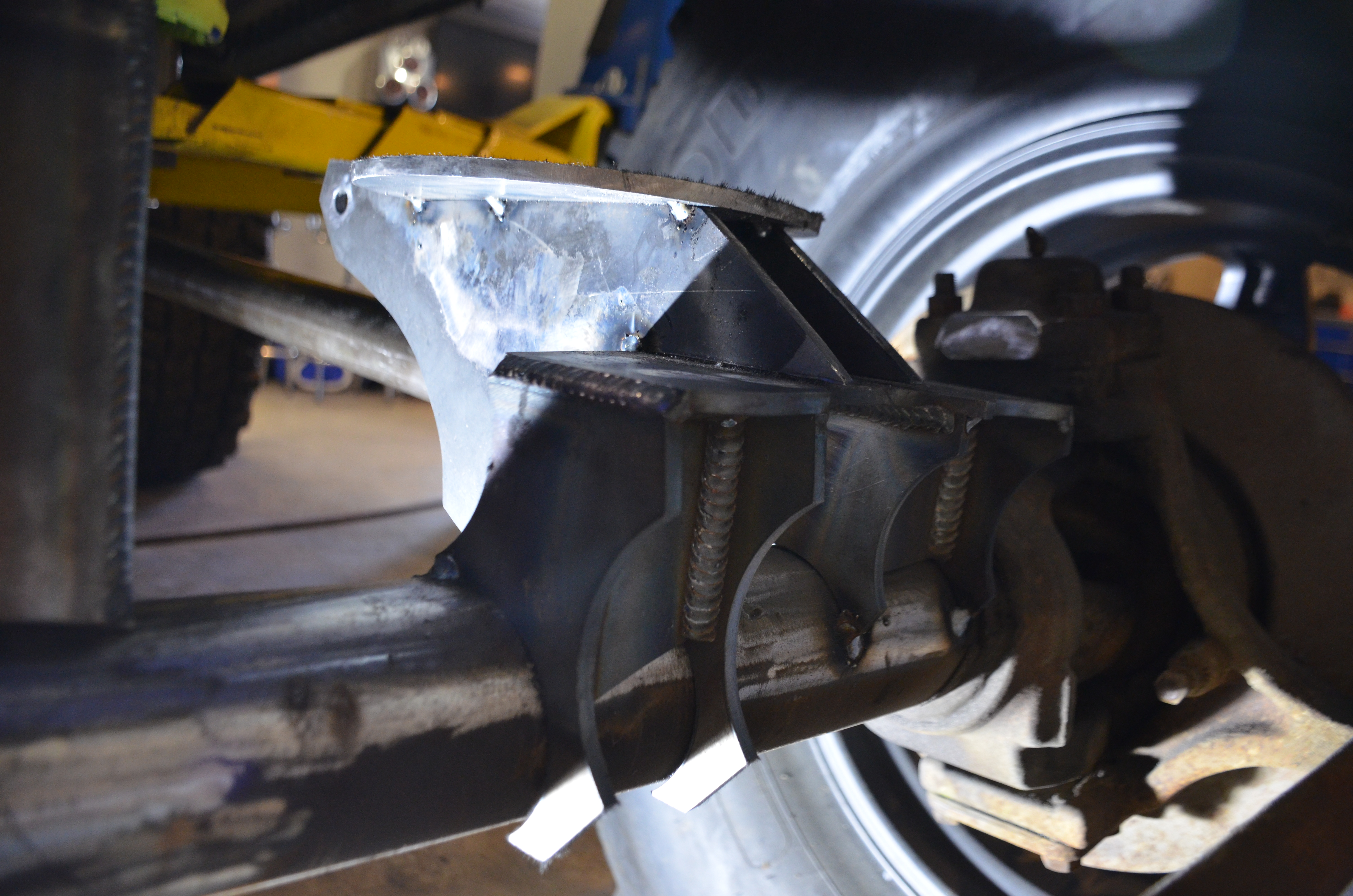

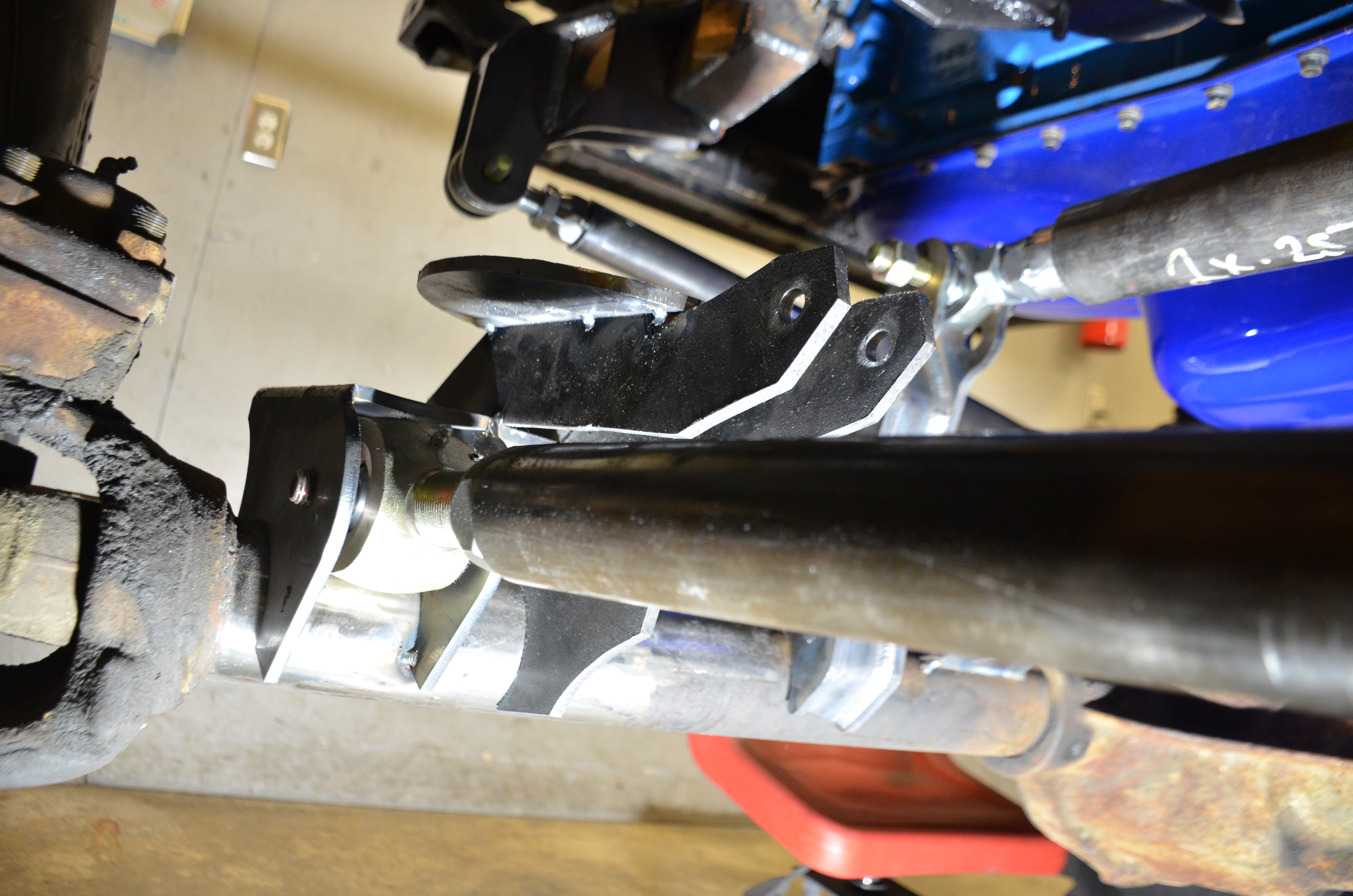

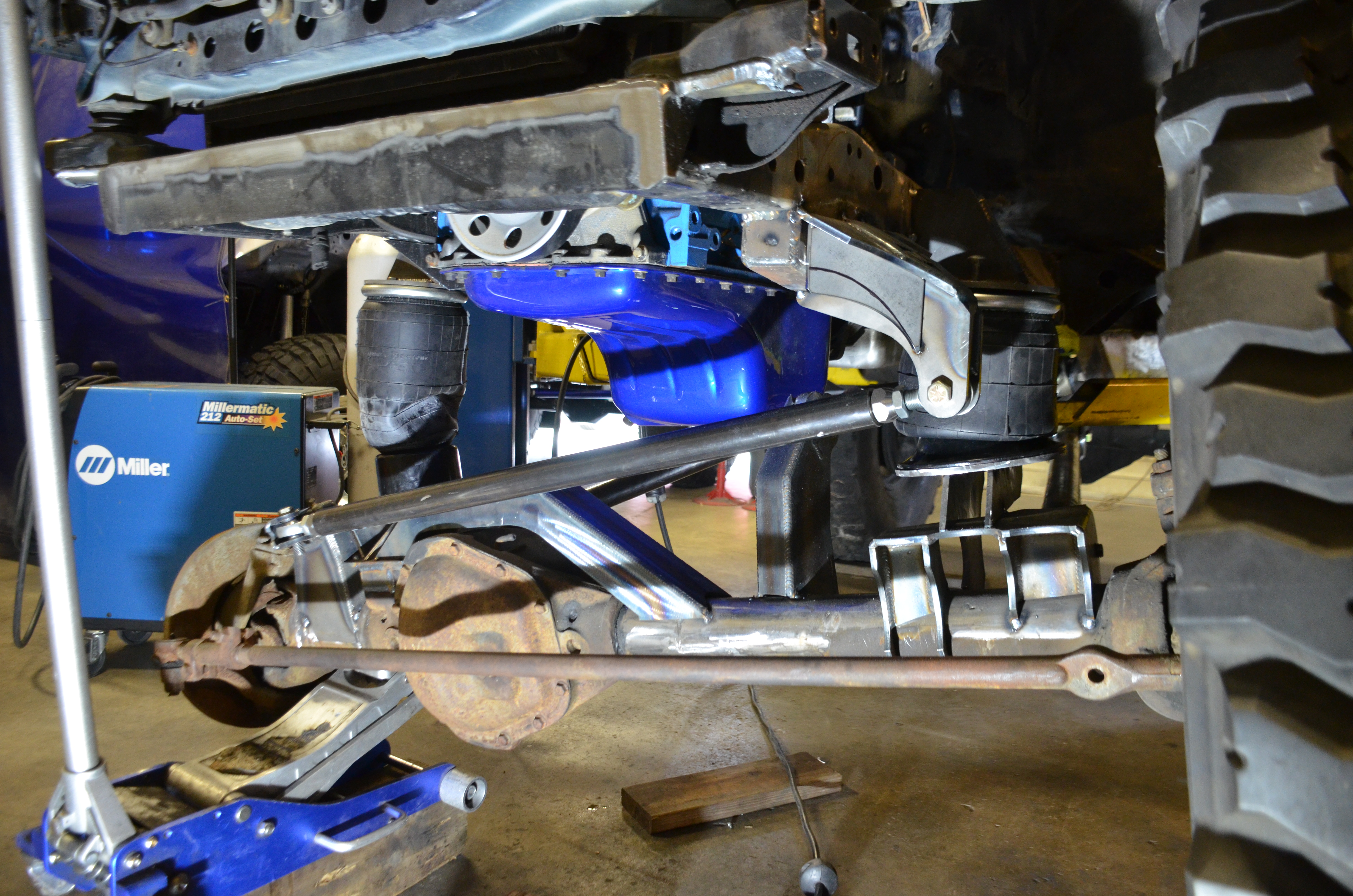

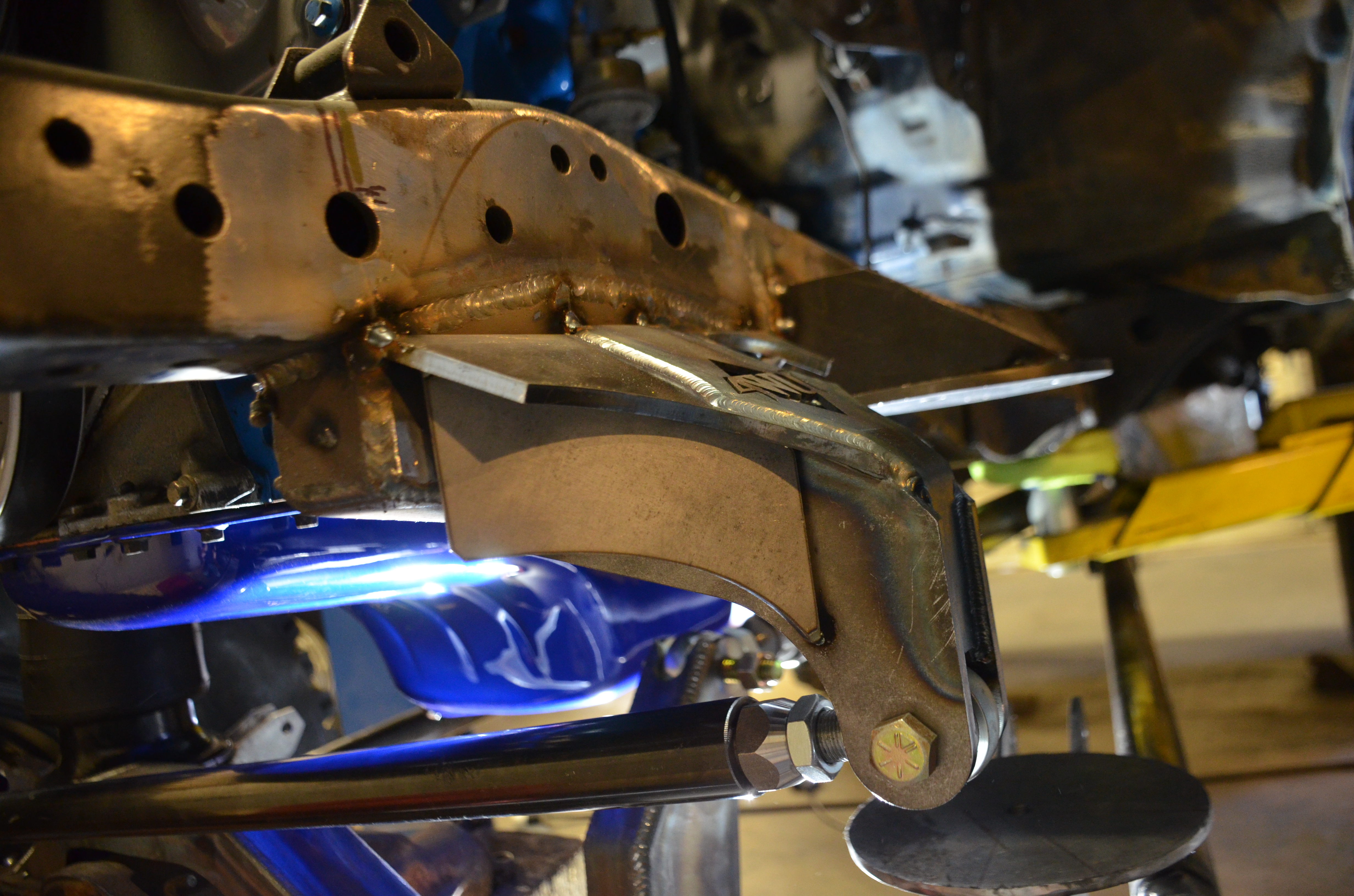

Brian traded me the late 90's frame side pan hard for a 80's one so could have more drop

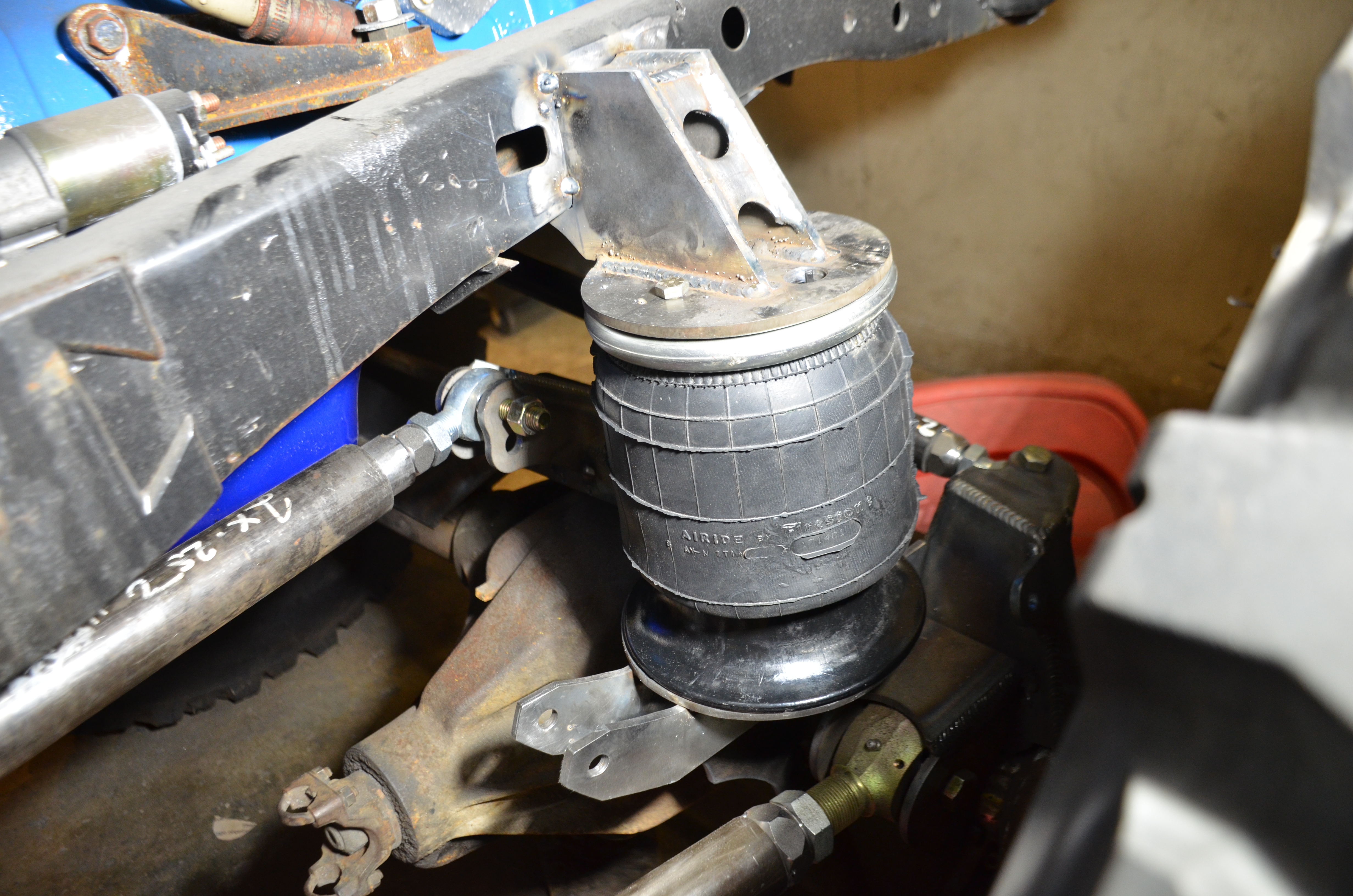

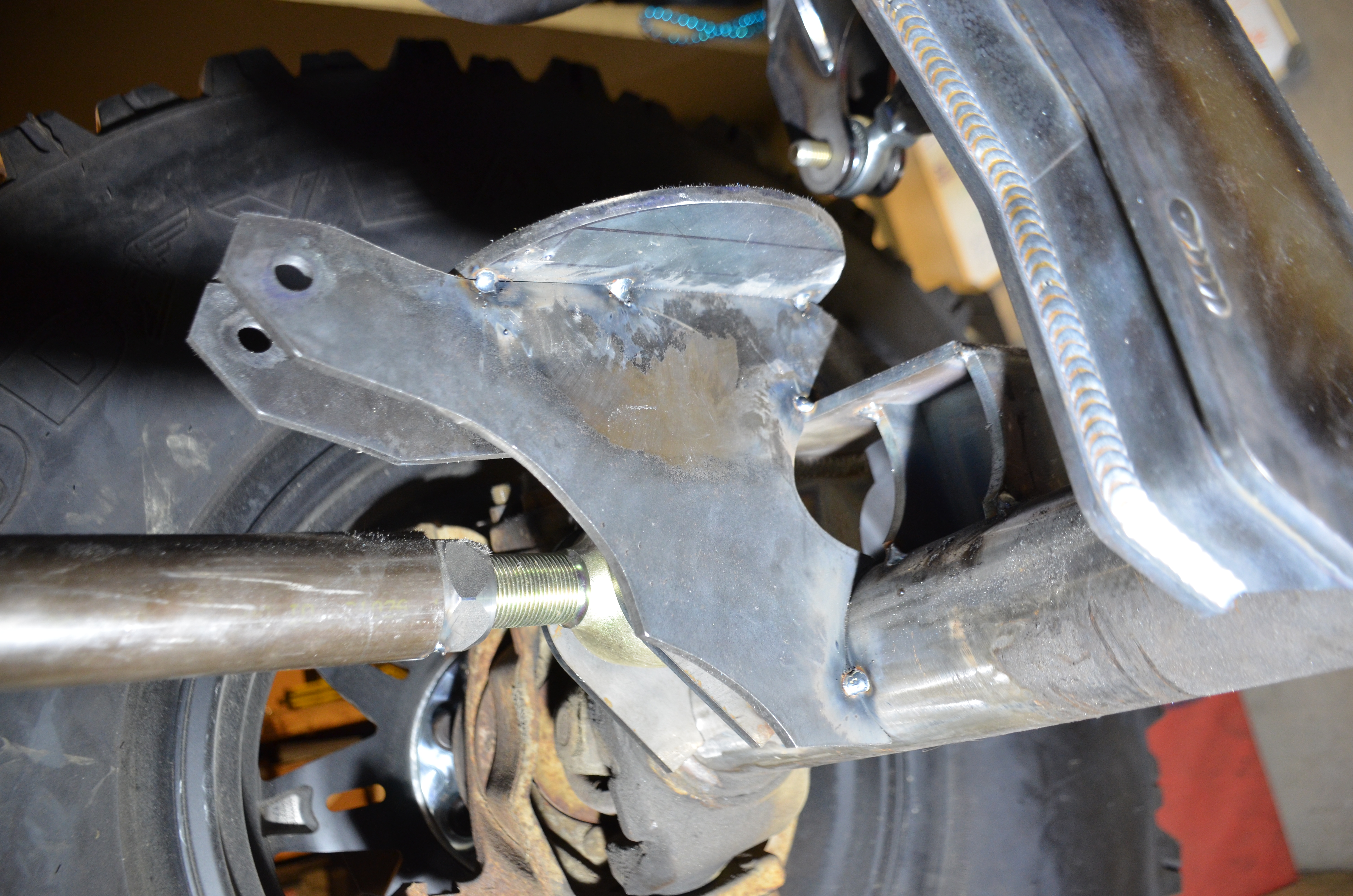

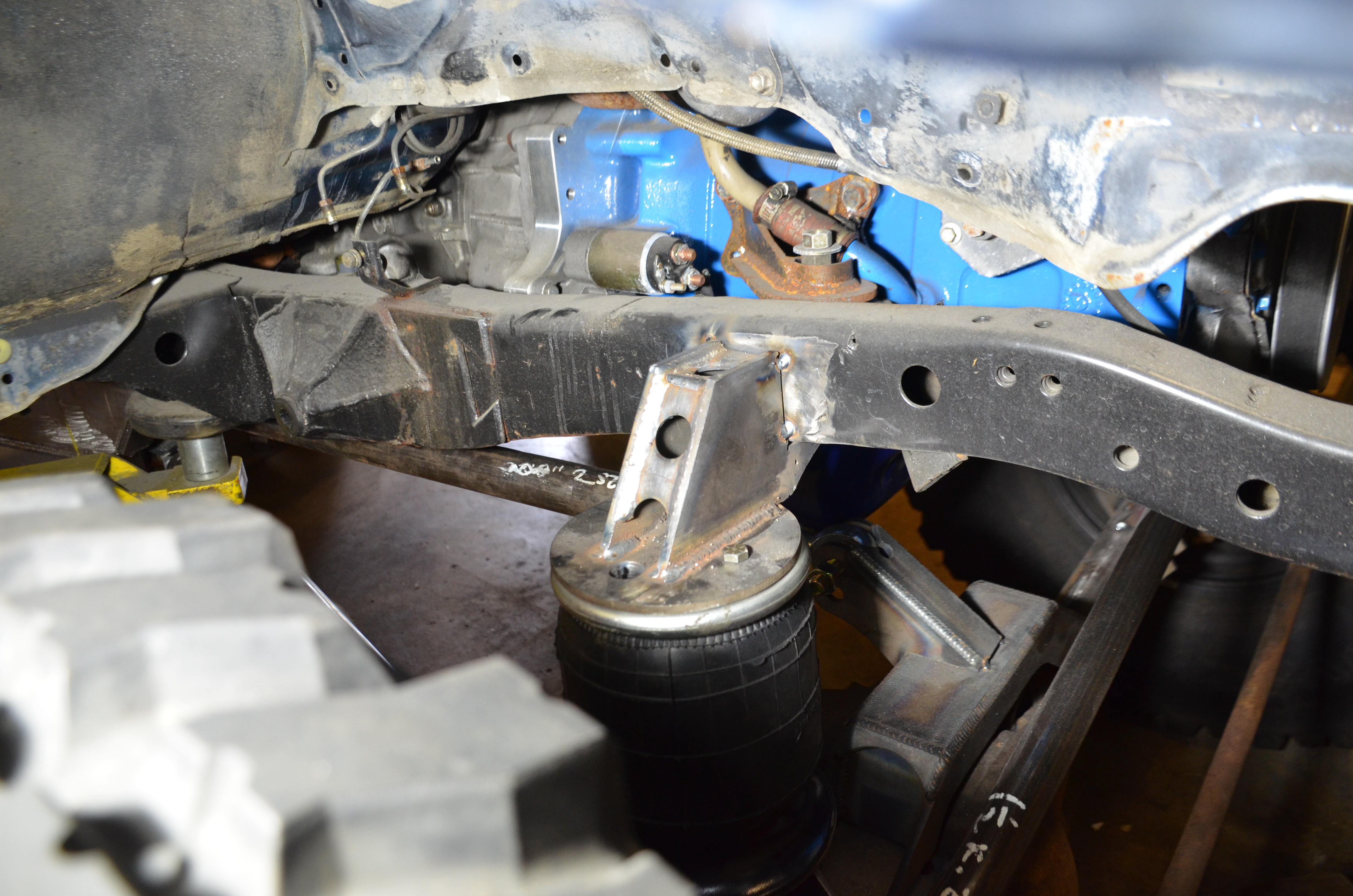

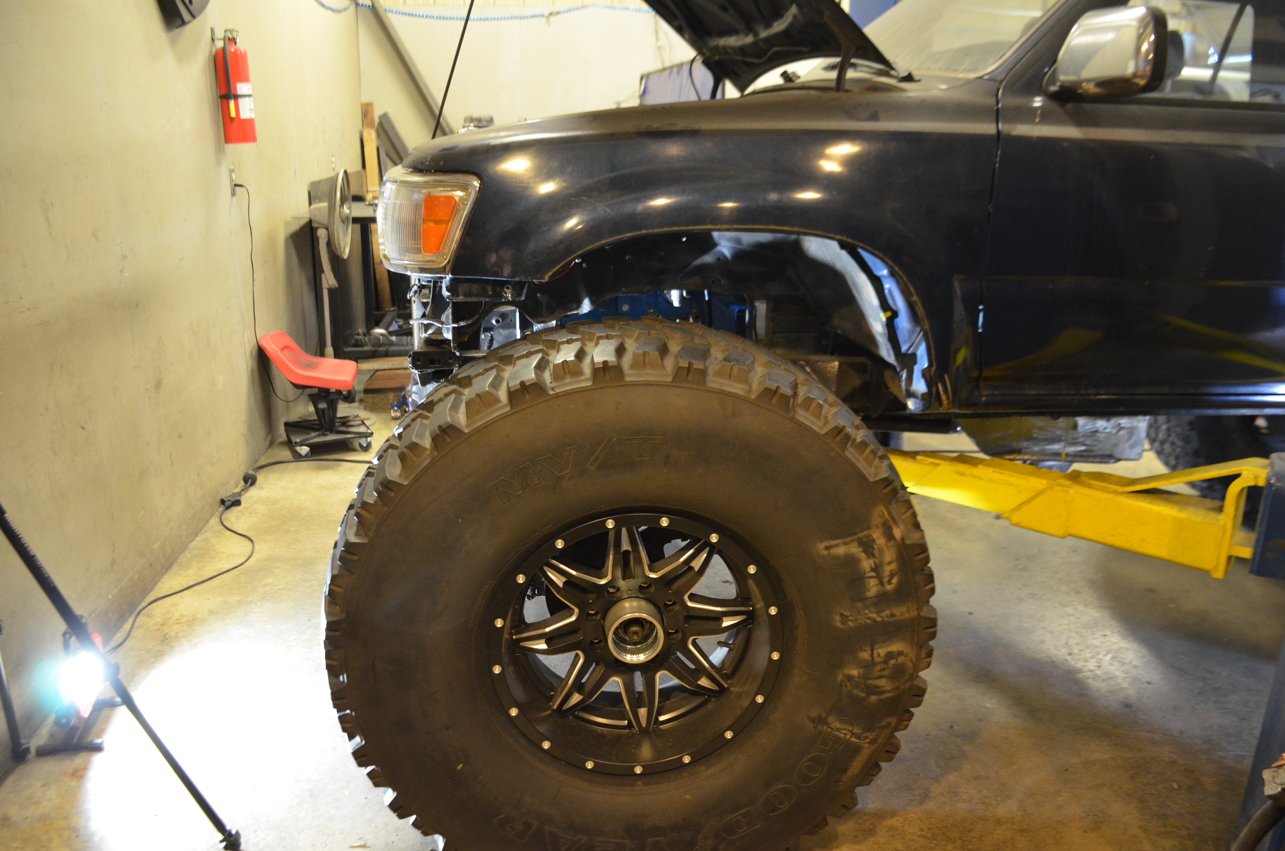

Finished the passenger side upper bag mount
Old Jul 20, 2016 | 07:54 PM
  #91
CougarHouseGarage's Avatar
Joined: Jun 2013
Posts: 205
Old Jul 20, 2016 | 07:55 PM
  #92
Joined: Jun 2013
Posts: 205

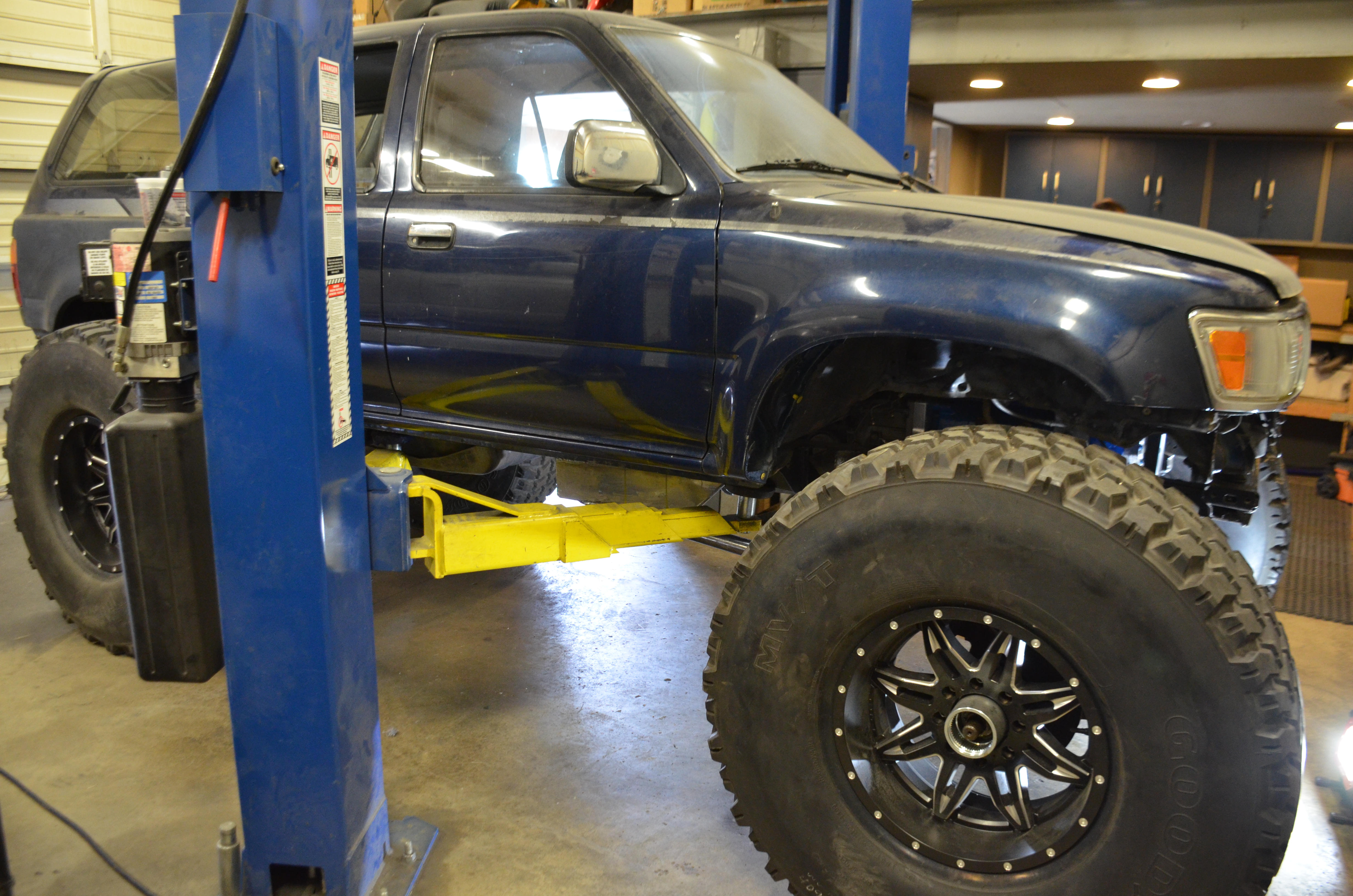

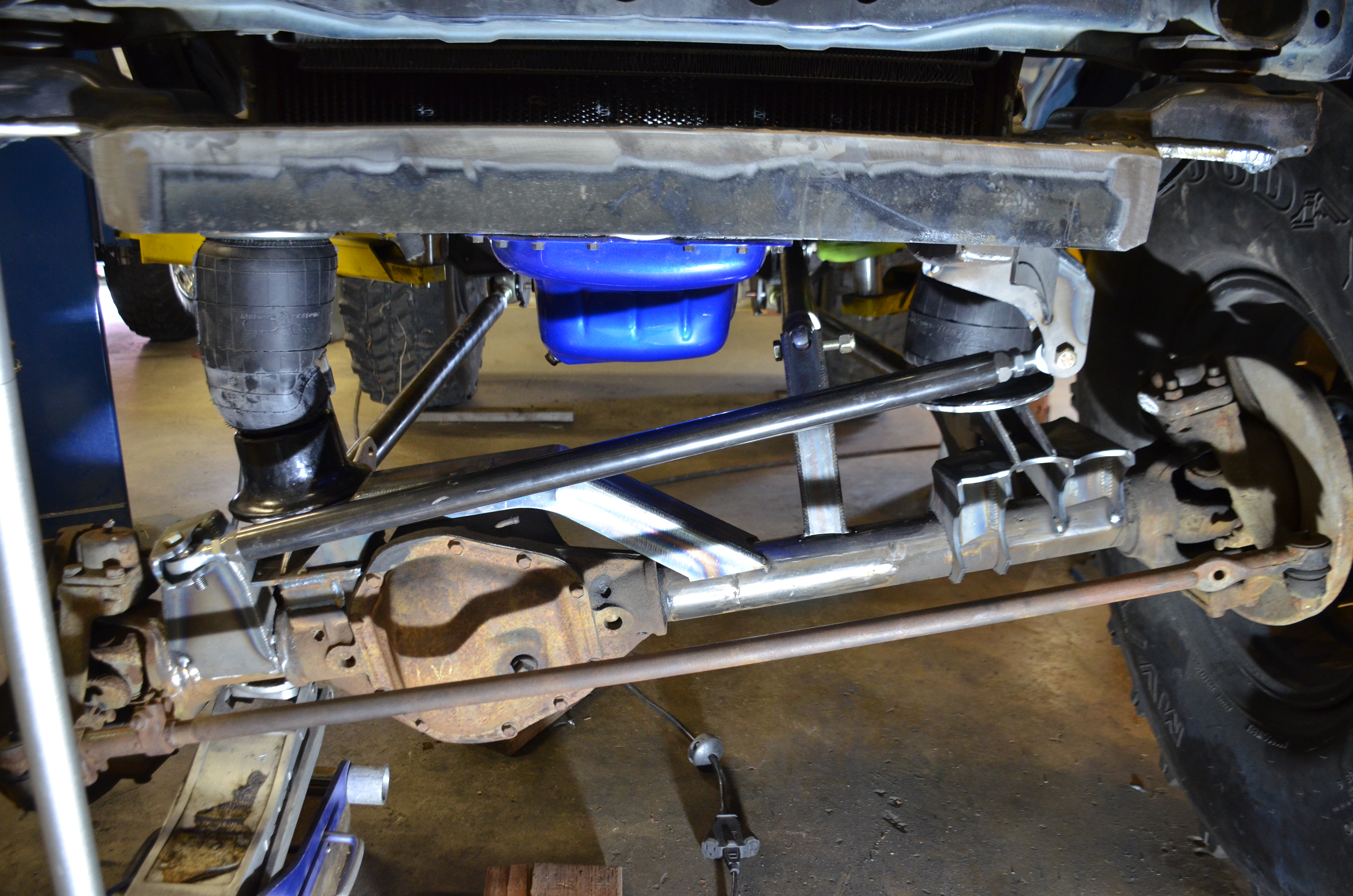

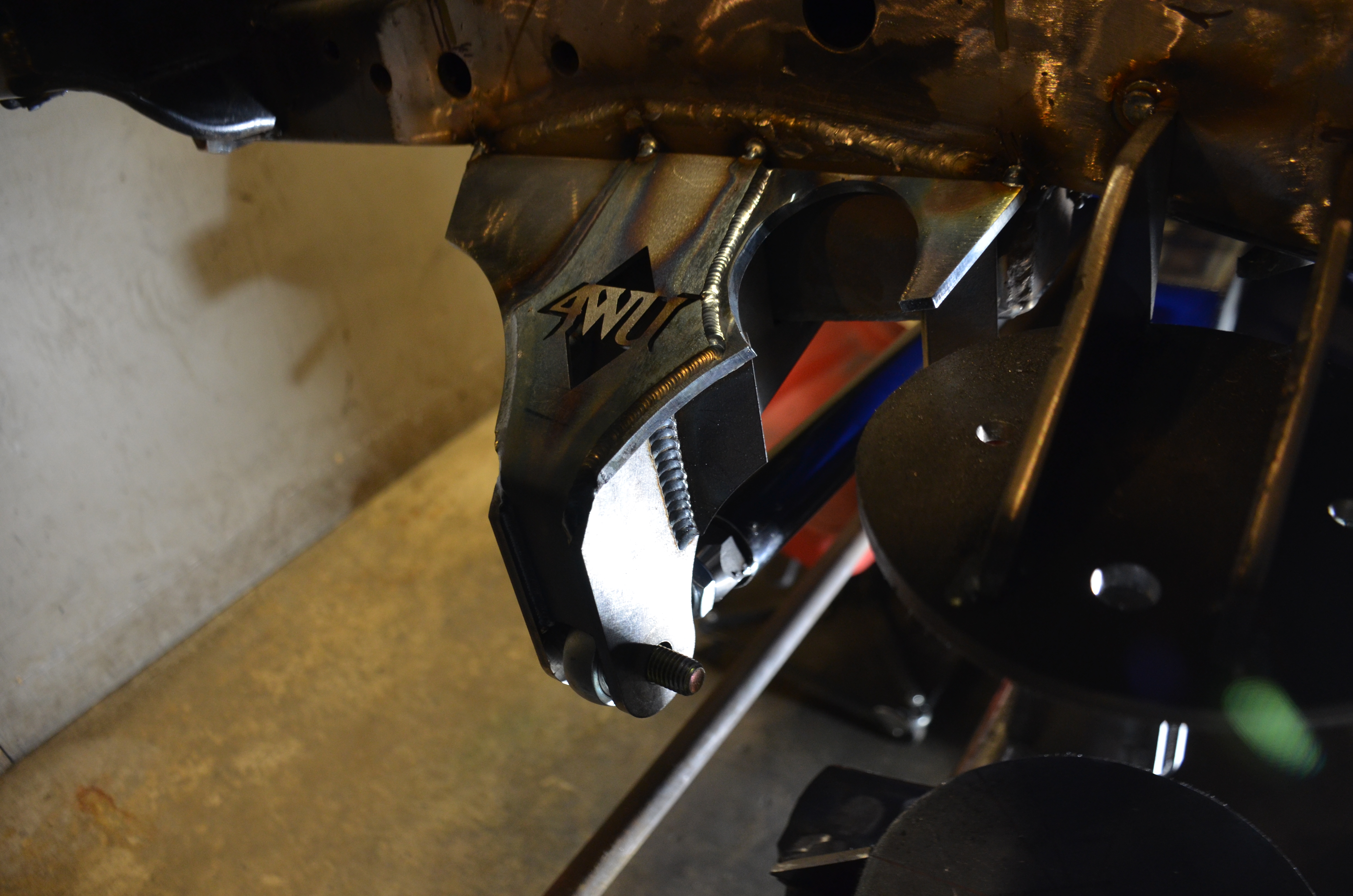

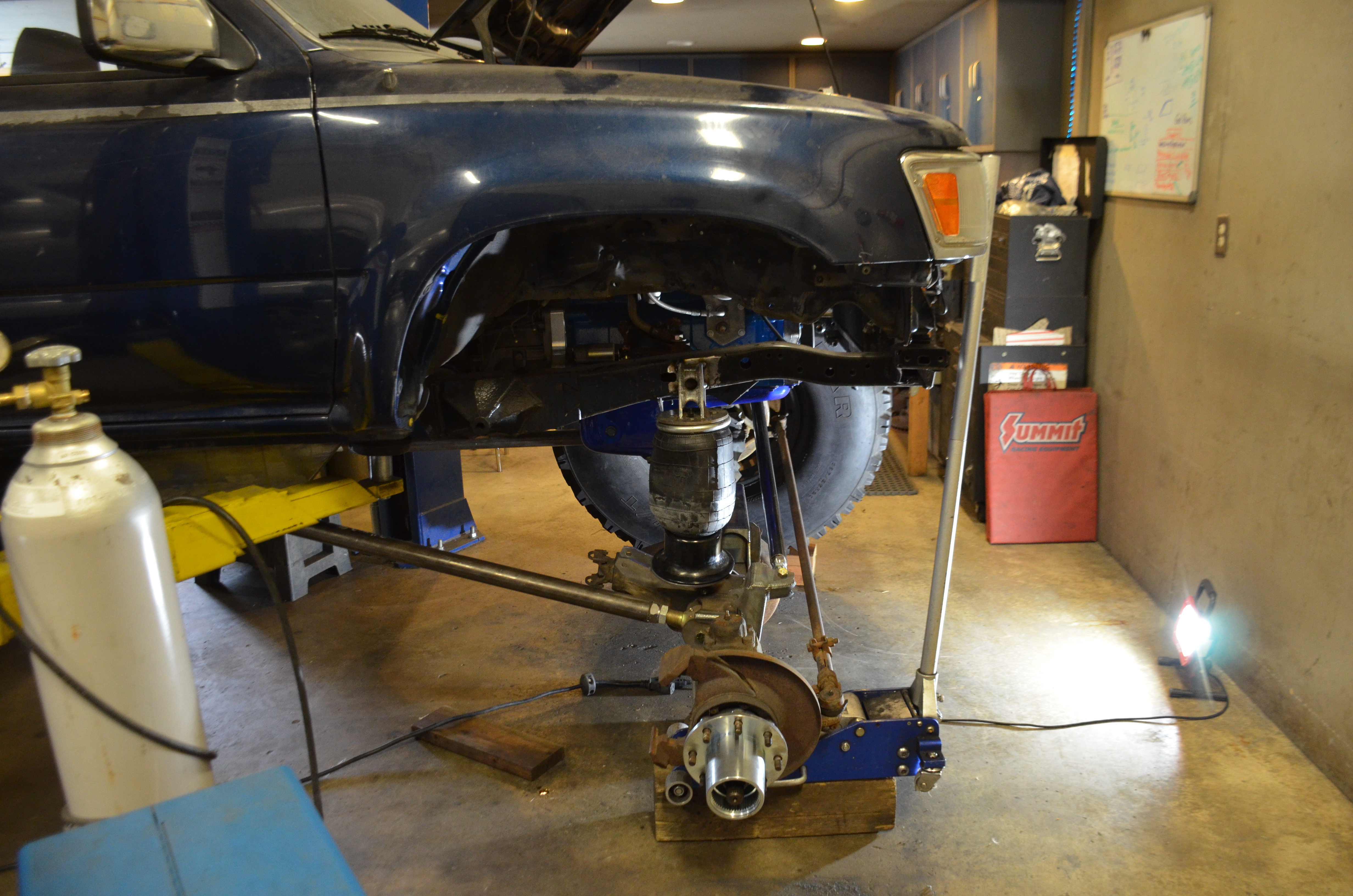

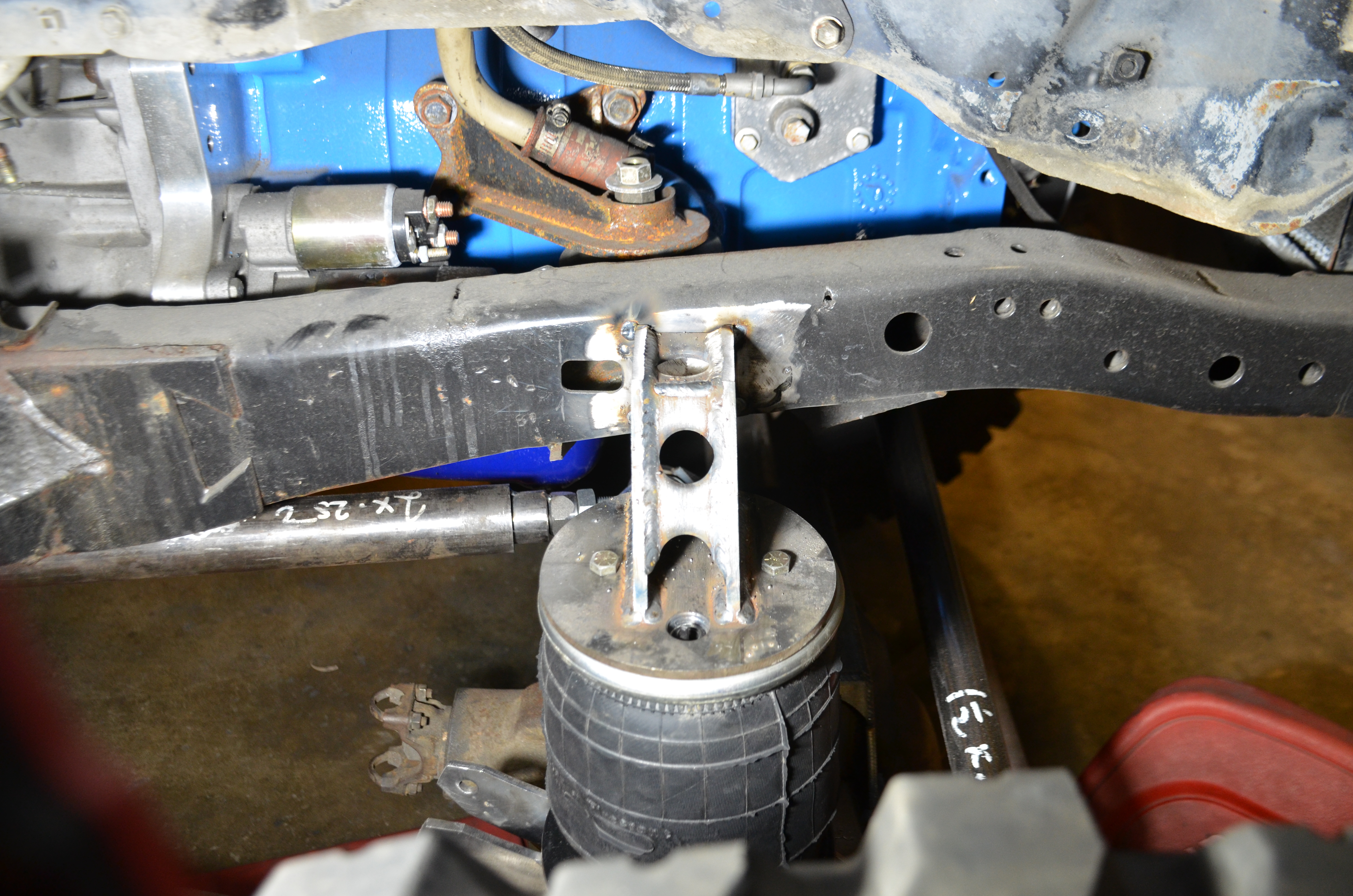

The 80's frame side pan hard bracket decreased the pan hard angle quit a bit and the driver side 3rd link freed up the passenger side for the drive line
I forgot to measure how much drop there is I will soon for you bro's. That's all the drop I need lol

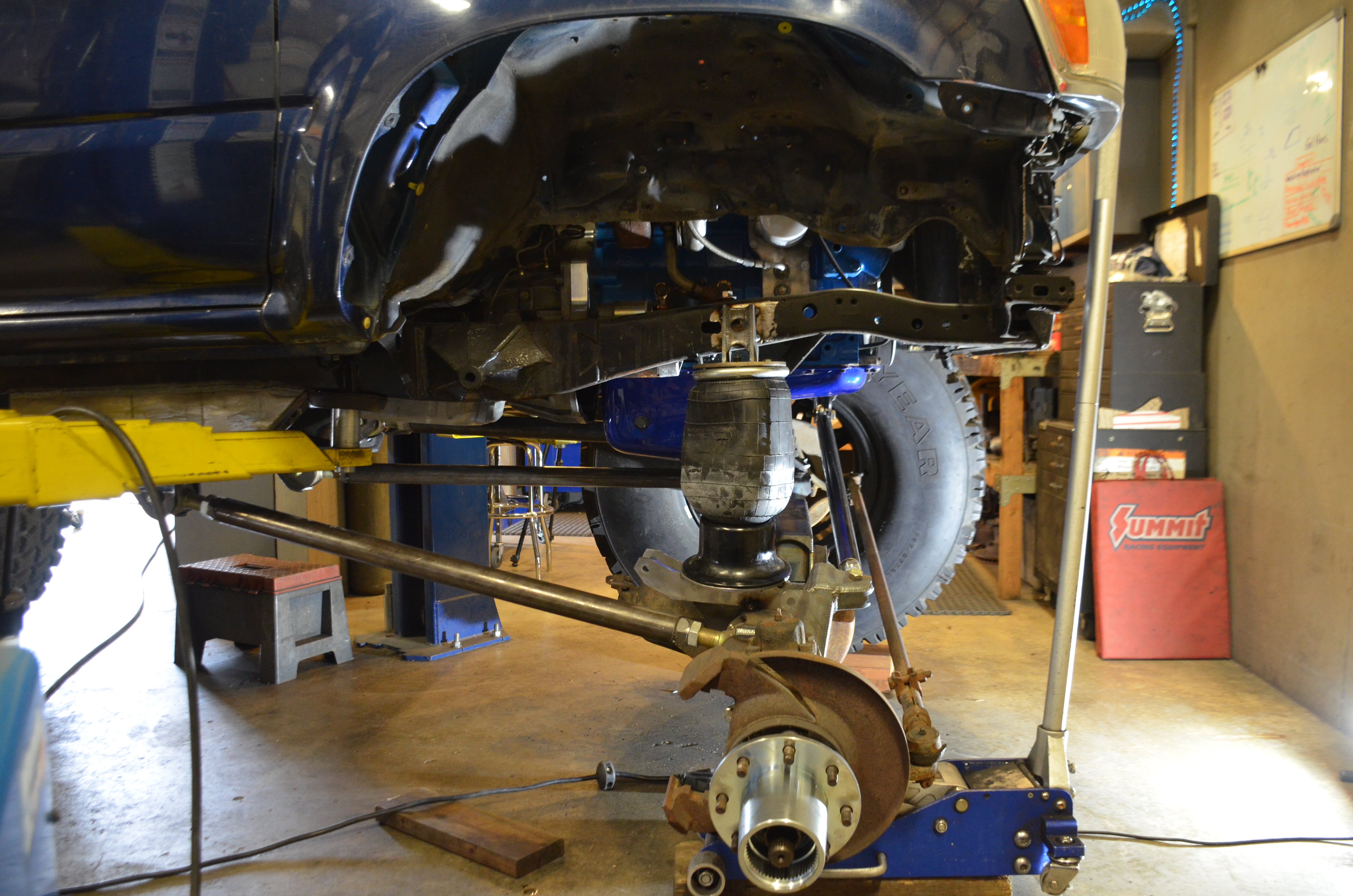

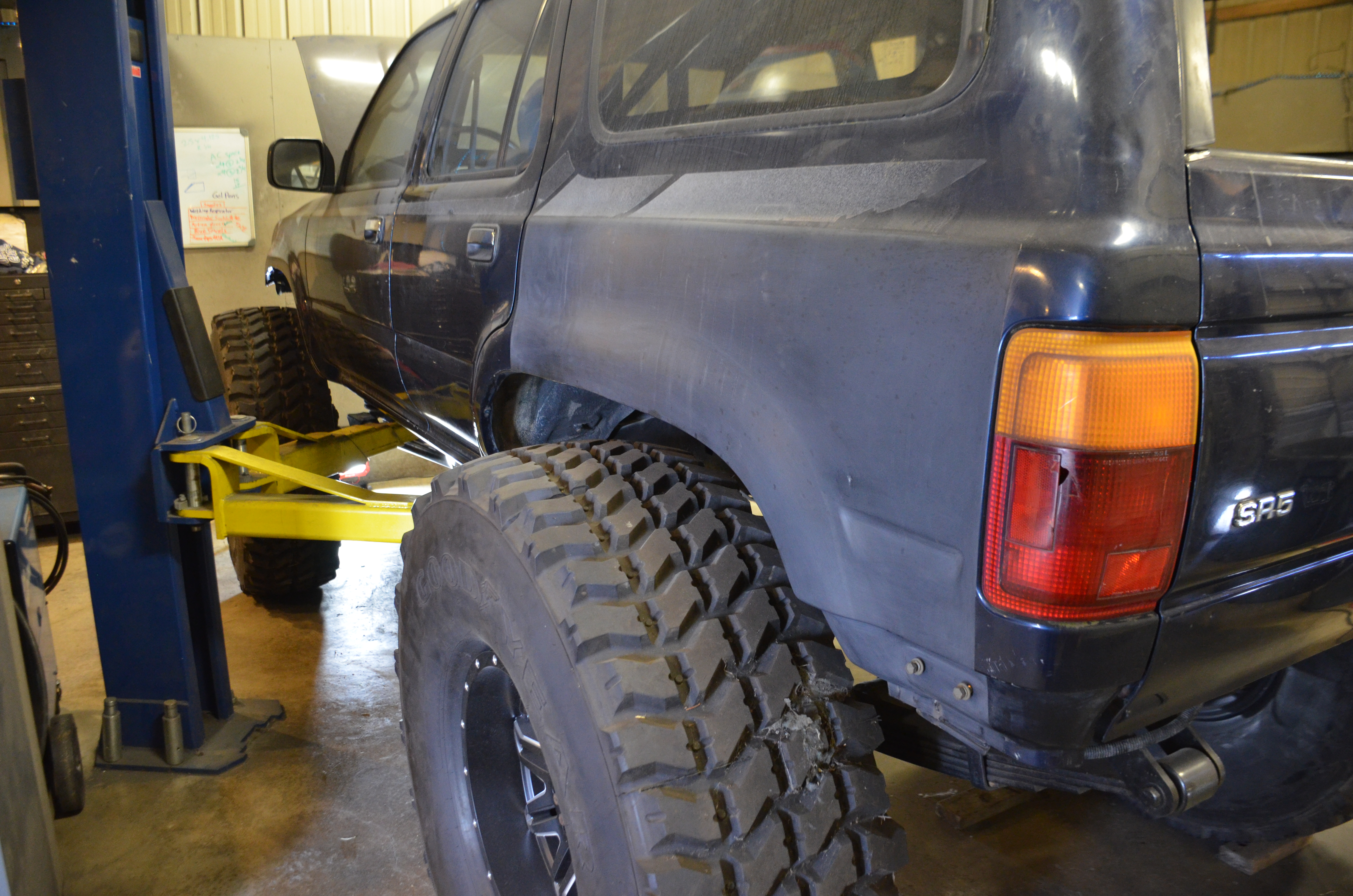

Ride hight
