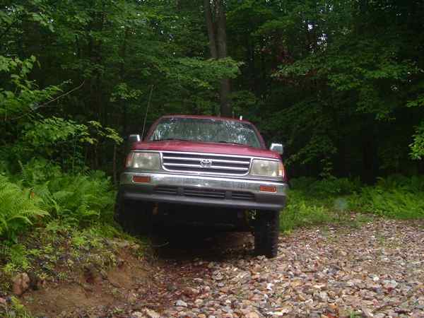

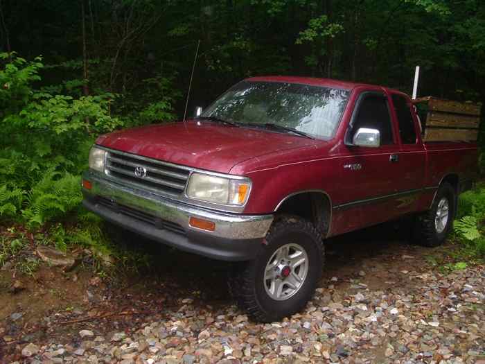

Thanks for the comments guys, the folks really like it...mom can even drive it comfortably and easily!
I went w/ the shackle lift because I didn't like those puny stock ones, an AAL would have worked just fine, but I also wanted a very slight lift, nothing more than 1", even less and that's what the shackles did just fine. We might have to AAL if we end up putting heavy loads in the bed, we'll see.
Here's pics of extending the spare tire holder arms, as the 33" wouldn't fit without it. I just did the rear part, and it sits up there nice now.
Also, I've since added Low Profile lower control arm stops in front, for added UP travel. Down travel is limited by the stock bump, don't want to go too far down w/ the BJ spacers in there. CV angle is just about stock, truck height is about 1/2" higher than stock after letting the torsions down a hair w/ the BJ spacers.
New sway bar end links and bushings were also installed, the old ones were rusty and needed to be cut off. Now it's real easy to unbolt one side for trail flex. I need to post a pic of the OME stabilizer install; it needed a universal bracket on the draglink.
