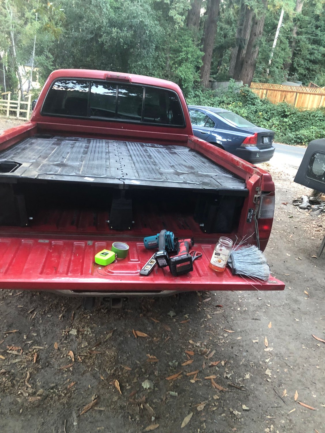

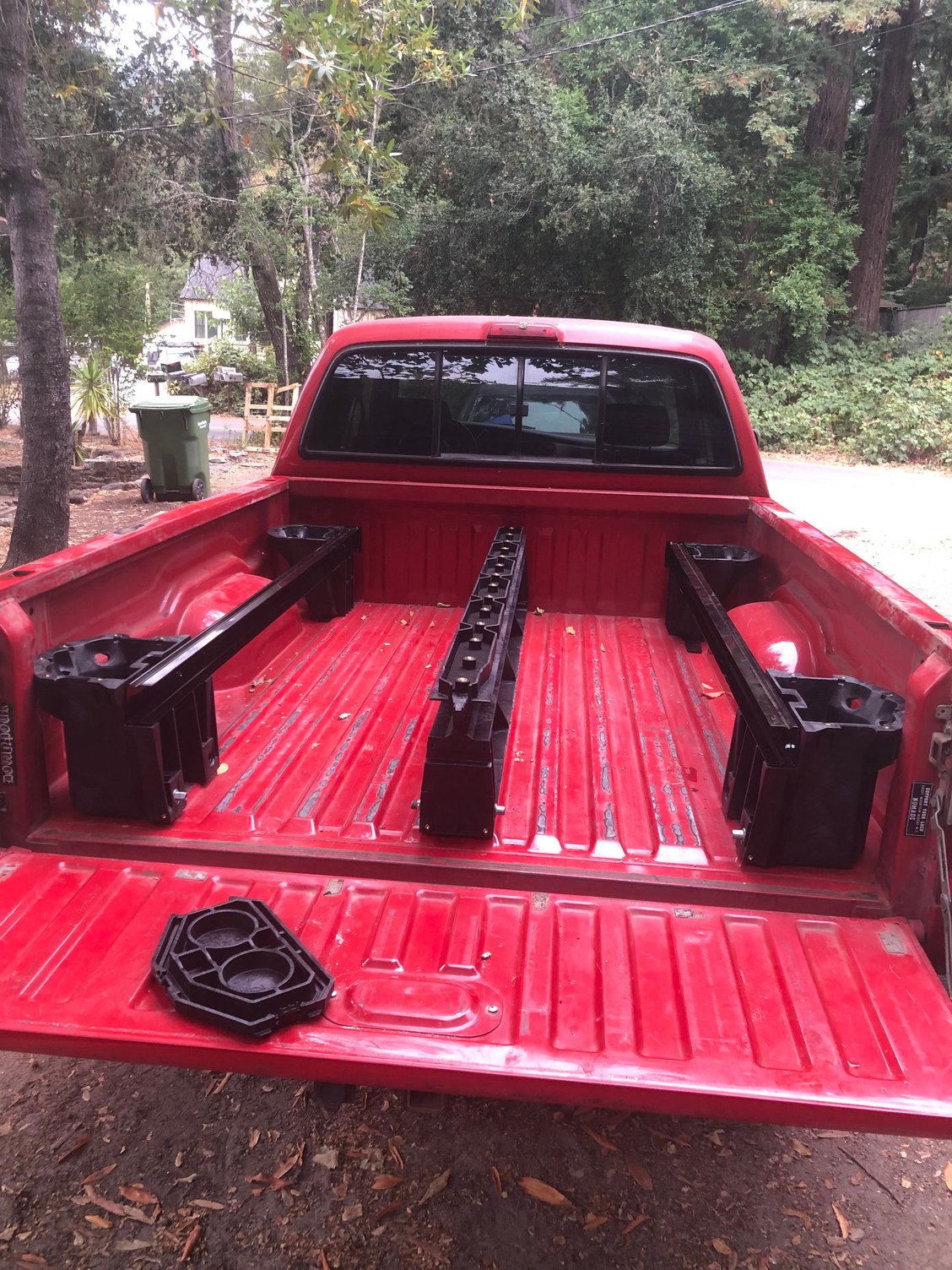

It’s done! Used decked drawer system for Ford Econoline Ext van. Took lots of time and precise measurements. Used cardboard jig. Fits like a glove. Found out from a 1st gen Tundra forum. I wanted to get the 2 wide drawers. Cutting the sides to fit the bed in fractions of an inch. Will include pictures
Centered the frame

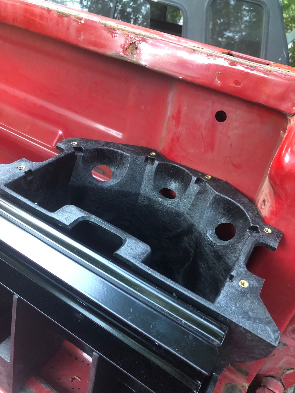

Trimmed the supports without damaging the mounting holes
Used cardboard as a jig

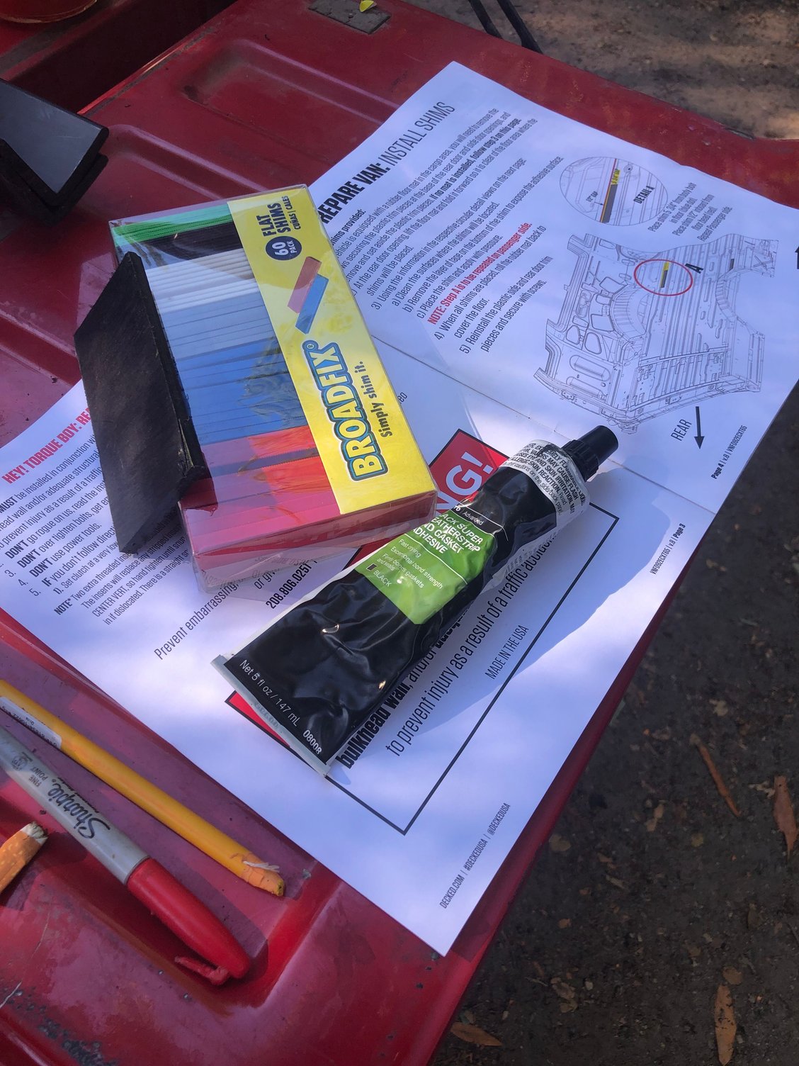

Had to shim the side supports to match the floor ribs
Fits like a glove and saved the ammo cans. Lids snap in perfectly. Had to install D rings and modify J hooks for securing to corners.
