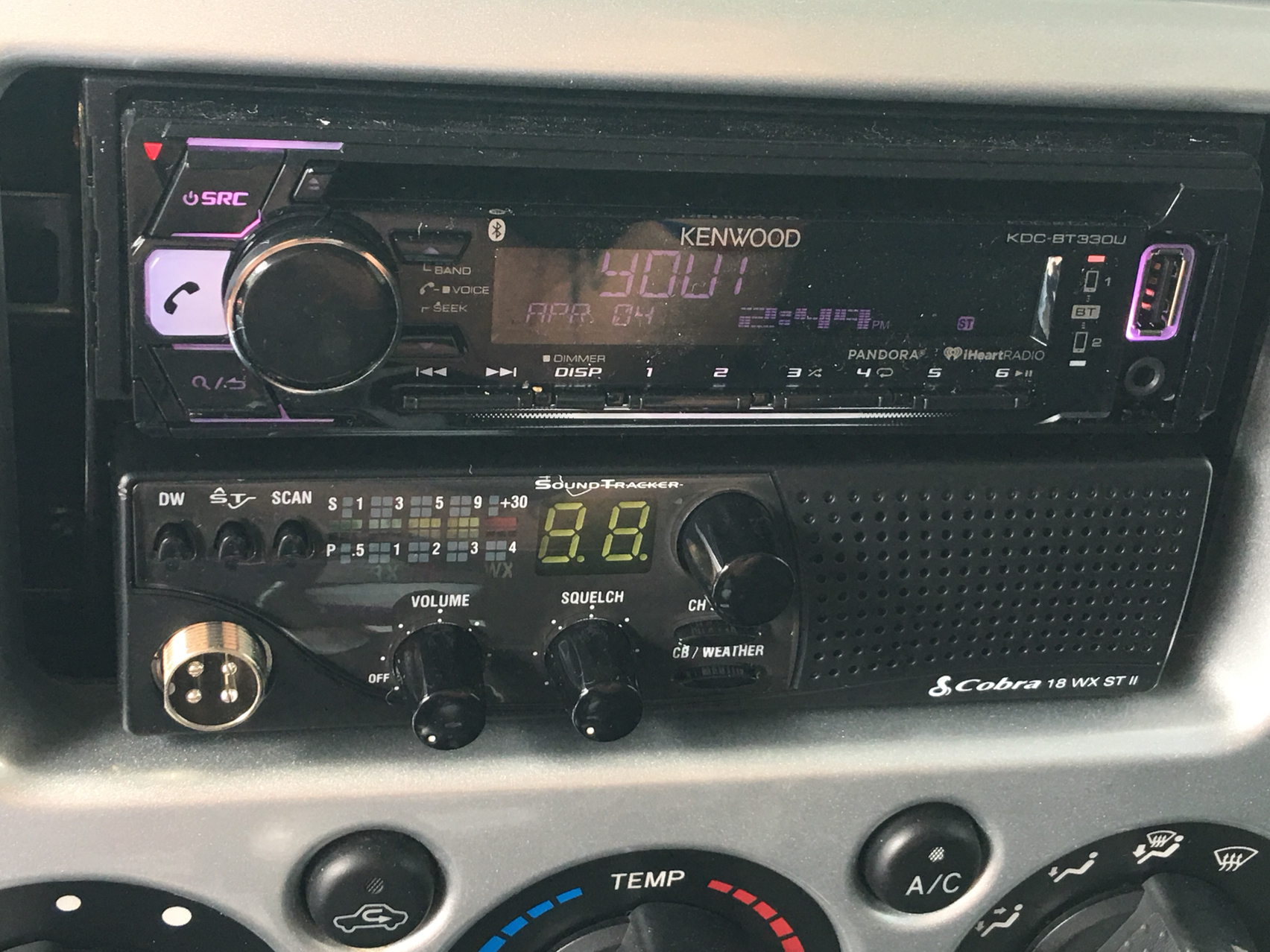

On a brighter note, the factory stereo head unit had been replaced by the PO, in sure the unit they installed was a great unit in its day, double din, touch screen, GPS etc etc, but no Bluetooth, aux input, or USB port which are all features I've come to rely on.
So this happened
Just an inexpensive single din, but with the features I wanted, it also opened up a spot for a CB radio because every good 4x4 has one right.

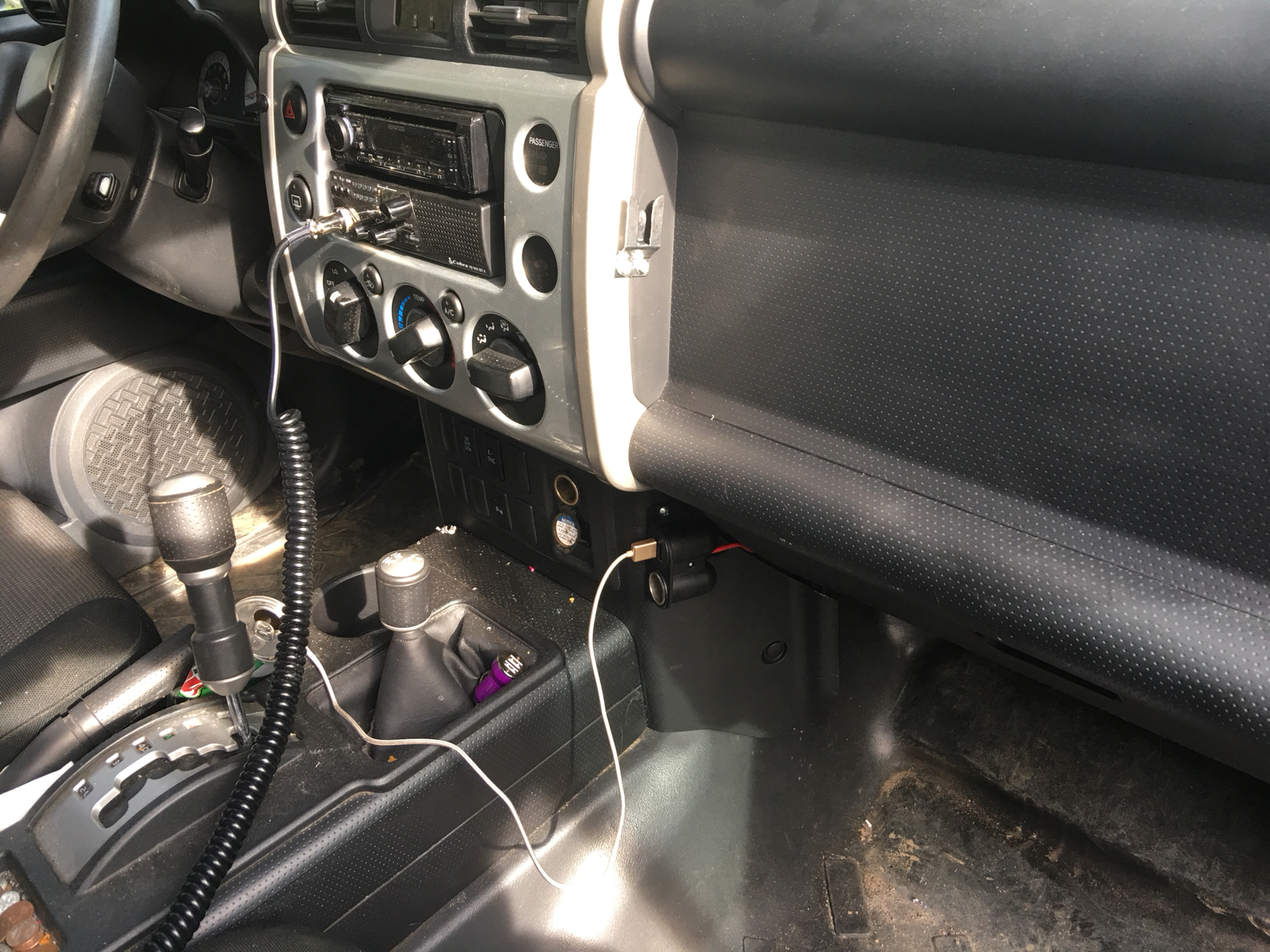

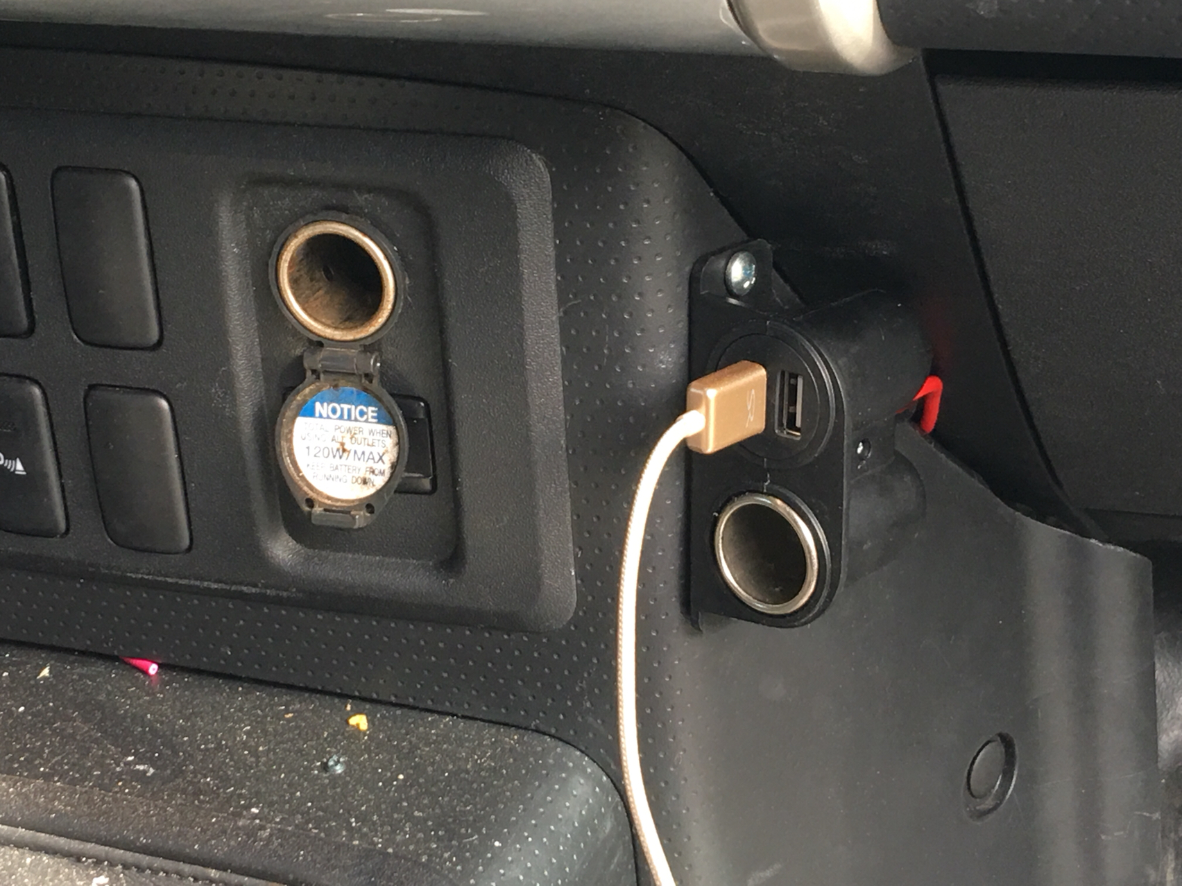

I also finished up the stereo and cb install. Ran new coax for the cb antenna, mounted the mic for the Bluetooth etc. also do to Toyotas inability to install a 12 volt accessory plug that stays hot with the key off I added one with a plug and 2 USB ports.
Wiring up this new stuff was super easy because of the auxiliary fuse block under the hood, this is something I have wanted to do for awhile on the 4runner and it's definitely moved up the list.

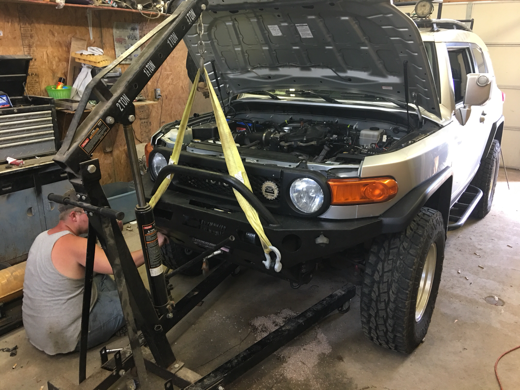

I also decided to dig into the winch, I have not been able too get it to work and getting to it meant removing the bumper, I was pleasantly surprised how easy that was.
I got the winch working but in the process I broke a stud on one of the solenoids and had to order parts, I decided to swap over to the new style relays and move them from behind the bumper to under the hood, hopefully the parts to do so will be there when I get back home.

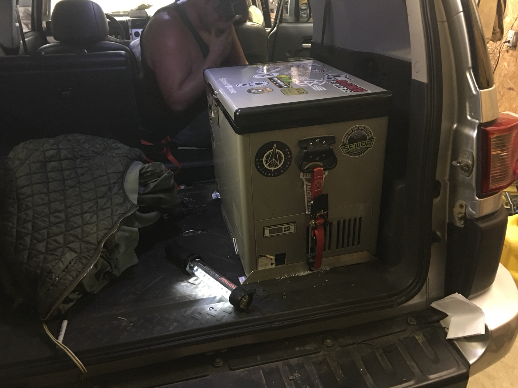

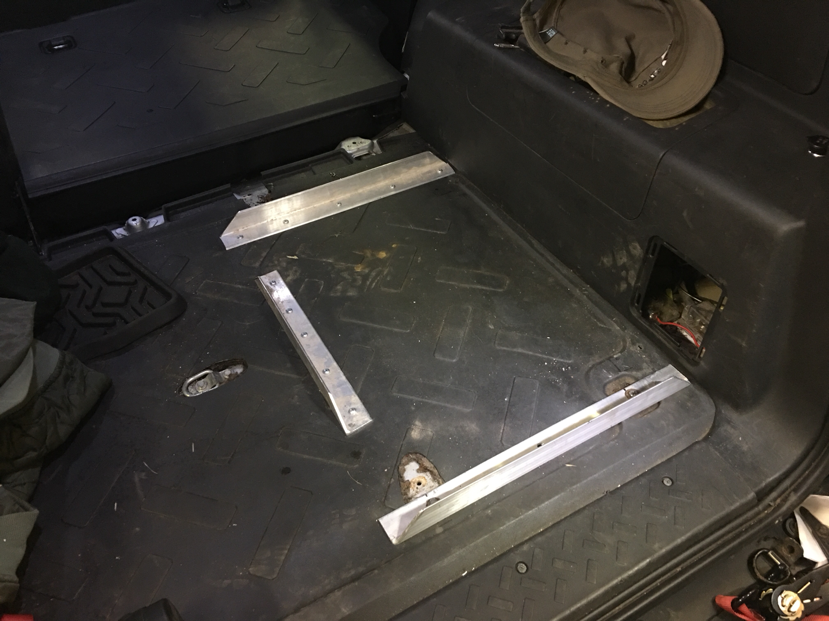

Because I have become accustomed to having it and to cut down a little on food costs, I wanted to have my fridge with me, so I took a few minutes to put together a simple mount and add a 12 volt plug in the cargo area. For a mount I just used some aluminum angle I had laying around and made a frame for the fridge to sit in.Jason's 07 FJC-photo876.jpg
I just screwed it directly to the floor, not the perfect solution but time was tight.
For the plug, the po had already had a fridge installed and most of the wiring was still there, he had hard wired his, but because I want to be able too move mine between the FJ and the 4runner I just want to be able too plug it in. Didn't get any pictures of the plug etc again time was tight.
