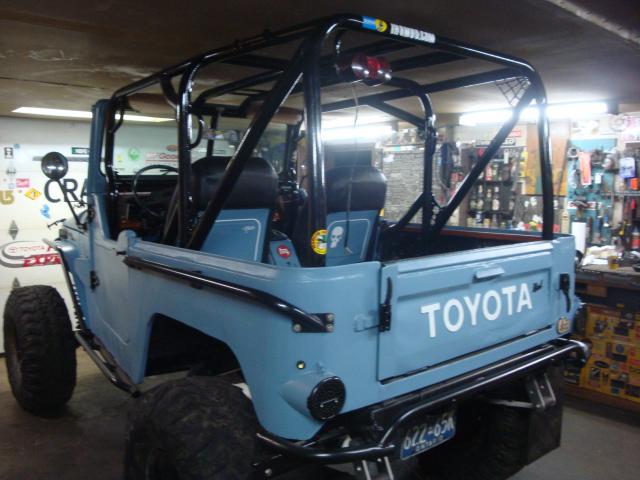

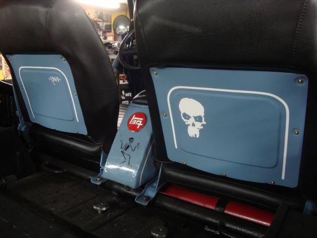

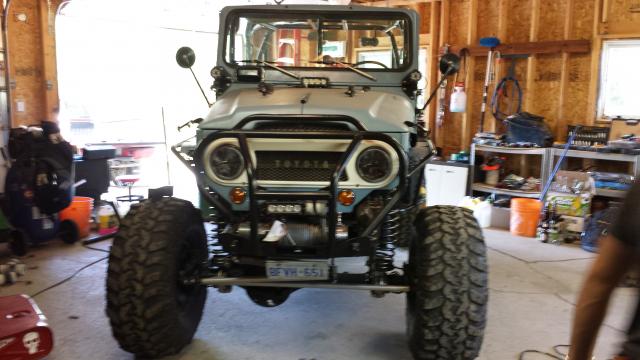

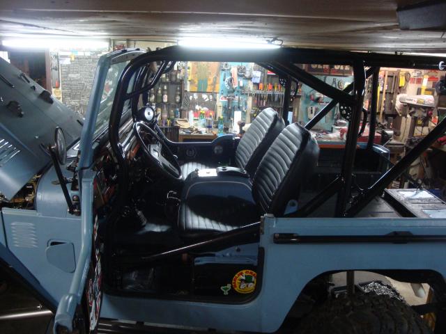

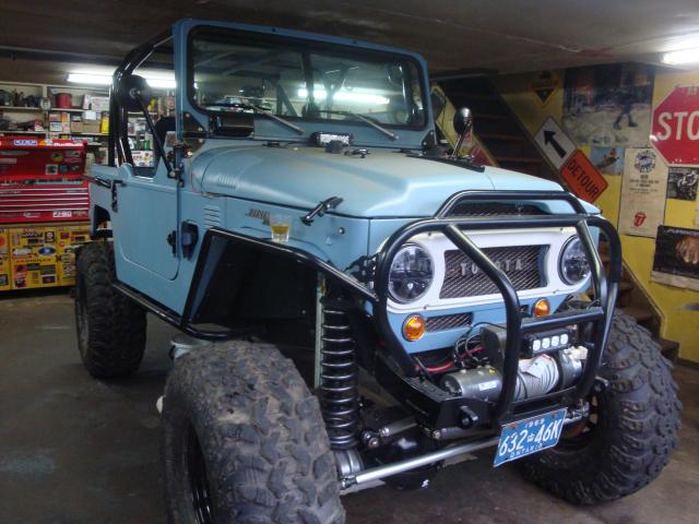

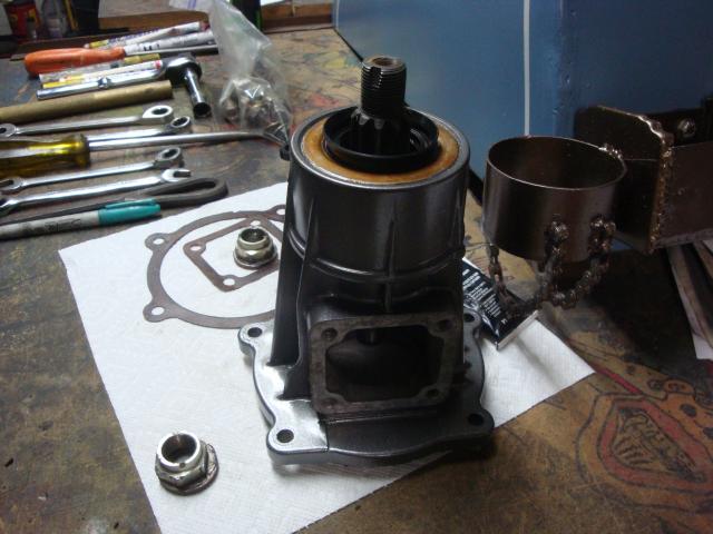

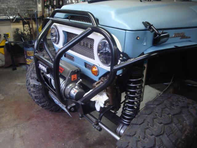

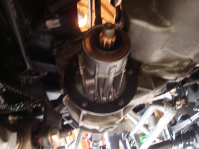

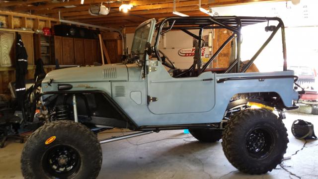

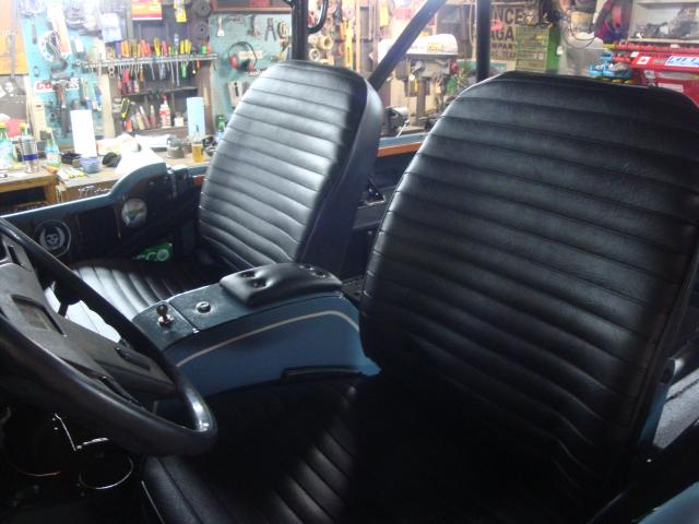

Bit more junk off the list. Winch is on, front license plate bracket is made, transfer case nose cone is swapped out to a non cracked one with a new seal (just waitin on a couple braces from a dude on mud to finish reassembly), seats are redone and installed, front ps brake line has been lengthened, the cruiser lean has been somewhat dealt with....
Probably forgettin something. Hopefully gonna drag it to my buddies to get wired today sometime.

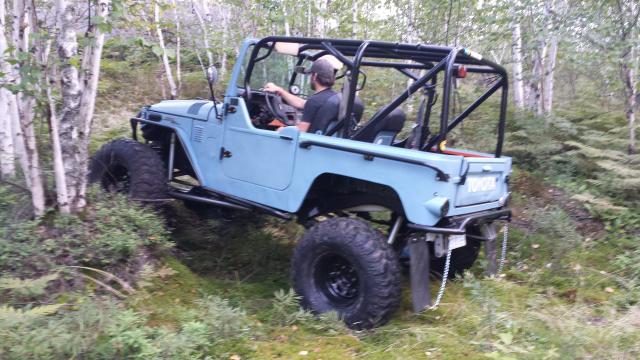

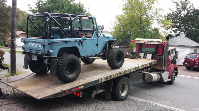

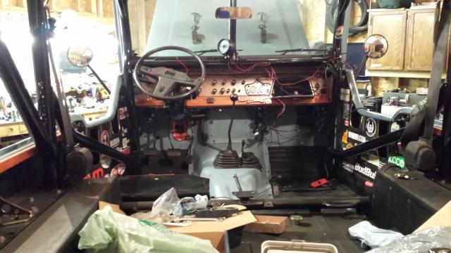

Couple pics of the 40 at petes place.

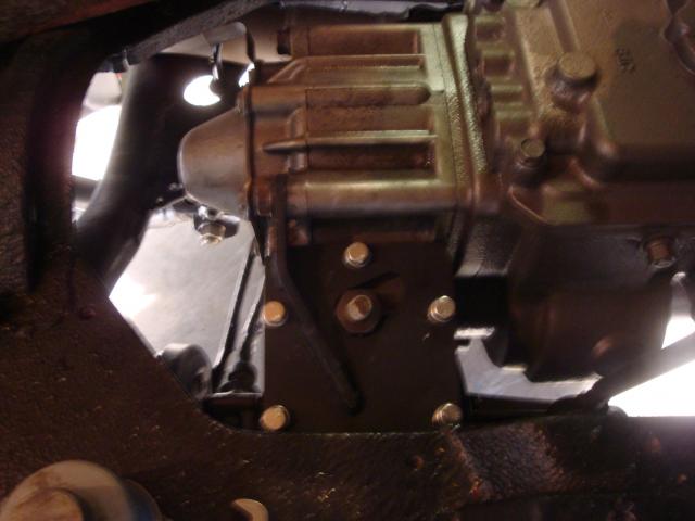

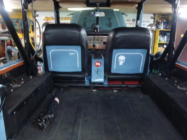

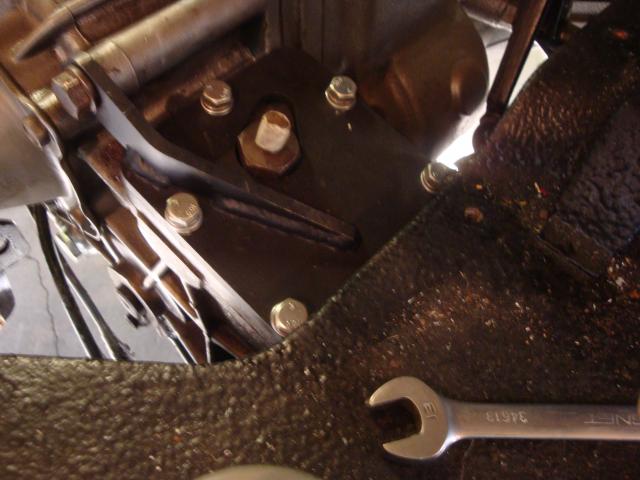

Went for a rip out there yesterday and got both transfer case braces installed, the front drive shaft put back it and the skid put back on. Had to rip out the interior and the gas tank to get at the tranny hump to put the top brace on but 75% of that stuff had to come out anyways to make it easier for pete to wire.

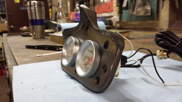

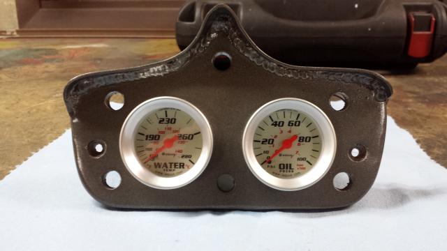

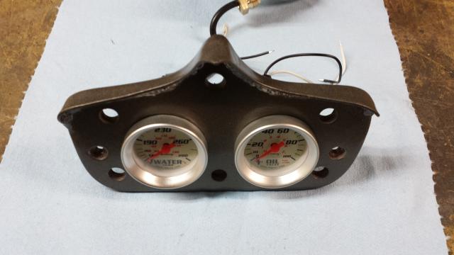

Made up a little gague house the other day as well and threw it on. Holds the temp and oil pressure and fits into the stock ash tray hole with no extra cutting or holes. Dont have a pic of it installed.

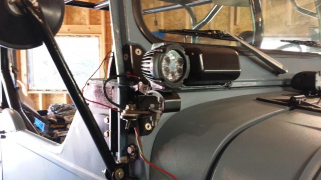

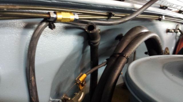

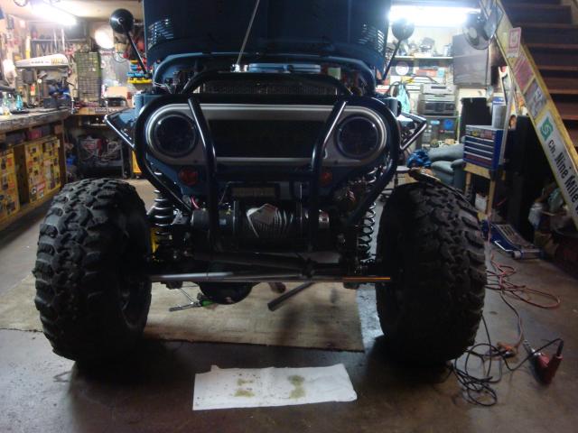

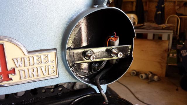

Went out to Petes again yesterday and got some crap done while he was doing his electrical surgery. Mounted the led windshield lights I finally talked myself into buying, extended the transfer case breather vent up to the firewall, swapped out a heater hose that was too short and was in the way of the defrost vent pipe, and probably a bunch of other stuff Im forgetting. Pete was workin on the tail light wiring and he threw on one of his fancy plugs on the rev light switch I forgot to put back in the trans. Threw that on with a generous amount of sealant.

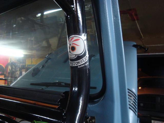

When I built the windshield hinge mounts for the aux lights I made a thick washer out of that self lubricating plastic to use at the pivot. Turns out I can have the mount all tightened up and still pivot the light 180* so they face backwards. Kinda cool to be able to point em on the fly without tools.

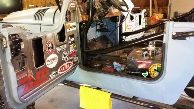

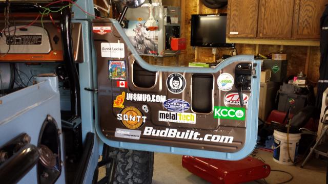

Sticker bombing campaign of the half doors progressed a little... lol.

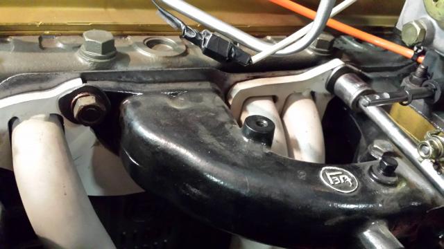

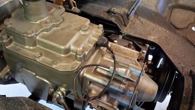

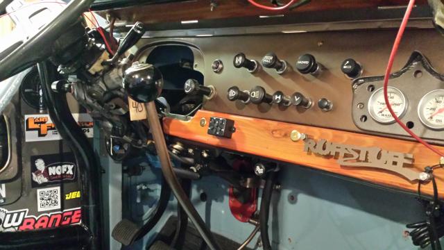

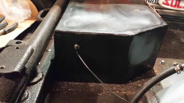

Randy jumped in with me yesterday and we went out for a rip to Peeties to mess around with the 40 again.

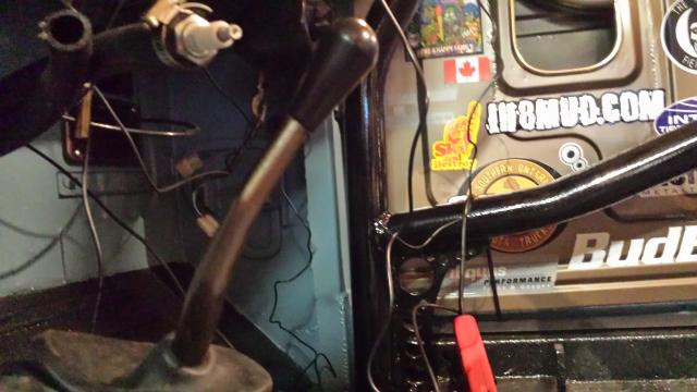

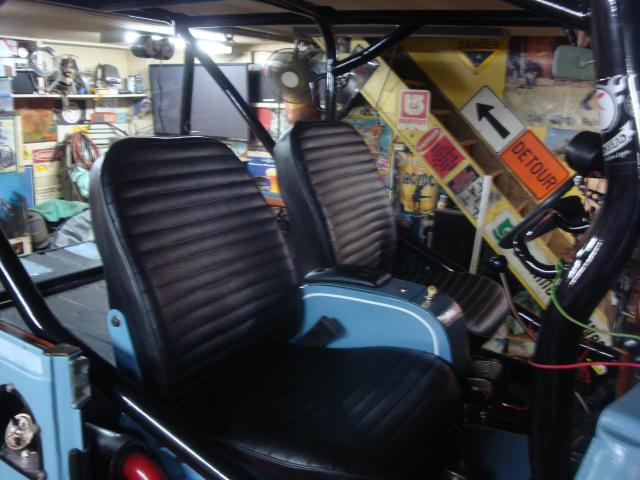

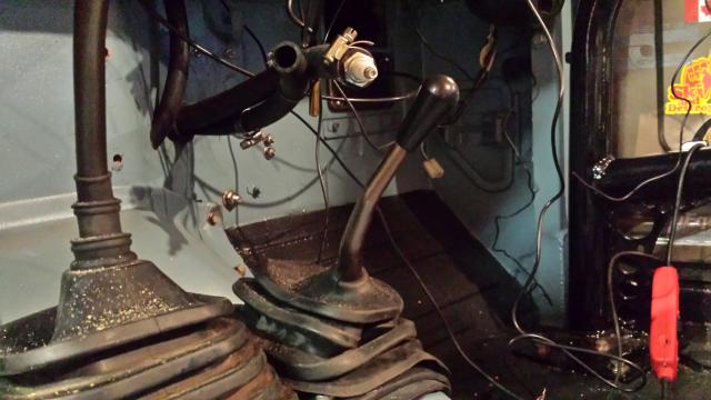

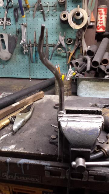

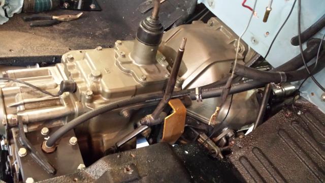

I had bent up my spare transfer case lever couple days ago to get it away from the passengers leg so it got swapped in. Cant really tell without the seats in but it does look to be a lot closer to the trans shifter than it was stock so hopefully it tucks in better and is no longer protruding into the passenger foot well while in the low gears. Peetie made up a fancy pig tail for the trans reverse light switch so that got routed up the passenger side of the trans following the breather hose and the trans tunnel got put back on hopefully for the last time.. The top transfer case brace made contact with the tunnel so that had to be massaged, might still be some contact but Im sure itll self clearance.

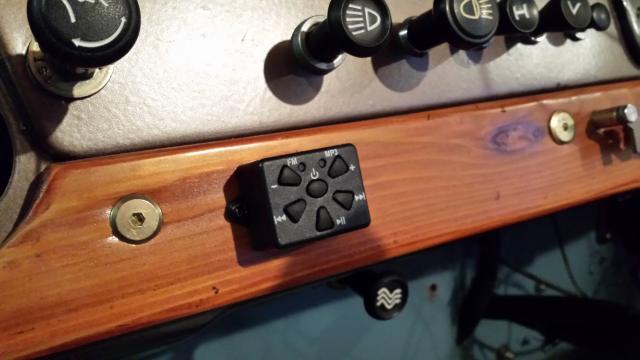

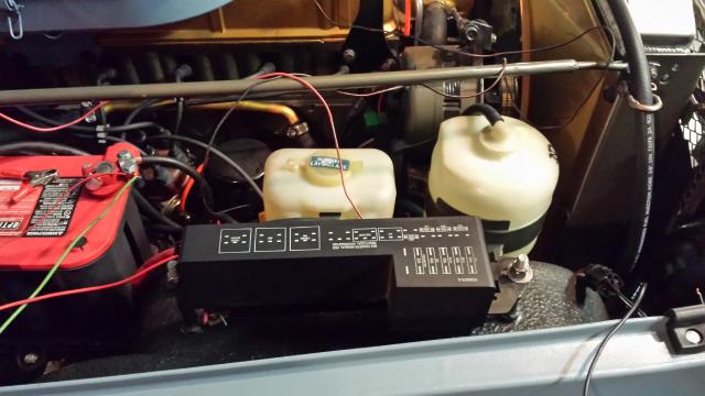

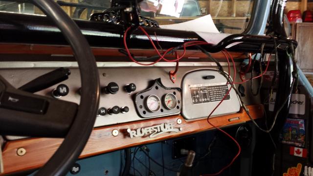

Bunch of little stuff got done, we routed the wiring for the 3rd brake light and ran a loom from the back of the van to the front, hooked up the stereo just to test it out and it sounds allright. Probably wouldnt be high enough quality for a serious audiophile but its good enough for me man. Seems like it could use a small sub maybe to round out the sound? We didnt really play with any of the settings so maybe it can be tuned a little. It turns out the mofo does have blueteeth man, had tunes playin all wireless like for a while lol. Installed the wired remote on the dash mounted to the wood under the pull knobs after Randy rerouted the wires so they came out the back of the unit instead of the top, turned out pretty clean and easy to access. Threw an led light in the stoosh box under the ds seat and installed the intake/exhaust manifold washers I made up to try to get rid of a leak. Custom pontiac sunflower fuse box got mounted on the ps inner fender with some mounting studs I threw together, fits pretty mint and is easy to get to. Wires come out pointed right at the 40 pin connector in the firewall to boot.

What LED's are those? Link? I like the mount idea.

Thanks man. The 60 build is somewhere in the 60 section and is called something like "new addition 85 fj60", the 80 is in 80 tech and is titled " 93 80 beater". Pretty sure the 80 build is closed but you can still see it all.
If youre askin about the windshield hinge lights they are hamsar spot/flood combos. 77 bucks each at maslack supply, have a set on the 60 and besides lookin all cool they are pretty bright man. I just love the way they look though lol. This things not gonna be lacking in candlepowers ill tell you what.
