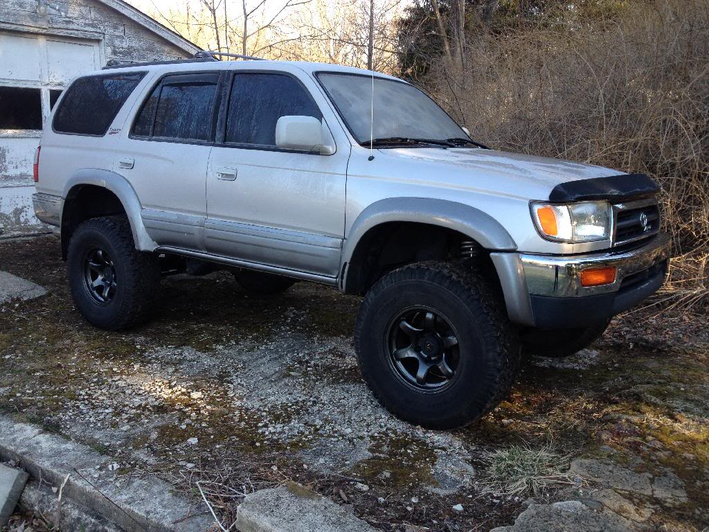

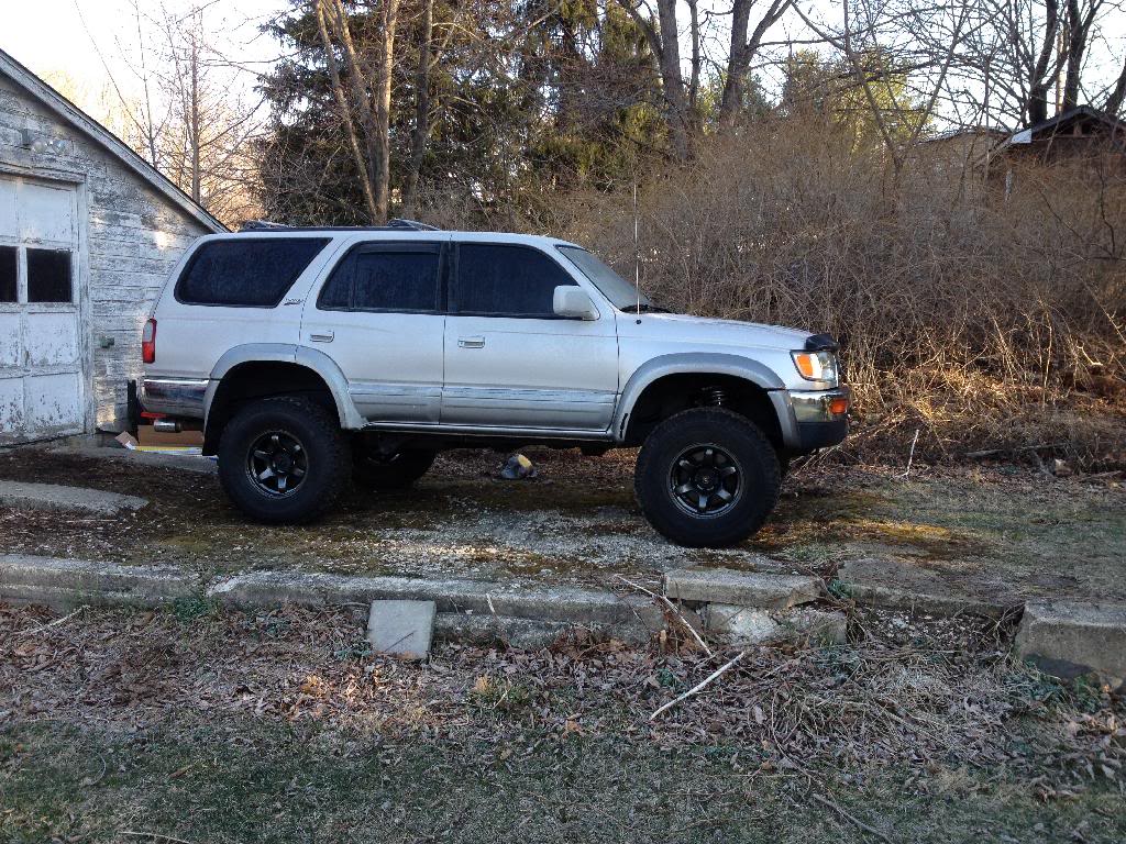

All done

All done!

Originally Posted by habanero
Unpossible!
(looks good)
Well I should have said, the lift is done!
And thanks!!
