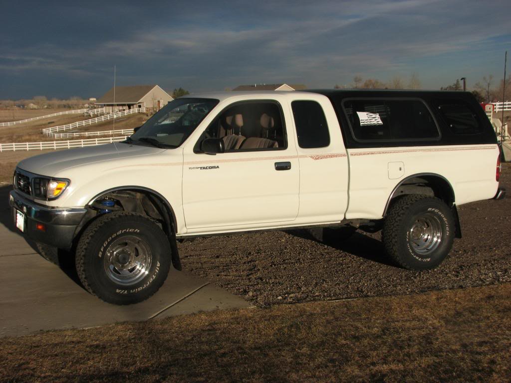

Here's the truck as I bought it, 98K at the time (2010)

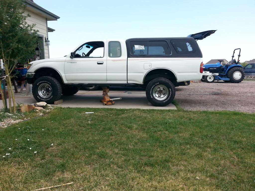

After leveling the rear out and adding longer shackles (net of about an inch lift) Also put on adjustable procomp CO's

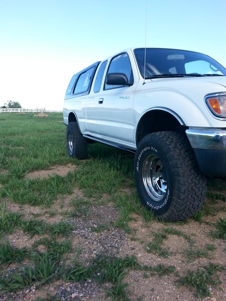

Here's where I'd like it to sit in about a month. Alcan leaves on order, going for about 2 inches of lift plus a little from the longer Toytec shackles already on her.

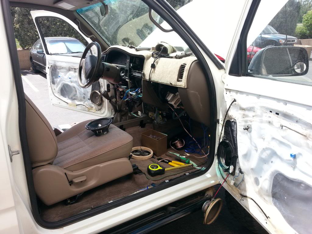

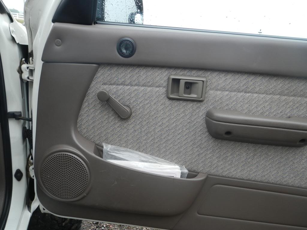

Focal Speaker install. Forgot to take pics but the amps for the speaks and the subs are tucked under the front seats.

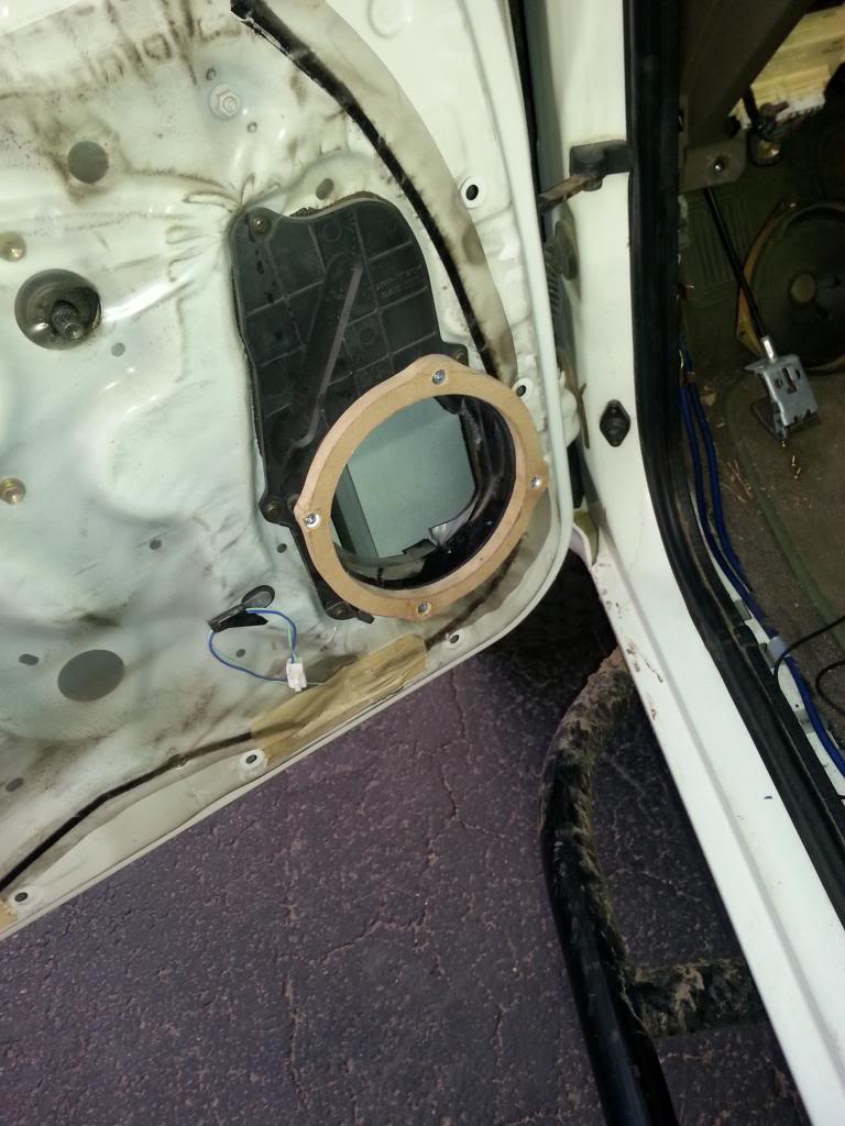

Spacers to move the speakers out slightly (deeper than factory ones)

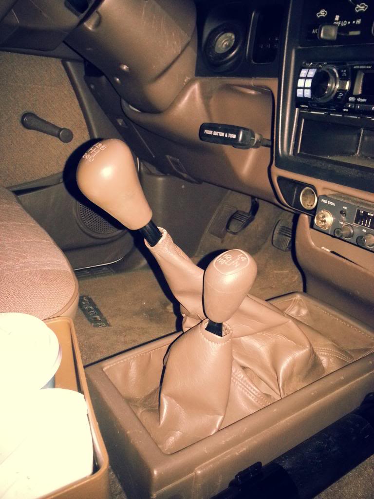

Finished thing. Looks factory other than the tweeters in the door panel

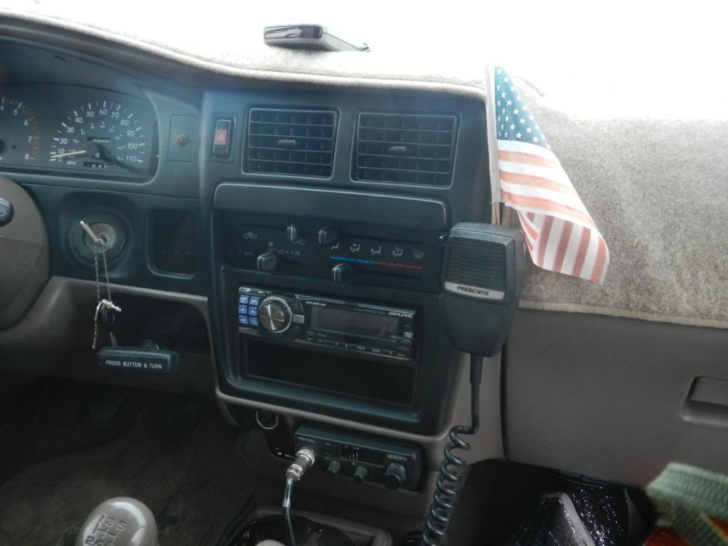

Alpine Stereo and CB install

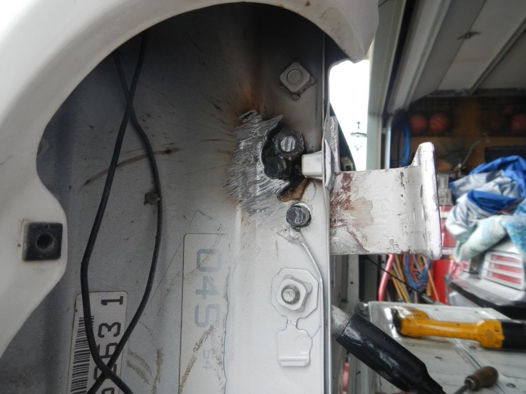

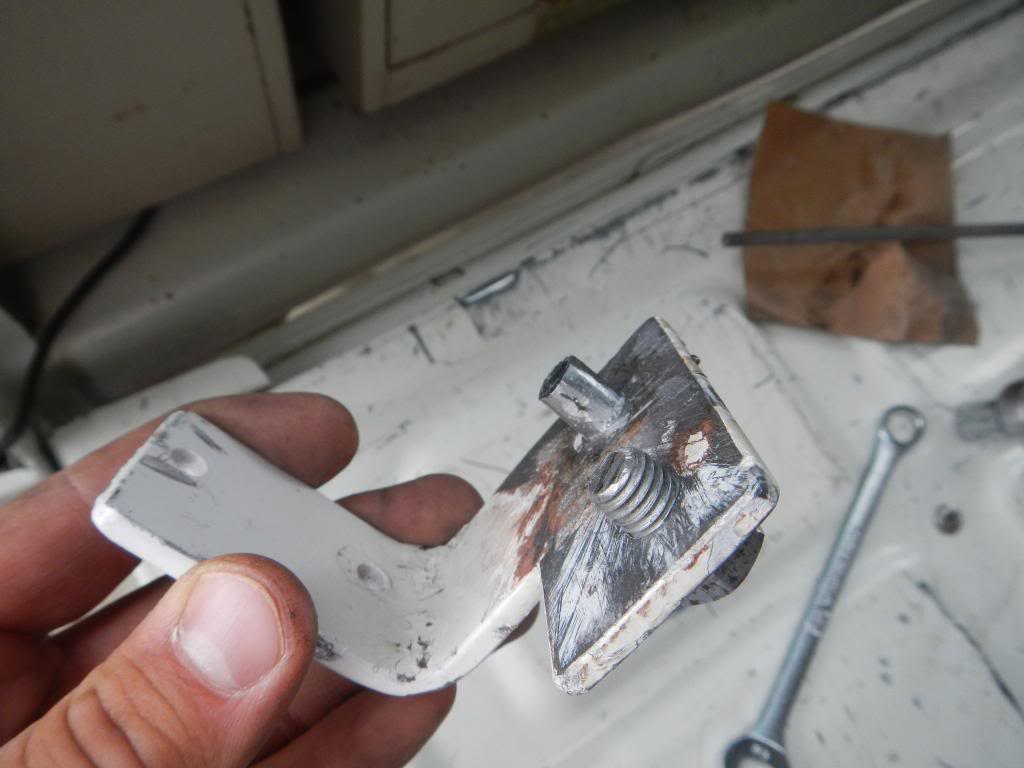

New CB antenna mount. Redesigned it a bit so it could be taken off without taking the tail light out. I keep stripping the chinsy screws in the tail light everytime I mess with it, change a bulb, etc.

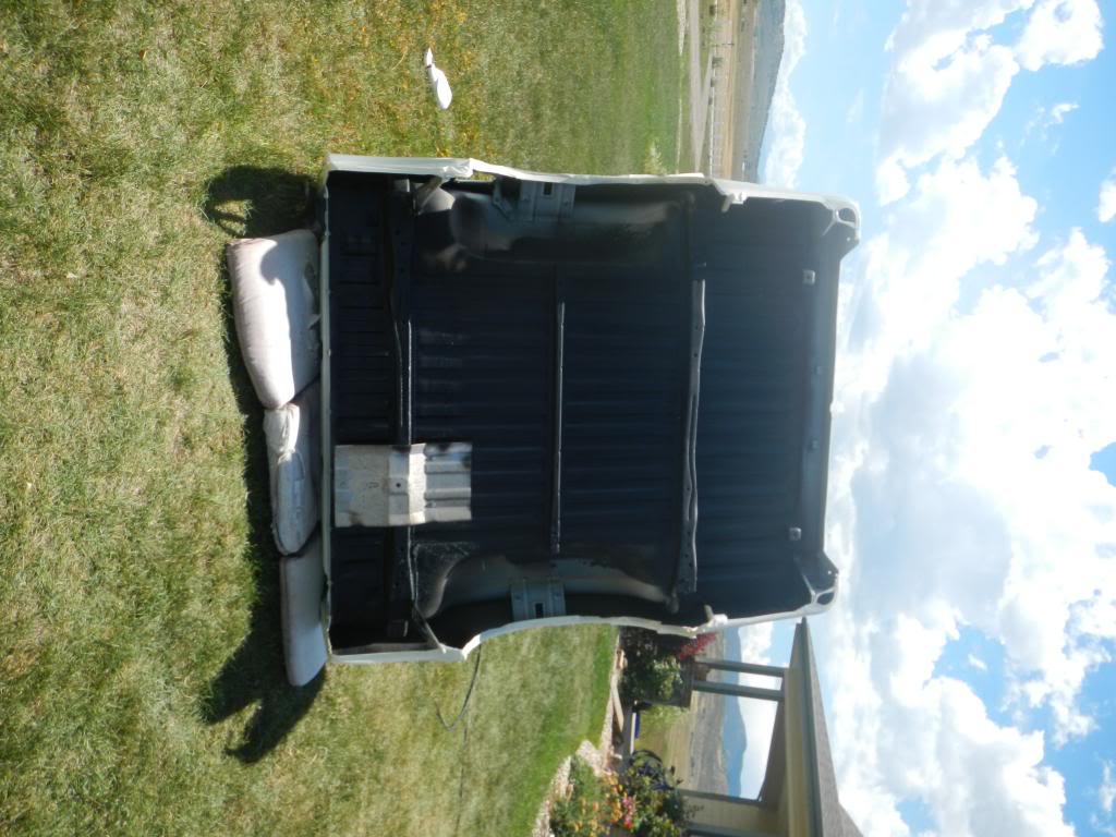

Stripped the topper and bed off

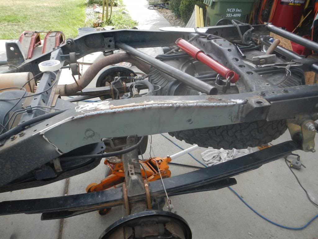

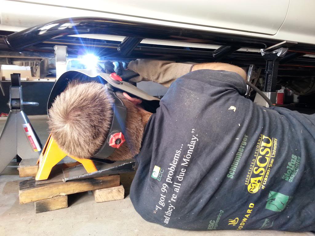

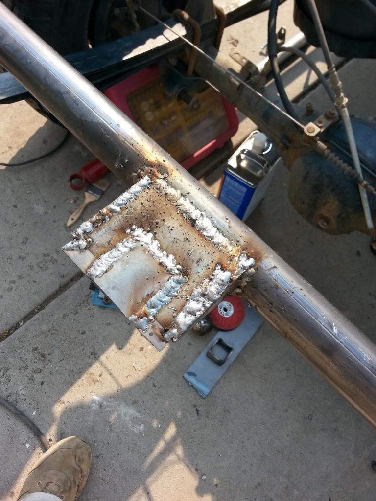

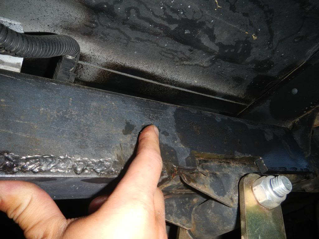

Welded reinforcement plates to sturdy up the frame at the notorious bend.

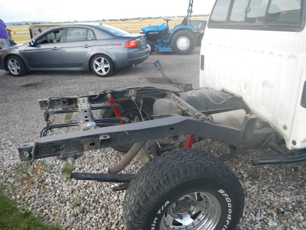

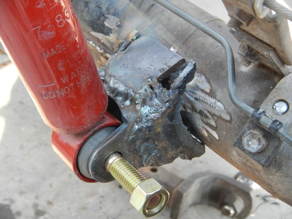

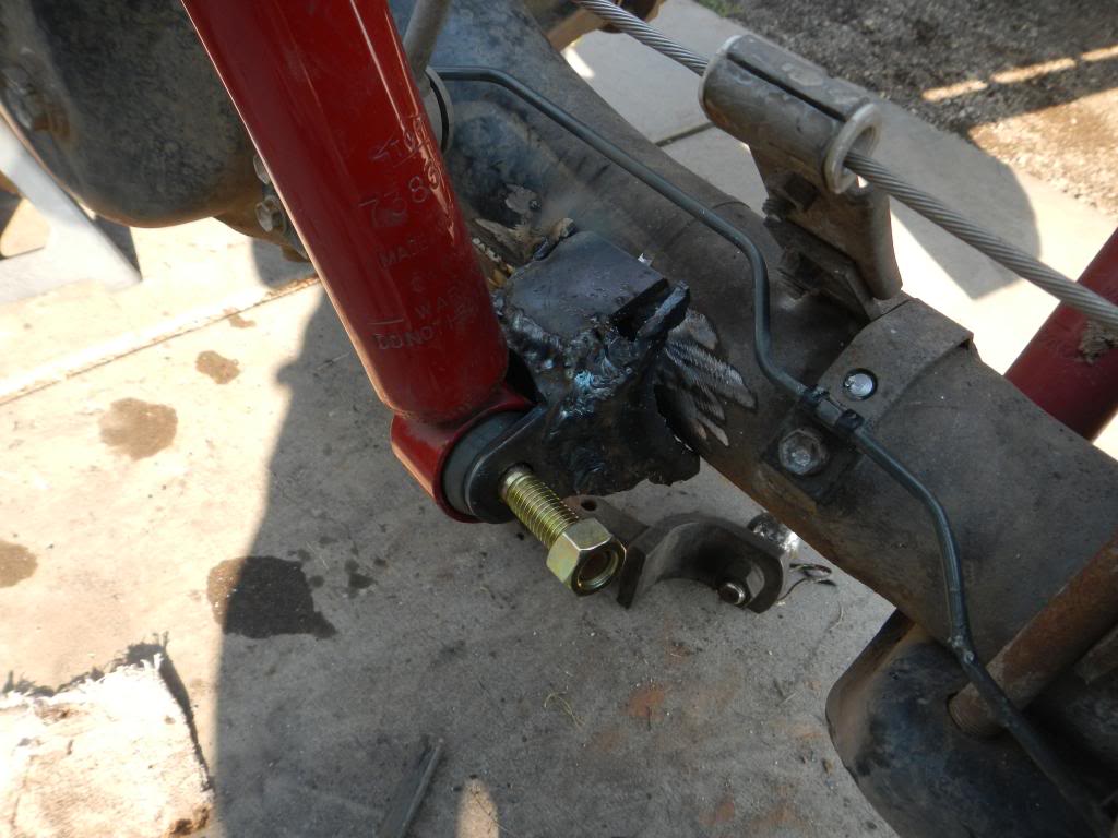

Remounted lower shock mounts in preparation for U-bolt flip. Little ghetto but it'll hold (obviously the picture is pre-weld.)

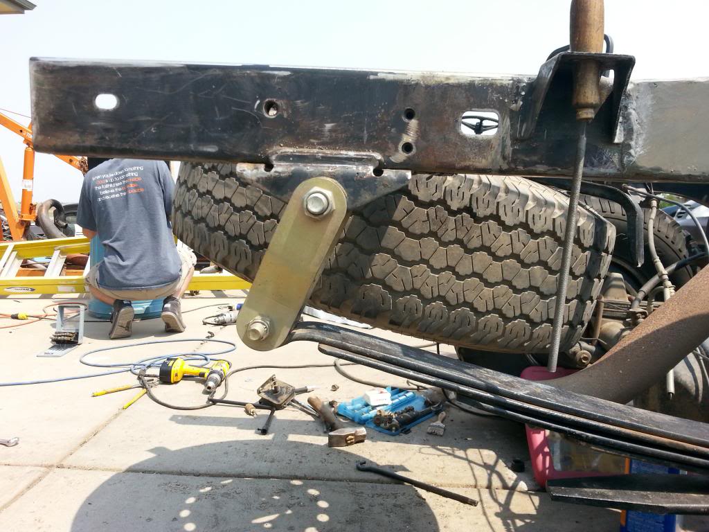

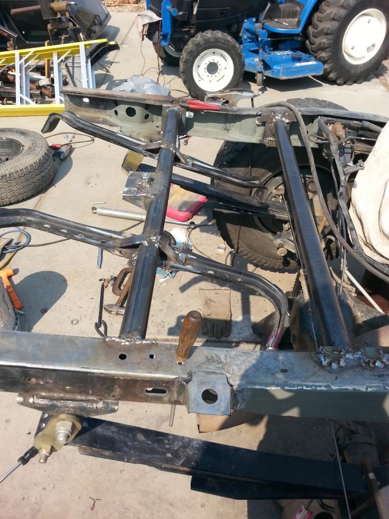

Re-do crossmember/ spare carrier in prep for new crossmember (for upper shock mounts)
Clocked spare for better descent angle (at least in my head)
Start of new spare mounting

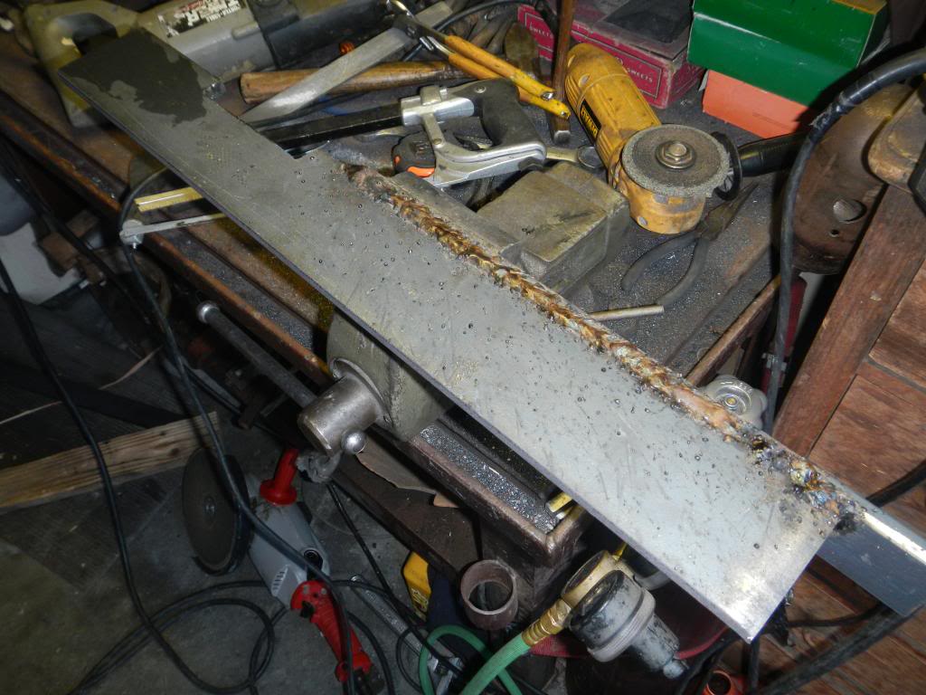

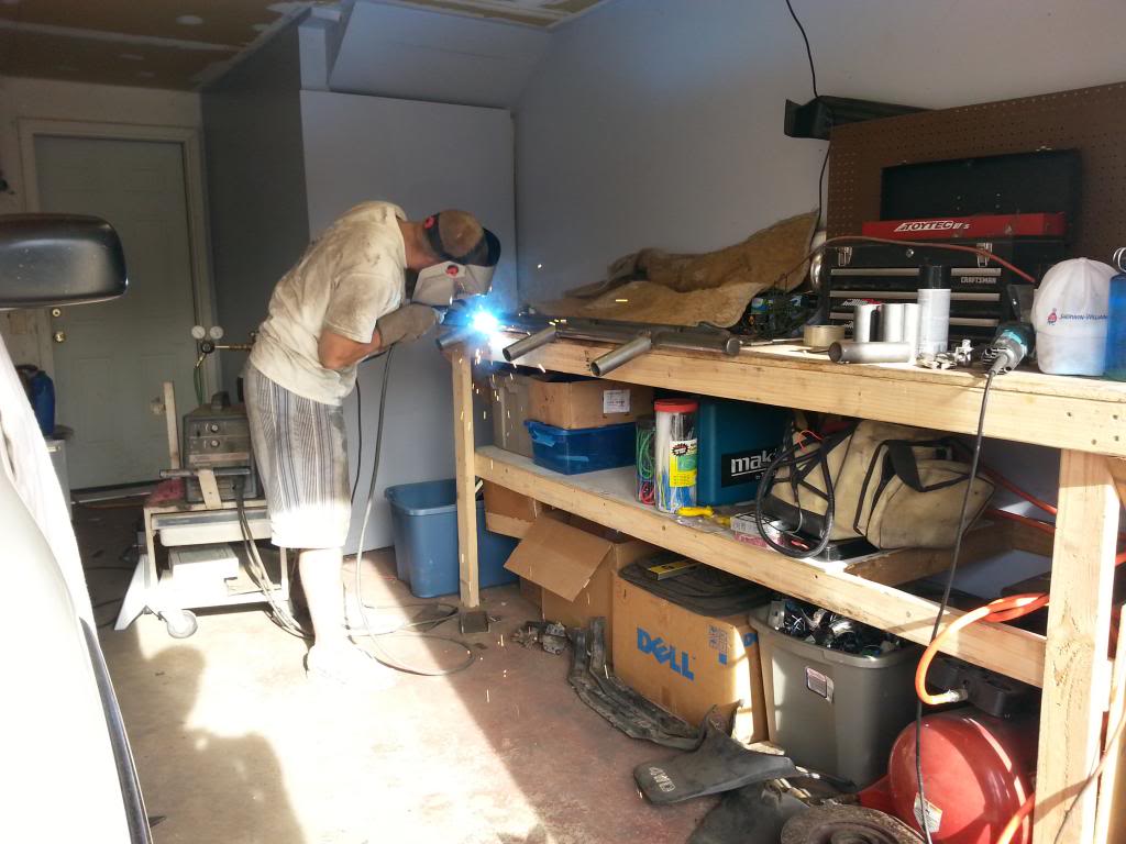

Little further on bumper (rest will have to wait until winter break when I have a welder again)

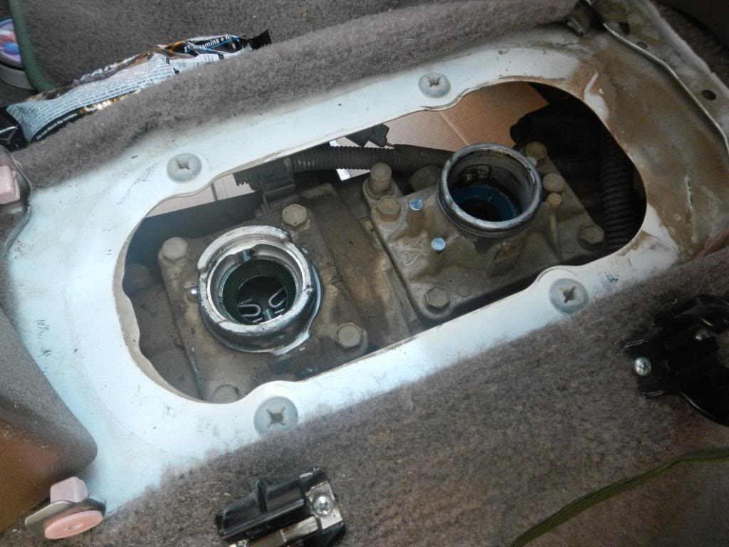

Beginning of Tranny pull project (Throwout/ Release bearing going bad, putting in new clutch/ pressure plate/ pilot bearing and having fly wheel honed while I'm at it. I'm not pulling that sucker again in 20K

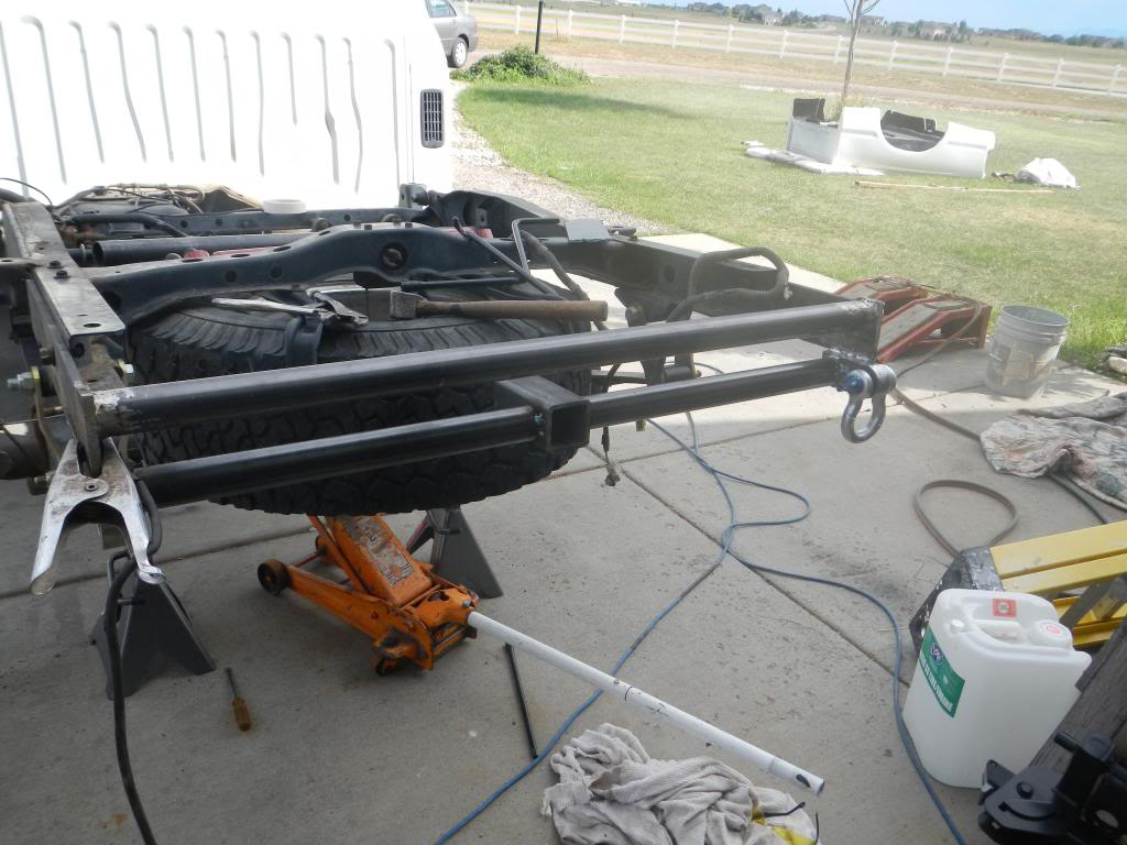

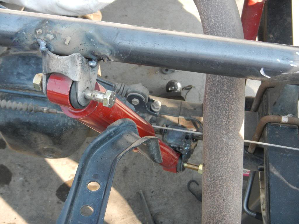

Just tacked in place in this picture but gives you an idea the mounting angle and such.

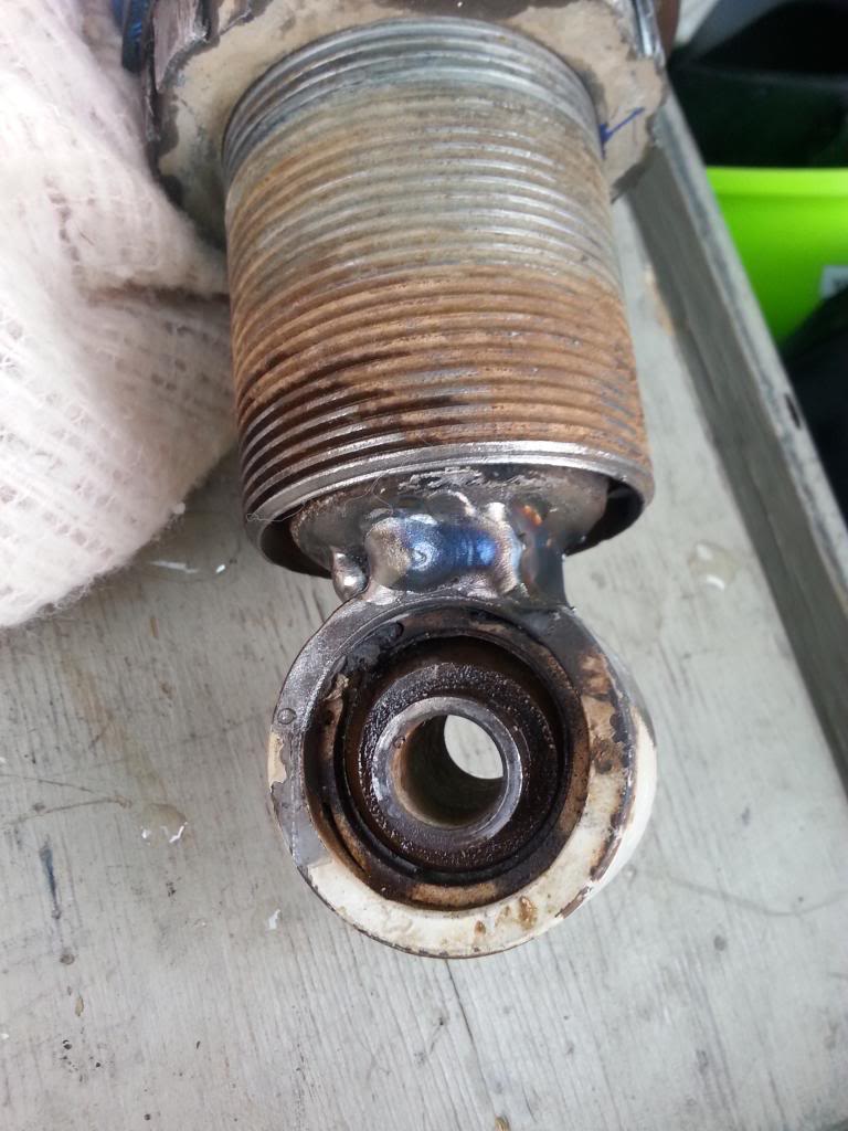

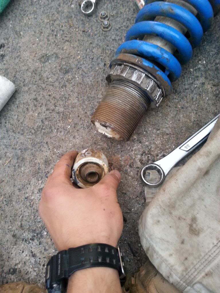

Busted Coilover. Stuck and monkey wrench and about a four foot pipe on that ring to lift the front and busted the eyelet clean off.

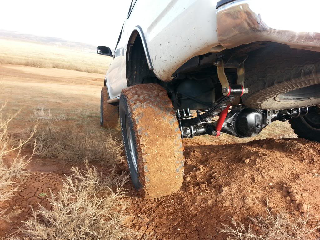

Painted axle. Still only running one shock at the moment.
