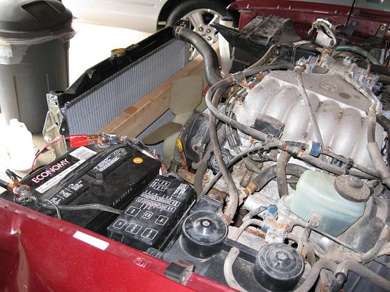

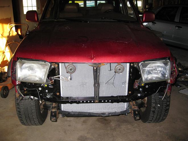

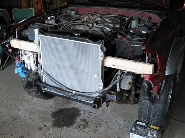

Pics of the jerry rigged radiator support.

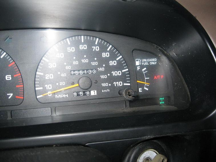

Quick cluster shot.

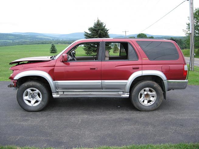

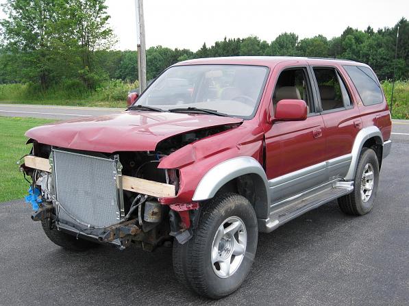

Got it out and drove it around the yard.

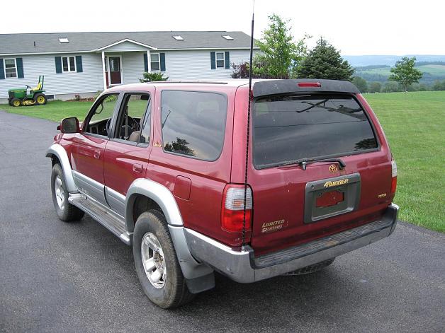

Back shot.

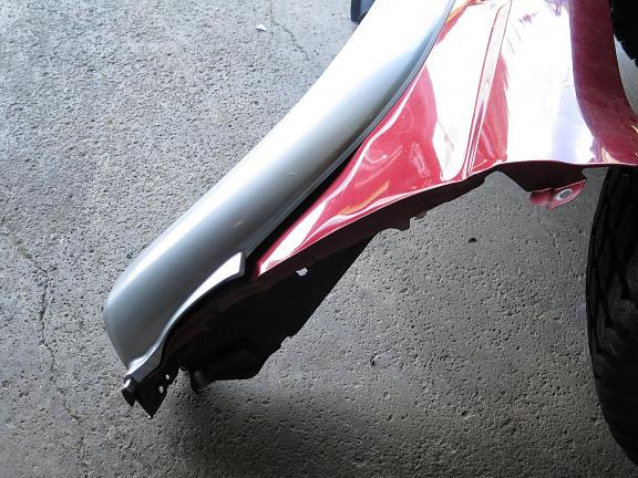

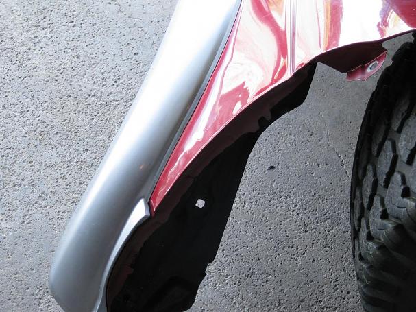

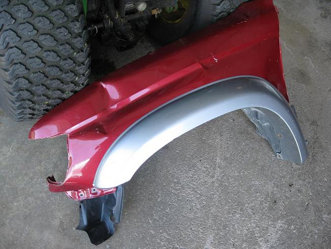

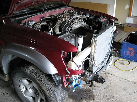

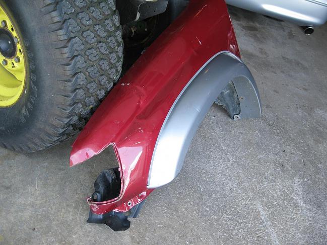

Ok,
Next step. Got the passenger side fender off. Snapped all the bolts that hold it on down low, so now it’s a sloppy fit. This bolt snapping thing is getting old real fast…. And of course I cant get a drill in there because of the factory running boards. The door still hits the fender with it popped out, so I am going to have to adjust it a little so you can open the door and it doesn’t come back to bite you.

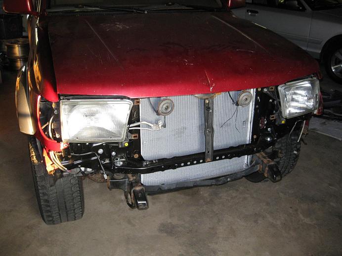

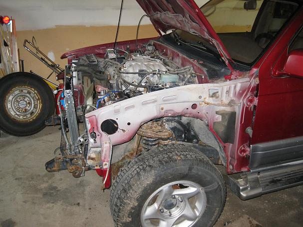

Little body work...

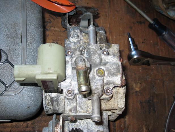

Got a bit further on the 4runner last weekend. Started a new high idle thread in the tech section after cleaning the throttle body out. The throttle had some carbon and sludge buildup that must have hardened over the 6 years of sitting. Ran into an issue in removing the IAC, that’s so dumb that they used Phillips screws, nice and easy to round off. I got two out with an impact and stripped the others. Luckily got them out with vise grip needle nose pliers. I am going to the hardware store today to get some hex head cap screws to replace the Phillips. The IAC was a little gunked up too inside. So I will also get some more brake kleen today so I can clean that part out. I will put it back together and try it again tonight. I bought the gasket at a local advance auto for 2 bucks. Hopefully its good and just needs a cleaning. I also replaced the CTS, but that didn’t help. Also got the front radiator core support on, the drivers side fender is a little bent so it doesn’t quite line up, for now it will have to work. So, I am down to needing: fan shroud, parking lights, turn signal lights, bumper, brake line, tires mounted and balanced and the idle issue figured out. OH, and most importantly a title still……… Pictures to come later, forgot my camera at home today....

Got the high idle fixed! Needed a good IAC cleaning. Now i need to fix the brake line, get a bumper, and figure out a rim choice. Forgot the camera once again.... Bought a lh [parking light on the bay for 5.00 bucks last night plus 5.50 s&h. IM going to make the rh light work with a broken pin for now.

Front end coming together., new IAC bolts (stupid phillips stripped out...
