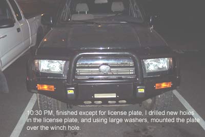

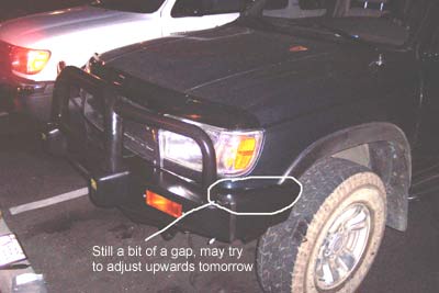

Okay, so I finally put my bumper on last night, took about 4 hours, finished by flashlight at about 10:30 with wiring and putting the license plate on. For the most part, a pretty easy install. I had to adjust the brackets with a mallet to get the bumper to slide in, and it seems to be sitting a little low, based on the gap between the fender and bumper, so I may loosen things up and try to adjust it a bit higher. I didn't like the little blue thingies for splicing the turn signal lights, so I just spliced with a wire nut and taped things up good, will go back and heat shrink them at some later date. For the license plate, I had to drill new holes in the plate, then mounted with large washers in the pre-existing holes for the winch, covered up the gap nicely.
Anyways on to the pics:

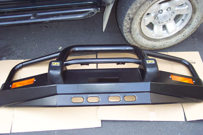

old bumper
The old bumper:

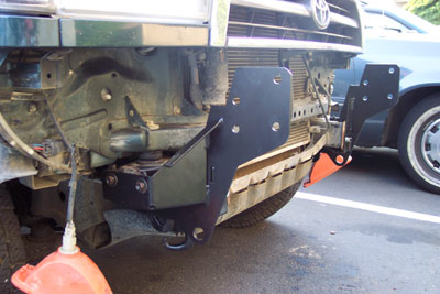

Brackets again from side:
Attached Thumbnails Yet another T-15, with many pics!-sideviewbracketweb.jpg

Prepping the vehicle:

Finished (10:30 PM)!

From the side:

I'll be installing a T-17 very shortly. My problem is that I slid down on a rock a few years ago and bent the tow hook and tweeked the frame where the hook was mounted. Consequently, my stock bumper doesn't quite fit right (nothing wrong with bumper, just the mounts). Do you have more close-up pictures of the brackets on the frame rails? I noticed you removed the tow hook. Does the TJM bracket use those holes for the mounts?

Haveblue: The TJM does use the pre-existing holes on the frame rails for the bumper. After putting the brackets on, you re-install the tow hooks in the same spot, same hole. Once the brackets were on, I need to tweak them out a little to get the bumper on, and I would assume you could do the same if the bumper sat weird due to your previous damage. I've attached another picture of the brackets pointing out the four bolts that are used, its a cropped version of the other pic- let me know and I can go out a take a better picture if necessary.
turboale: No, I don't have a body lift, but didn't make an effort to "lift" up on the bumper to make sure it ended up as close a possible to the body, but there is about a 1/2" gap at the moment that I'd like to try to minimize.
