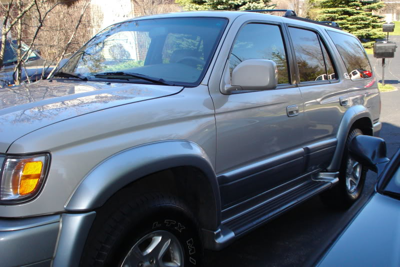

I've searched around a bit- unfortunately, the terms rust, repair, estimate, and cost are all ridiculously common. Adding windshield to the search pretty much just gives me a bunch of threads where people (like me) bitch about A-pillar and windshield corner rust. What I'm after is other people's experiences in having this type of thing repaired- cost, estimates & actuals, timeline, etc.
Here's what I'm working with. You can see it starting at the base of the driver's side pillar and at the top corner, if you look real hard. cruddy pic I know, but I'm at work right now. The pic is from around Easter, so it's grown a touch since then. From what I understand, if it's bubbling out from the corners, the channel is probably trashed under the seal.

I know on a lot of the older trucks, some of the guys have just cut/swapped out A-pillars at home- I lack the three Ts of talent, tools, and time to accomplish this. However, it was the one apparent flaw on the vehicle when I purchased it, and went into it knowing that the money I was saving off bluebook price would be reverted into fixing this particular problem. I am prepared to drop some cash on this fix, and I'd like to get a baseline for when I start shopping the body shops.

Donde esta the rust?

any pictures of the rust your talkin about. seems like your spending alot. i paid less for my supercharged 96 4runner then u paid for a lil body work lol
Don't think I have any specific pics, unless I managed to catch it in the background of a shot. It was all four corners and top center, bubbled up enough to break the paint apart and start flaking the metal. They're cutting that all out, sand blasting everything and fabricating new pillars. No duraglas junk. I wouldn't really call it "a little body work", though... not like we're buffing out a dent here.
