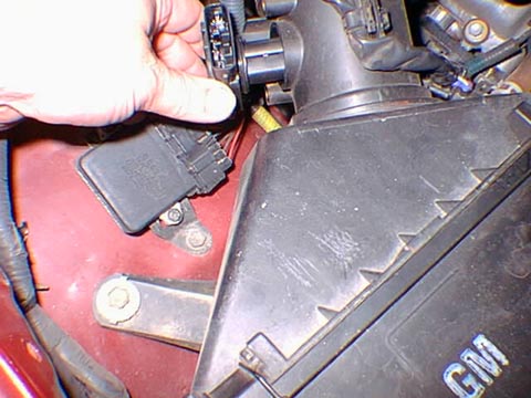

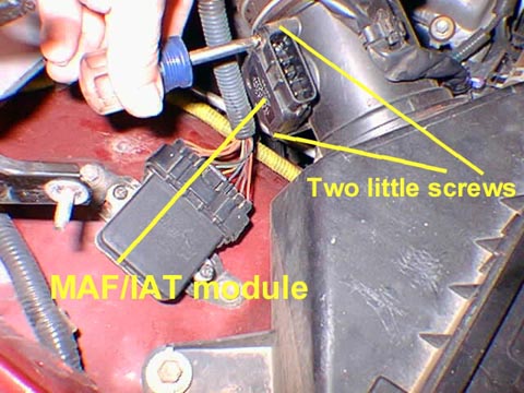

The MAF/IAT module is located just downstream of the air filter. Two phillips screws hold the module in place. You may need to move the cruise control servo box to get at the MAF/IAT.

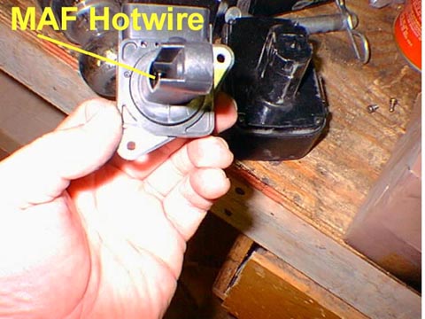

Once removed, clean by spraying contact cleaner on the IAT sensor (obvious little bulb thingy) and down into the MAF airflow tube. Looking into the downstream side of the MAF tube, you can see two wires which make up the hotwire MAF. The contact cleaner I used has silicone lube as part of the mix, so to get rid of that, just swish it around in dish soap and warm water, or use a toothbrush to get the gunk off. Don't be afraid of getting it wet, they are sealed.

Thanks for posting those pics....this should help those with the 99 - 02 type!
Here they are so you don't need to view the attachments:
Location of your MAF sensor:
Removal of the sensor:
Sensor out:
Sensor parts:
Hotwire location:
