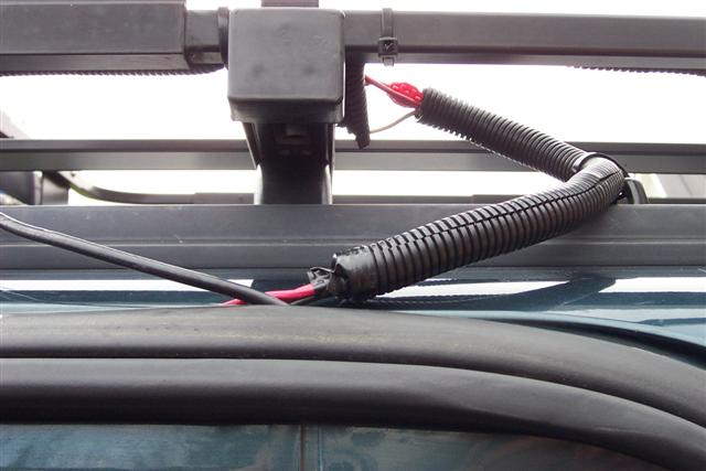

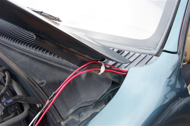

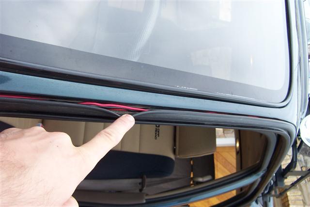

this is how i ran my wires. Tuck it behind the door seal, and then just run it up and back to the lights.

behind the seal

to the rack

Thanks RunnerBoy97, I will have to duble check it cause I have a second gen but that is the best method I have seen yet. The thought of using a hole saw on my roof almost makes me blackout.

Just watch where the cables enter the under hood area. Notice they are zip tied above the hinge, that way they cant be pinched by the plate on the hinge. Oh and i had to loosen the bolts holding the fender on so i could slip the wires behind it.
