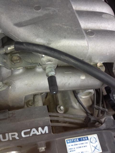

Im new here, and was hoping to find some help. I just bought this truck. The engine originally had a Super Charger on top of it, so there may have been some modifications done. I'm trying to figure out where these vacuum lines originally lead.
I'm curious about his one here coming out of the Intake Plenum thats being plugged with a bolt...

And this one here coming out of the front of the Intake Plenum.
If anyone could shed any light on where these lines originally lead it would be greatly appreciated!! If anyone would like to see any of the rest of the truck just let me know. Its a '92 4Runner body, 5 speed with dual cases and solid front axle from Mini truck.

The first one is a vent/purge line for the 3.4L EVAP charcoal canister, which your swap probably doesn't have. The second one is for the power steering idle up valve, which was likely discarded in the swap too (there should be another blocked off port on the intake between the MAF and throttle body that was also connected to the idle up valve).

Nice, thanks for the info. Im throwing a code for O2 sensor and running lean, so I was just trying to make sure these blocked off lines werent contributing to the problem...
